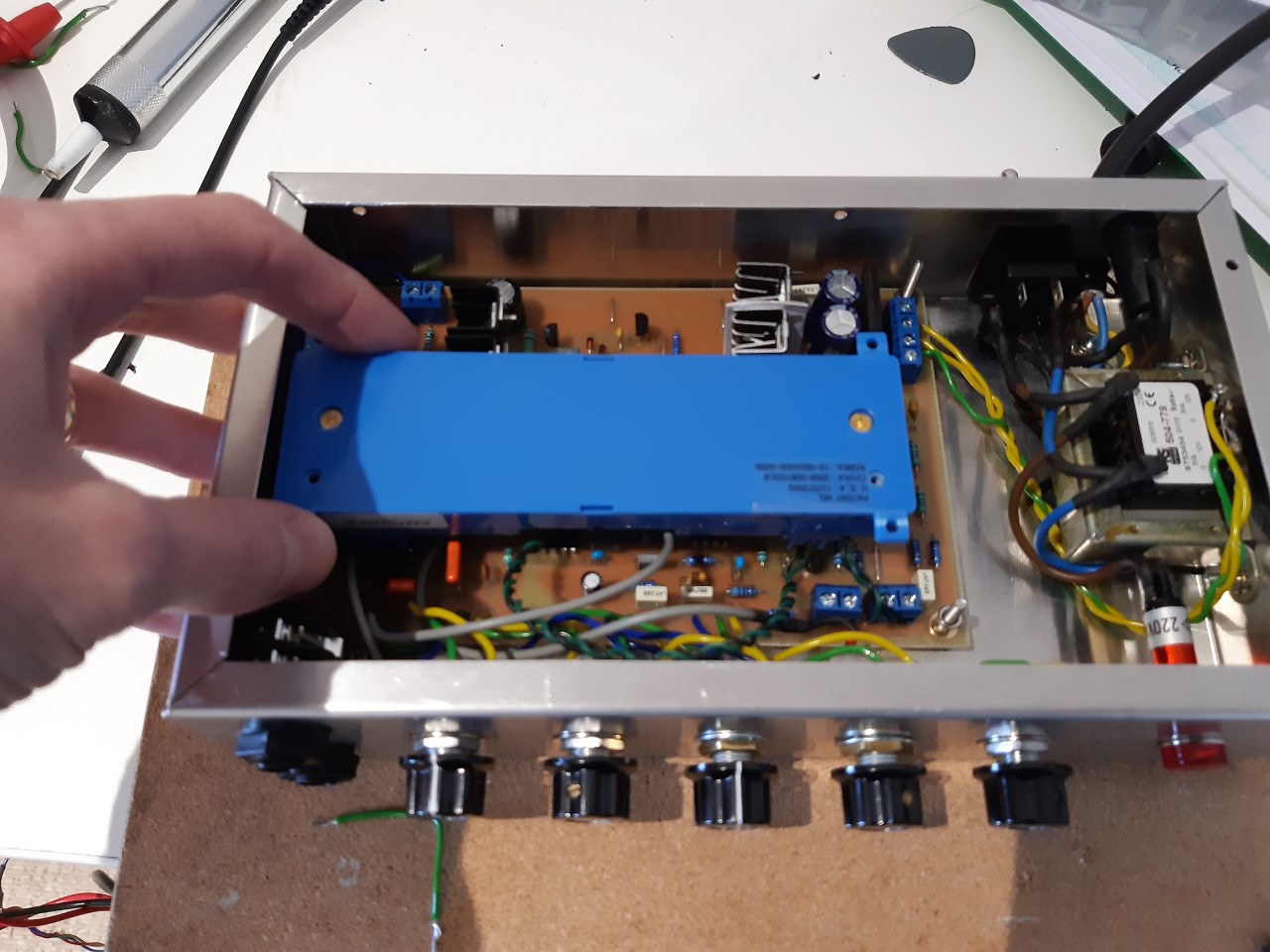

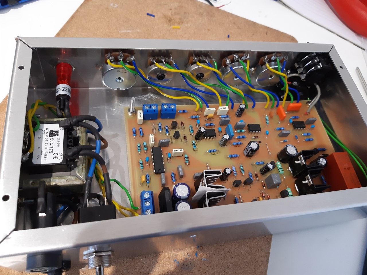

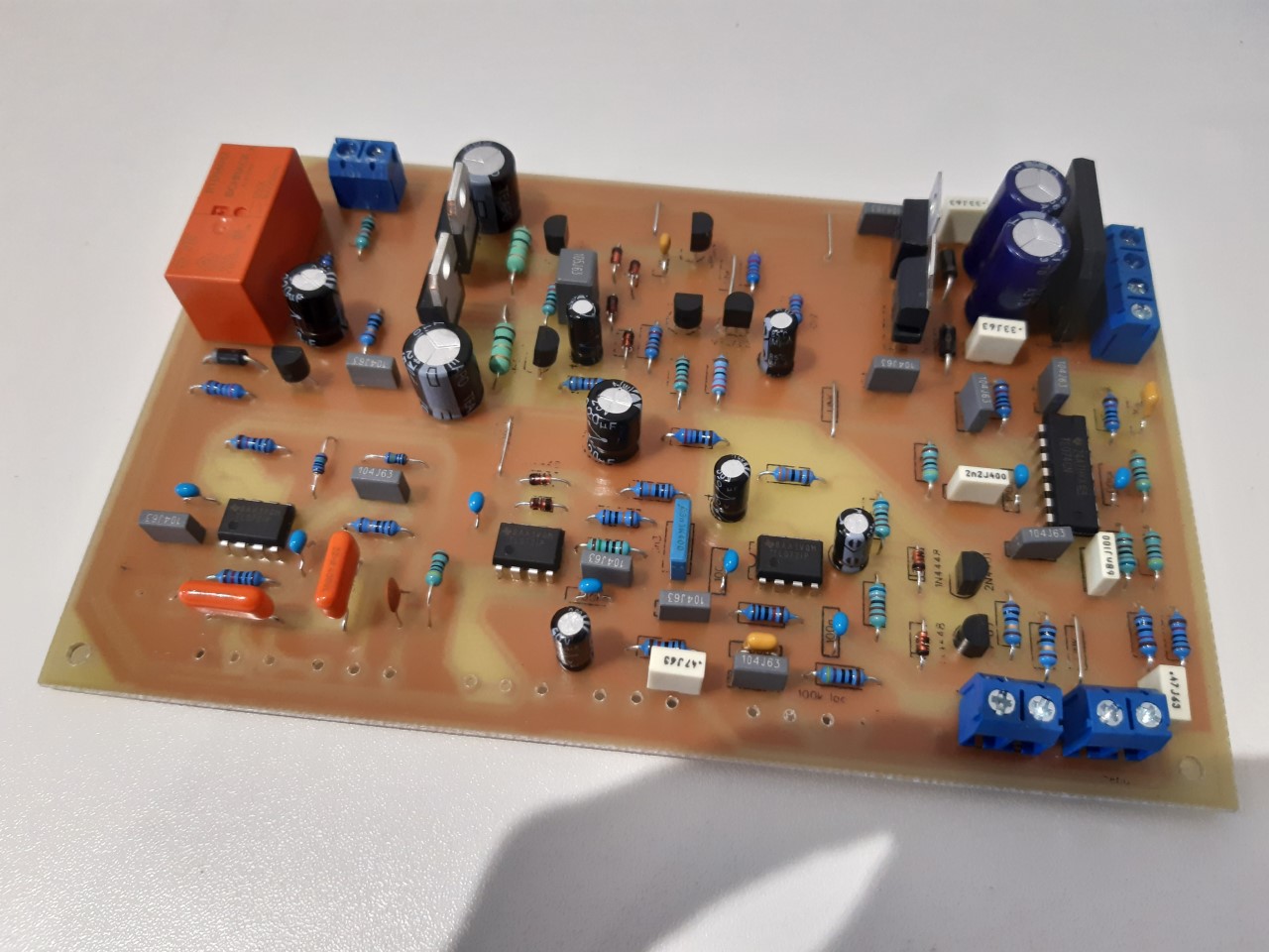

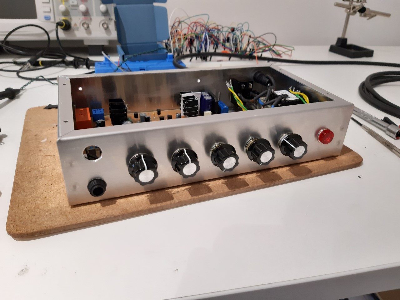

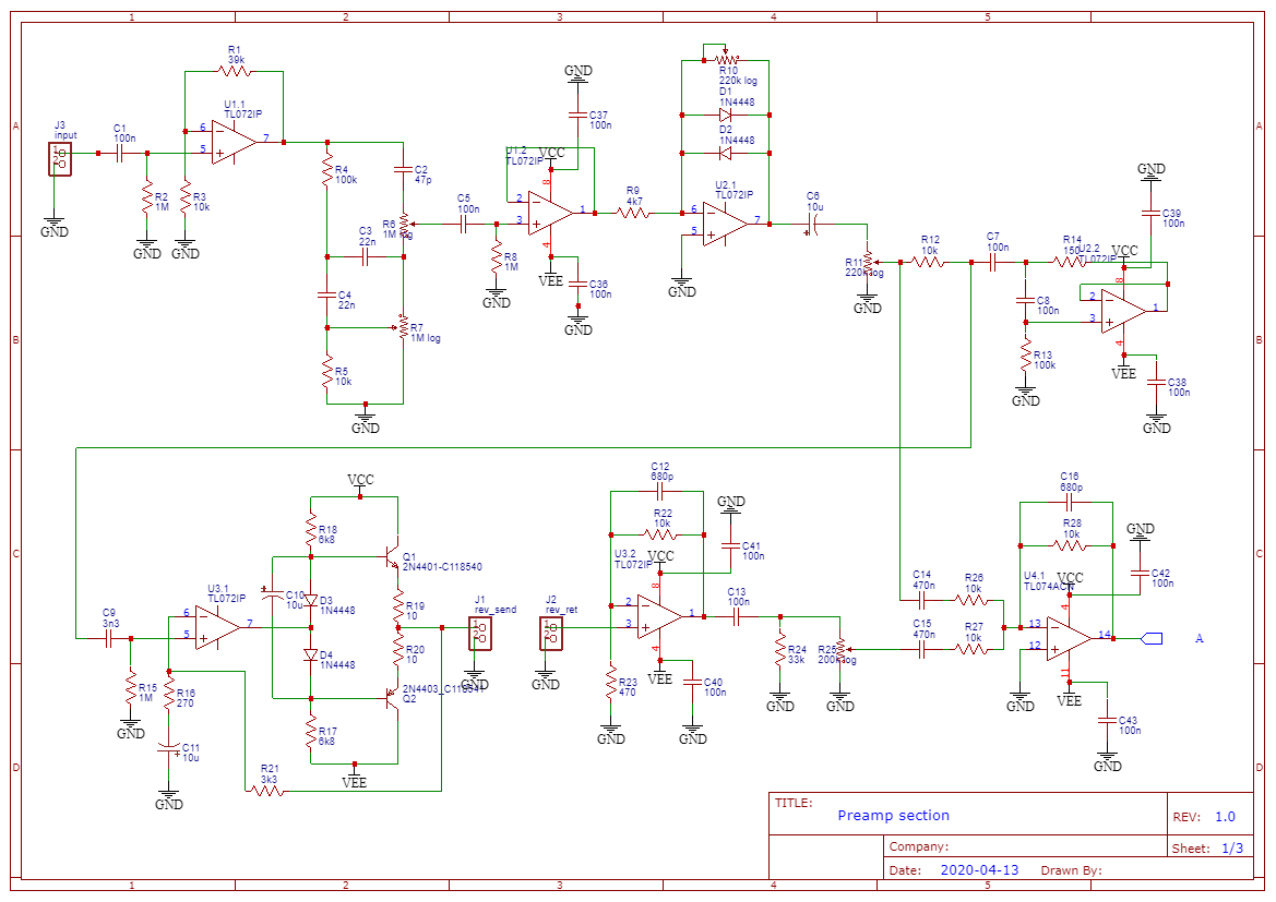

I've been working on building a headphone guitar amp and wanted to share my progress as well as a few problems I'm having.
The design is pretty straightforward with pre-overdrive EQ (AC30 tone stack), diode clipping overdrive and spring reverb. It also includes a speaker simulator that I got from this website:
Celestion G12H Speaker Sim - Distorque

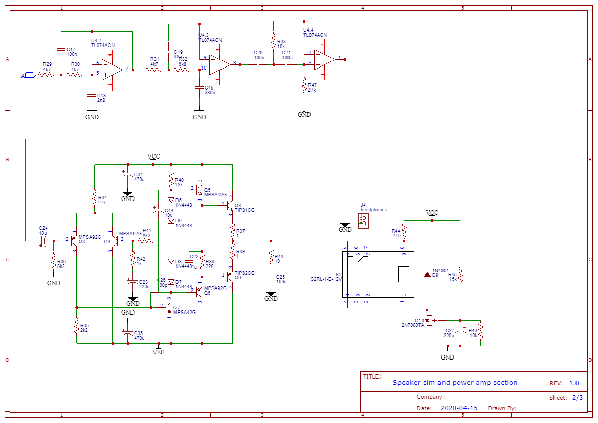

The power amp is a basic discrete design using TIP31C/TIP32C output transistors and simple diode biasing. The preamp uses TL072 dual op-amps throughout and uses an op-amp with a buffered output stage for the reverb driver, based on Rod Elliot's advice. It was originally wired for current drive but I found that I preferred the sound with voltage drive.
The reverb was a pain to get sounding right due to it being such a small tank. it is driven relatively high to reduce the makeup gain required. I found that there was a very strong resonance at 400Hz, hence the notch filter before the driver circuit.
There is a switch on-delay circuit using a relay and MOSFET but no DC protection. Strangely (perhaps) it sounds best with very cheap headphones so I'm not too bothered about the small possibility of damaging them.
It's working okay in general but I do have a few problems that need sorting.
Firstly, the volume control is not very good. It remains too quiet for most of its travel and then dramatically increases in volume right near the maximum. There is only a small amount of useful range. I wondered if changing the value would help as, when it was on the breadboard, I was using a 100k linear pot. It is now 220k log. I also wondered about adding a treble bleed resistor between the input and the wiper.
The second, and probably most major, problem is the hum induced in the reverb tank. My plan was to mount the tank to the lid of the enclosure with the pickup end furthest from the transformer. However, in this position there is an unacceptable level of hum. Rotating the tank on its axis reduces the hum considerably but it is then not possible to secure it to the lid, or even fit the lid on top. I also considered adding a high pass filter to the tank output to reduce the 100Hz component.
Finally, there is a reasonable level of hiss on the output. It's not excessive but it's enough to be annoying. I wondered if reducing the power amp gain and increasing the gain at the summing amp stage might help.
If anyone has any suggestions then that would be fantastic! I've included pictures of the amp and also the schematic.
Thanks in advance!
James

I have just done a quick scan of your schematic. You can probably reduce the hiss quite a bit by reducing the 1MEG input resistors on the TL072 amplifier stages and using larger coupling capacitors. I expect that you are hearing a fair amount of Johnson noise.
Re the volume control: the wiper is actually seeing a fairly low input resistance on the gyrator stage. This will affect the overall transfer function of the potentiometer in the way that you describe. You should either raise the input resistance or decrease the pot value.
Unfortunately, electric guitar pickups need a minimum 1 meg input impedance from the amplifier, so reducing this resistor is a bad idea.
However, using a larger input coupling capacitor, or even eliminating it altogether (if your guitar provides an internal path to ground through its volume control, as most do), is still a good move. When the guitar is plugged in, its internal impedance shunts that 1M input resistor, and so reduces thermal noise.
The one at the input is "bypassed" by the guitar, so the 1Meg is a very 2nd-order hiss; and likewise downstream due to 1st stage voltage gain.
I agree that a full re-think might chew 1db or 2dB of hiss out, but it shouldn't stink.

Thanks for the suggestions. I've had a play around with it and made a few adjustments. I tested the noise with the power amp input grounded and it disappeared entirely so it's definitely all preamp noise. Grounding the input to the speaker simulator stage made little difference so I suspect that most of the noise is coming from this stage. Bringing up the volume control does introduce a bit more, slightly lower pitched, hiss which I imagine is the Johnson noise that's been mentioned so I'll look into that.
I have swapped the 1k resistor in the power amp feedback loop with a 2k2 and replaced the 1k feedback resistor in the summing stage with a 2k2. This has helped considerably. I don't want to increase the feedback too much on the power amp in case this causes stability issues. Making the resistor swap on the power amp had the added bonus of reducing the DC offset significantly. I'm not entirely sure why though!
I have changed the volume pot from 220k log to 10k log and this has fixed the volume problem entirely. I will do the same for the reverb return level pot as this has the same issue. I realise this will mean adjusting the high pass filter on the recovery amp's output.
In terms of the reverb, there seems to be very little information available on the tank except from input and output impedances. I can't find a proper datasheet anywhere. There is no continuity between the input and output grounds so both are required to be connected. The tank is made of plastic with no foil shielding or similar. The orientation makes a big difference, with the hum being reduced from unacceptable to almost non existent when the tank is rotated by around 30 degrees. The problem is that it then doesn't fit in the box. The obvious solution would be to keep the tank straight and rotate the transformer but there isn't enough wiggle room for the transformer. It may be possible to rotate both the tank and the transformer in opposite directions to achieve the desired angular difference so I'll look into that.
The reverb was always going to be an issue I think. I know that guitar amps typically have the tank mounted at the base or side of the cabinet, far away from the mains transformer but I do have one amp (HH IC100) and a PA amplifier where the reverb tank is mounted inside the chassis, fairly close to the transformer so I thought it should be manageable.
Anyway, thanks for all your replies so far! They've been very useful.
Thanks,
James

To bring up an entirely different issue: I'm very concerned about the future of your hearing. :(
The nutshell version: a headphone amp that can spit out +/-13 volts is incredibly dangerous to the future of your hearing. :eek:
The details: most of the headphones I've run across will spit out 100 dB SPL (loud enough to damage hearing) at your ear with 1 mW of input power. Thirty-two ohms is a fairly typical contemporary headphone impedance. 85 dB SPL is a widely-used international standard for how much abuse your ears can take for a few hours without permanent damage.
Put those numbers together, and typical headphones only need 50 mV peak (volts) to generate 85 dB, the loudest sound that (may) be safe to listen to for a few hours a day.
Going the other way, your amp is designed with +/- 15 volt rails, and the output can probably swing to about +/- 13 volts, for a maximum output of 26 volts peak to peak. That would drive 2.64 watts into a pair of 32 ohm headphones, and for the few seconds before the headphone voice coils burned out, that would correspond to a nominal SPL of 134 dB at your ears. :eek:
An SPL of 134 dB, according to references I looked up, is loud enough to cause permanent hearing damage virtually instantaneously - in so short a time that medical science can't actually gather statistical data on it. Essentially, listen to a single musical note at 134 dB, and suffer permanent hearing damage for the rest of your life.
It would be dangerous enough if this amp was for listening to CDs - CD players have a very well defined maximum output signal level, so there is a lower chance of a sudden loud sound blowing out your eardrums.
It would be more dangerous listening to digital audio files; my experience is that levels vary widely from one file to the next, so there is a very good chance of a suddenly too-loud MP3 or FLAC file causing hearing damage.
But far more dangerous yet is an electric guitar. Signal levels vary widely, enormous pops and bangs occur if a cable is carelessly plugged in or unplugged, and if you're wearing headphones plugged into this amplifier, a single occurrence of this sort is likely to permanently damage your hearing. :eek:
So I urge you to consider some sort of limiting circuit at the headphone jack, designed to keep SPL at your ears at a low enough level not to instantly cause hearing damage. A series resistor from the amplifier output and a pair of reverse-parallel silicon diodes across the headphone jack isn't a bad idea - 1.2 volts peak to peak will still turn into 107 dB SPL at your ears, which is already loud enough to start causing hearing damage. (But it's much less lethal than 134 dB.)

...Would there be another arrangement that would limit the output even further to avoid the 107dB output level?
Thank you for listening - I do appreciate that. And yes, we can do that! The trick will be to get loud enough for you to feel it was worth the build, but not get so loud as to damage your hearing.
The easy solution is to make a voltage divider - two resistors in series, one connected to the headphone amplifier output, the other to ground. The headphone jack then connects between ground, and the junction of the two resistors. The idea is that the output voltage of the amplifier is divided down by the two resistors, to a level that is safe (or at least relatively safe) for your ears.
Starting off conservatively, we could follow legislation that applies in your part of the world, at least prior to Britain's exit from the EU: since 2013, countries in the European Union have mandated that headphone outputs be limited to 85 dB SPL maximum, to try and prevent a large swath of the population from deafening themselves with their earbuds.
(Since the manufacturer doesn't know what headphones you'll be using, this means a best-guess voltage limit at the headphone jack.)
More here: Fears that music volume limits 'could be ignored' - BBC News

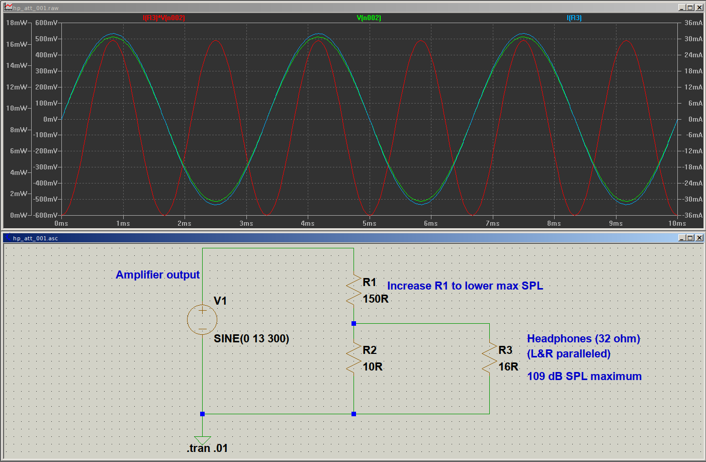

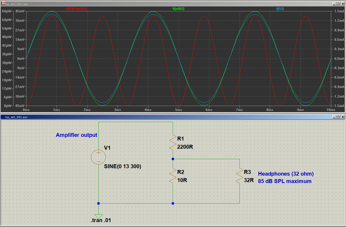

Assuming 32 ohm headphones with a sensitivity of 100 dB SPL@1mW of input power, and that you are connecting the left and right headphones in parallel (so the load seen by the amp is 16 ohms), you can limit maximum SPL to about 85 dB by wiring one end of a 1.8k resistor to your amplifier output, the other end to a 10 ohm resistor, and the far end of the 10 ohm resistor to ground. The junction of the two resistors feeds your headphone jack, i.e., the headphones are wired across the 10 ohm resistor.
I think you will find this too quiet, but if you do, it isn't hard to tweak; the only thing that needs changing is the 1.8k resistor. Reduce it to get more loudness.
If you replace the 1.8k resistor with, say, 150 ohms, you'd get 109 dB SPL at your ears, with no other changes. Very, very loud. Ear-shatteringly loud, but not unheard off with guitar amps - many electric guitarists seem bent on deafening themselves for good. :confused:
In other words, 1.8k will be safe (but might be too quiet for your taste), while 150 ohms will get you to "chainsaw at 1 m distance", according to this table: Table chart sound pressure levels SPL level test normal voice sound levels pressure sound intensity ratio decibel comparison chart conversion of sound pressure to sound intensity noise sound units decibel level comparison of common sounds calculation
Somewhere in between those two limits, there will be a resistor value that makes you reasonably happy.
In situations like this, I suggest trying a set of resistors, each roughly half the resisistance of the previous one. For example, 1.8k, 1k, 470 ohms, 220 ohms. Chances are one of those will satisfy you.
The attached images show you the two extreme cases. I used a voltage source in LTSpice (set to 13 volts peak) to represent your headphone amp at the threshold of clipping. The red curve shows power delivered to the headphones; RMS power is half peak power, so halfway up the red curve.
You can convert from power (in milliwatts) to SPL (in dB) using the formula SPL = 100 + 10*log10(power). Remember that there are two headphones (left and right), and each one needs 1 mW delivered to it to reach 100 dB SPL.
-Gnobuddy

...the possibility for a fault to occur in a HiFi headphone amp is non-zero...
I couldn't agree more!
...400 ohm headphones may be uncommon in home and HiFi use but in studios they are extremely common...
I didn't know that, thanks!
