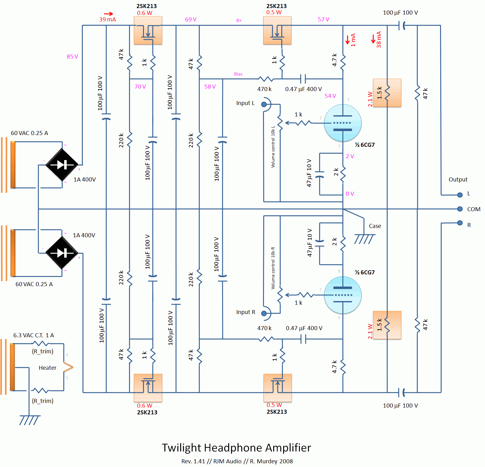

This will be done as a comparison study between the Sapphire and Twilight headphone amplifiers.
Source is my Onkyo SE-200PCI sound card and the headphones were the 300 ohm Sennheiser HD-600.
The Twilight is single-ended, a triode-mosfet hybrid mu-follower with about 38 mA bias. The Sapphire, due to a couple of issues with the prototype build, ended up rather less, at 9 mA output bias. Sapphire is op amp voltage stage plus bipolar emitter follower push-pull current buffer.
The characteristics of each amplifier are pretty much what anyone familiar with the circuits would expect:
Twilight is basically the SET sound: warm, intimate, plummy, a little soft, but with enough grunt supplied by the mosfets to control the HD600s effectively and give good dynamics. The soundstage is narrower and more central than the Sapphire. It tends to shine for small scale vocal and acoustic music, and will paper over less-than-stellar recordings to a considerable extent. On the other hand large scale orchestral and heavy rock and pop can sound blurry and indistinct, falling apart on complex passages.
Sapphire is basically the high end solid-state sound: massive, wraparound soundstage, endless reserves of power, intense, gripping dynamics and realistic, precise transients. Black backgrounds, resolution on demand. The bigger and badder the music, the more it shines. To paint that as a negative, the coolness and precision can make acoustic music seem thin, and it will pull no punches in revealing an awful sounding CD for what it is.
While both have advantages and disadvantages, right now I favor the Sapphire and I think it is overall the better of the two amplifiers. I intended it as a homage of sorts to the big high-end solid-state amps of the 1980's and 1990's, and I got much more of that sitting-in-the-audio-demo-room-listening-to-systems-I-cannot-afford feel in the Sapphire than I ever imagined possible in a headphone/headphone amp combination. It's really that good.

Could you post the Twilight schematic please?
See below.

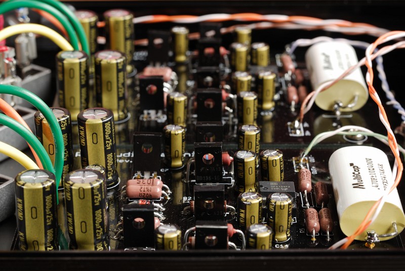

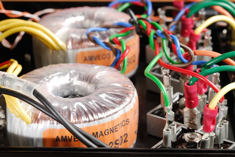

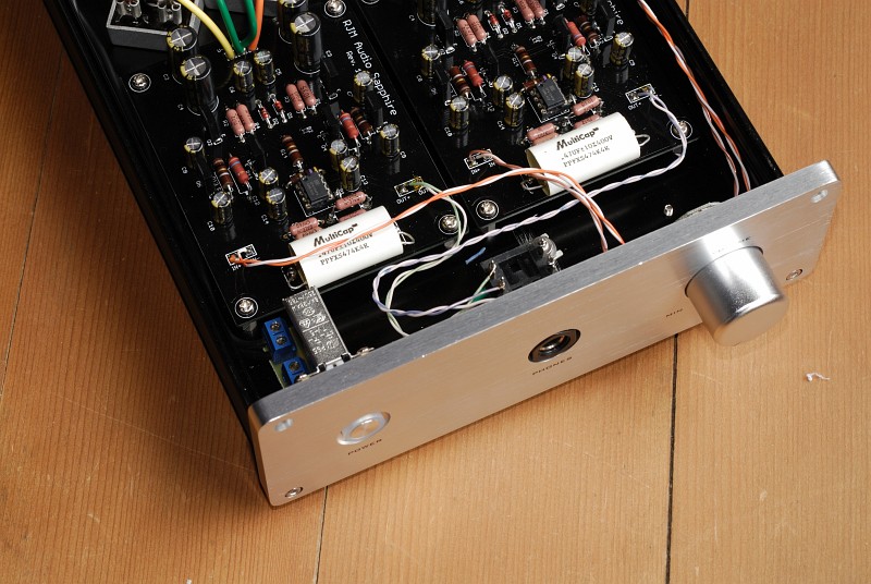

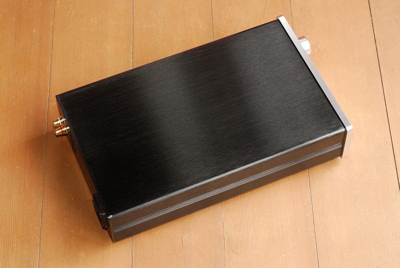

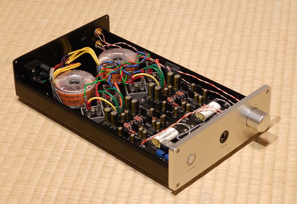

Sapphire Headphone Amplifier Photos

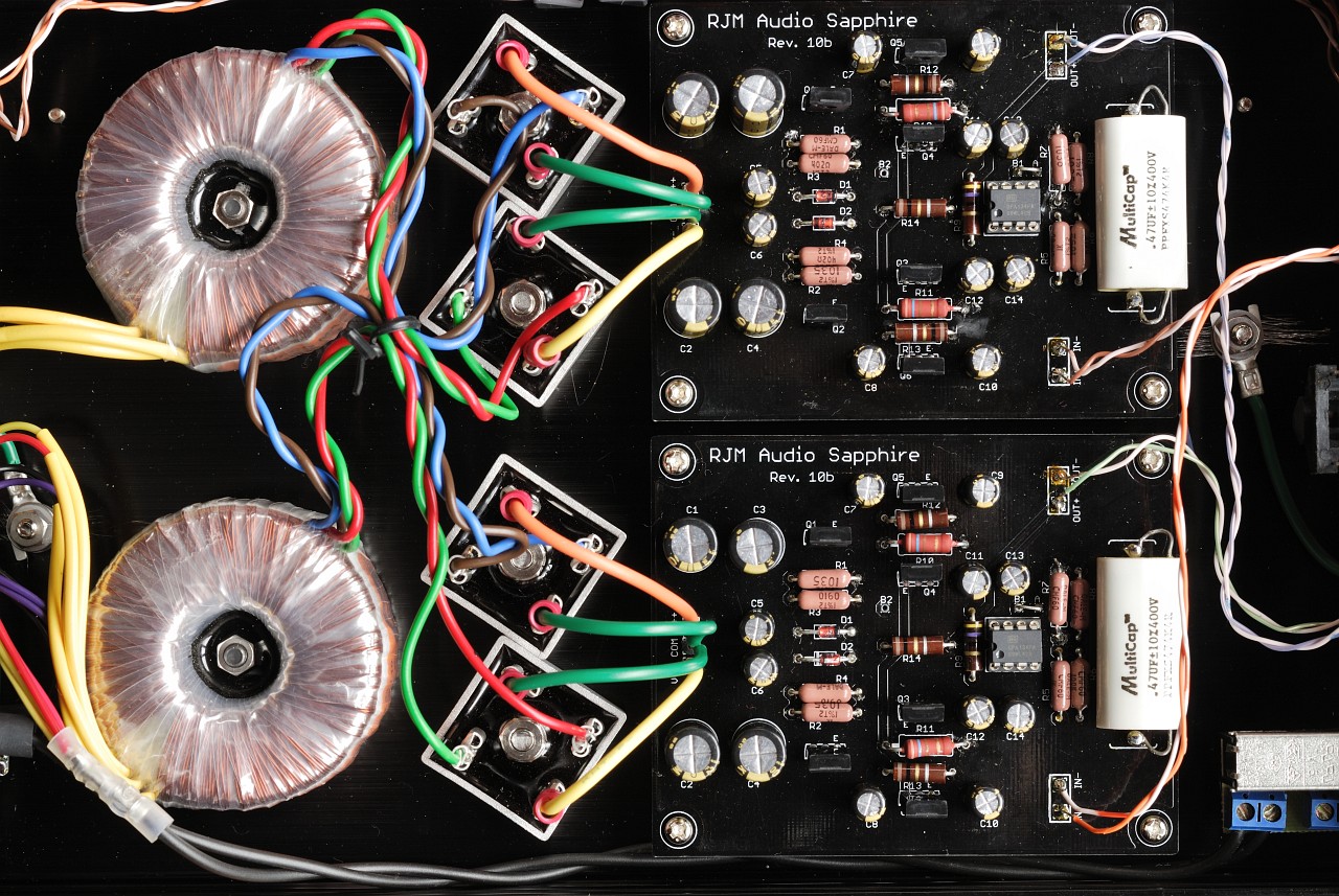

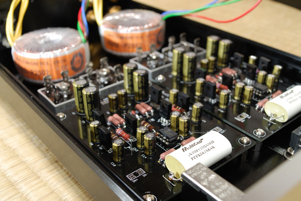

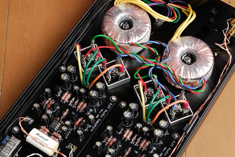

My version revision 10b boards:
hlly case
2x Talema 25VA 12VAC transformers
4x Comchip 50A 1kV bridge rectifiers
20 kohm stepped attenuator (SMT resistors)
(photo notes: Nikon D200, SB-800, micro-Nikkor 55mm F3.5 Ai)

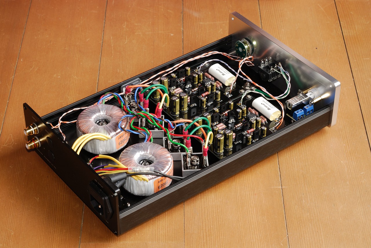

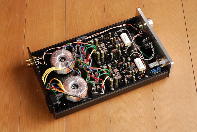

Two more photos, at higher resolution.
Regarding the ground connections, the COM of the two channels joins at the shared return tab of the headphone socket, which also has a short third connection to the case. The IEC power socket earth tab is connected to case with a short wire.
Now I regret what I said. Anyway, in my view, 6DJ8 biased at considerably higher current would have been a better choice in this low voltage application.
A fair comment. I used the 6CG7 because I happen to like it, sentimental value you could say. My first tube amp was an RCA console with 6CG7 as input and driver. I borrowed the tube and the operating point from the old RCA circuit. In principle the tube sees a very high load impedance, so bias current does not have to be high, but I agree that for the low voltage application I could have increased it a little to some benefit.
I you were to ask me how I would improve the Twilight, I would suggest instead to ditch the mu-follower configuration entirely: use the triode as the input, with a plate resistor or mosfet CCS as you please, into a coupling capacitor, into a MOSFET source follower, or, thinking one step further, the diamond buffer of the Sapphire. The main complication is you now need two power supplies: the high voltage B+ and the high current rails for the output stage.
