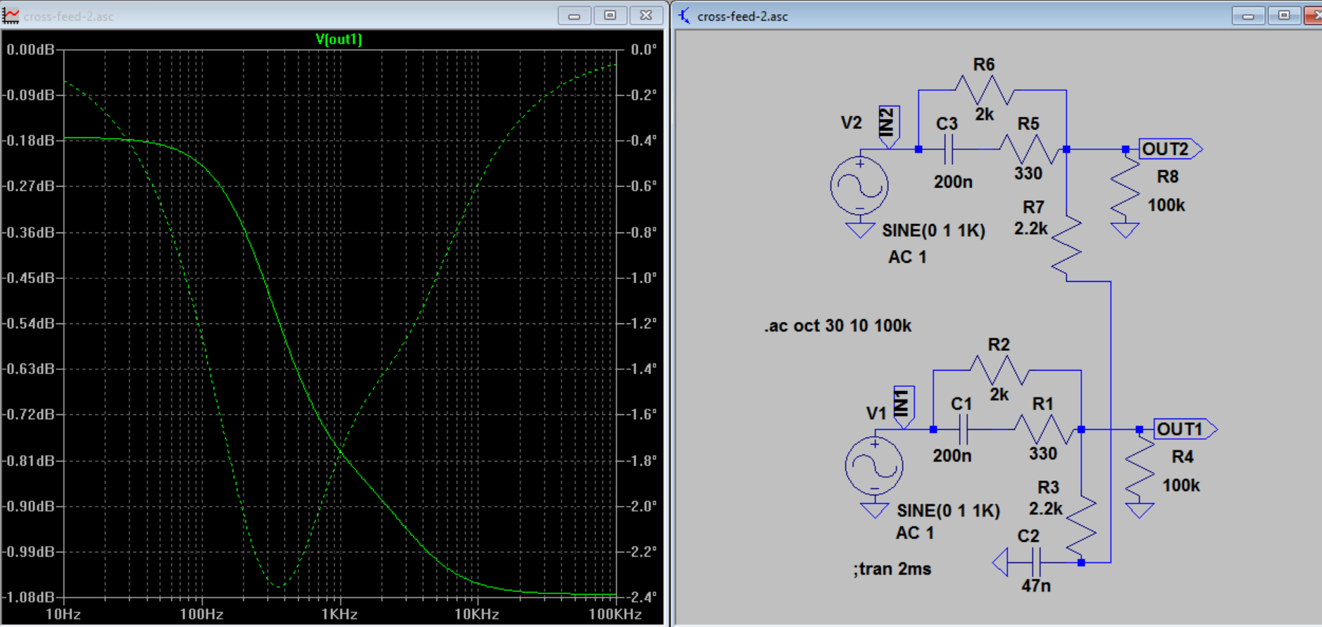

@Koonw
No problem using my xfeed?
TIA
Felipe
Yes, no problem, the loss is less than previous one, see attached. The last one shows both ears can hear equally (almost) when one channel is silence.
