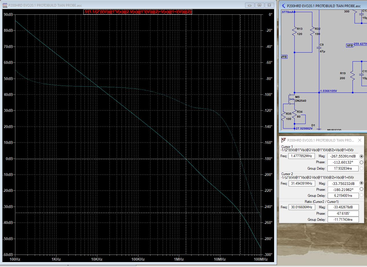

As I wanted to use a small value for the miller capacitor, I included another capacitor in parallel with the series feedback resistor in order to increase phase margin.

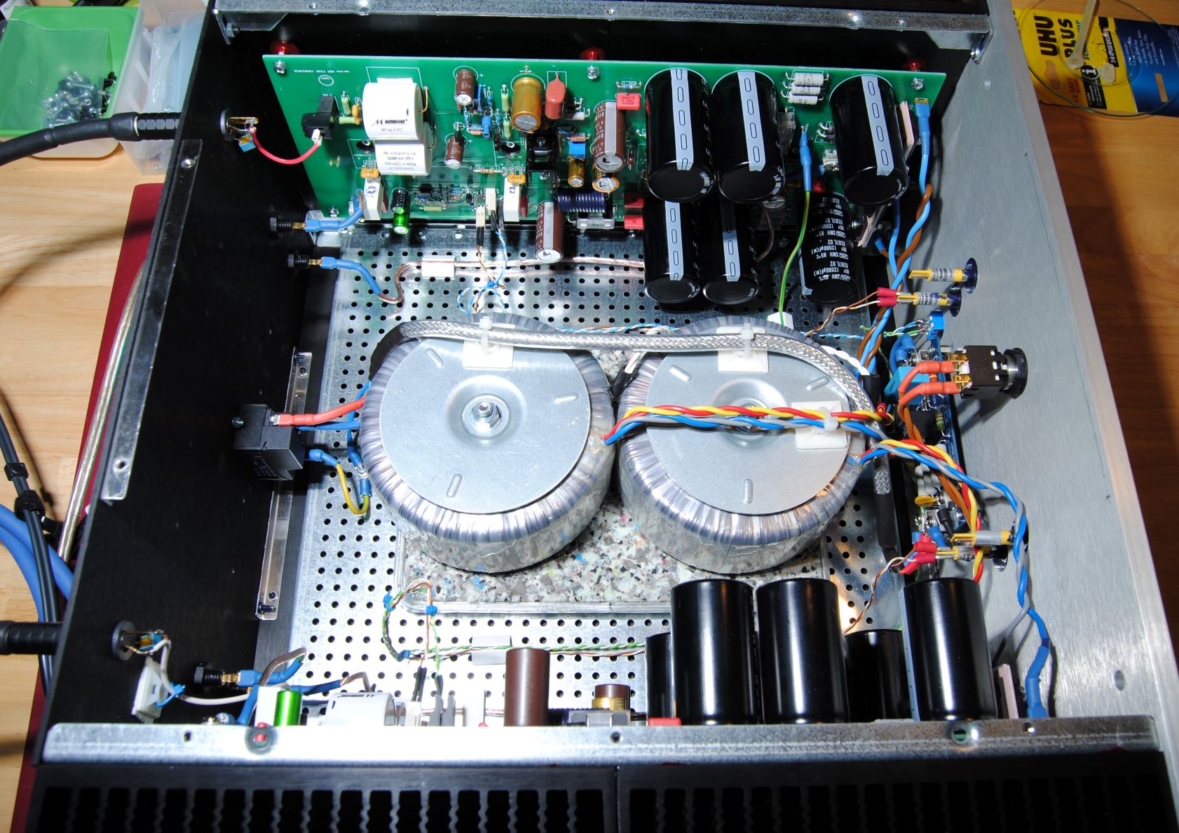

To increase image rendering I built the prototype in dual mono style with one transformer for each channel.
Each transformer has two secondaries that feed one bridge each.
Rectifying and smoothing circuits are included in the amps board so the reservoir caps are near the demanding output devices.
Local decoupling caps are provided and all gnd return paths are independent in the pcb layout.

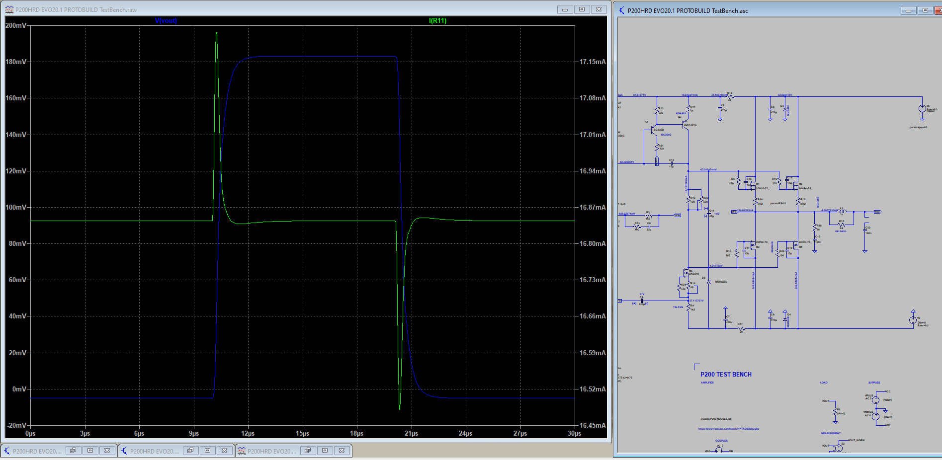

I used LT-Spice to simulate the design before the build and will provide here some asc files so everyone can also play with it.

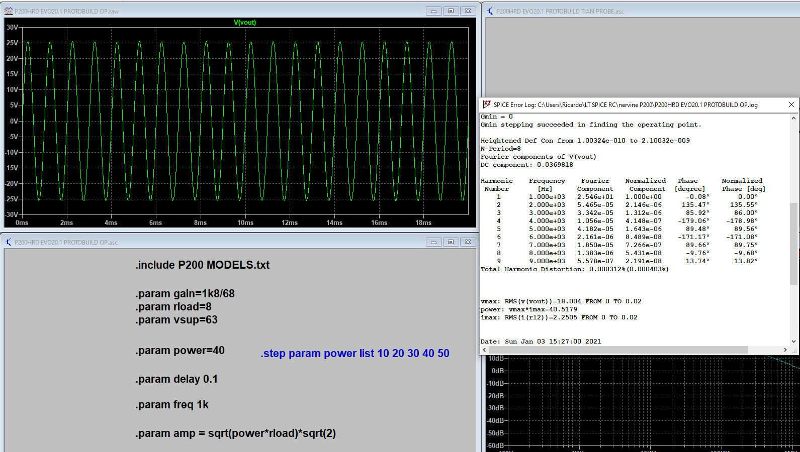

FFT @ 40W shows 0.000312% THD
To play with this sim you can change output power:
.param power=40
And frequency:
.param freq 1k
To have consistent values from the FFT graph and error log I suggest:
.param delay 0.1 for 1khz
.param delay 0.01 for 20khz

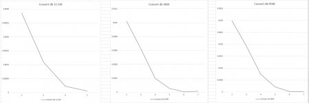

Joined 2006

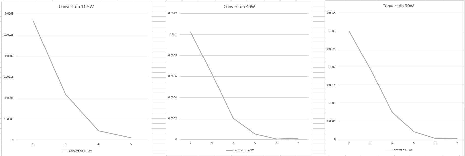

Distortion is predominantly 2nd without any noticeable "nasties".
The image below was produced with data from virtual analyzer treated in excel ...

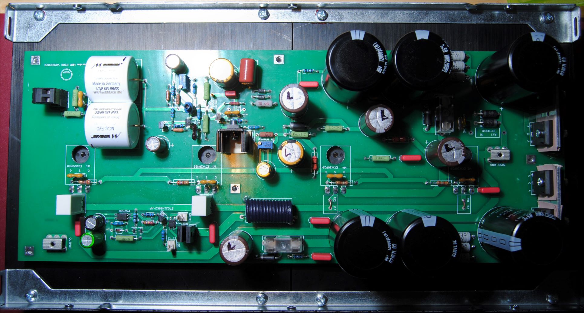

I did a FFT analysis of the built amp using visual analyser. I placed the measurements in a spreadsheet so I could visualize the harmonic distribution.

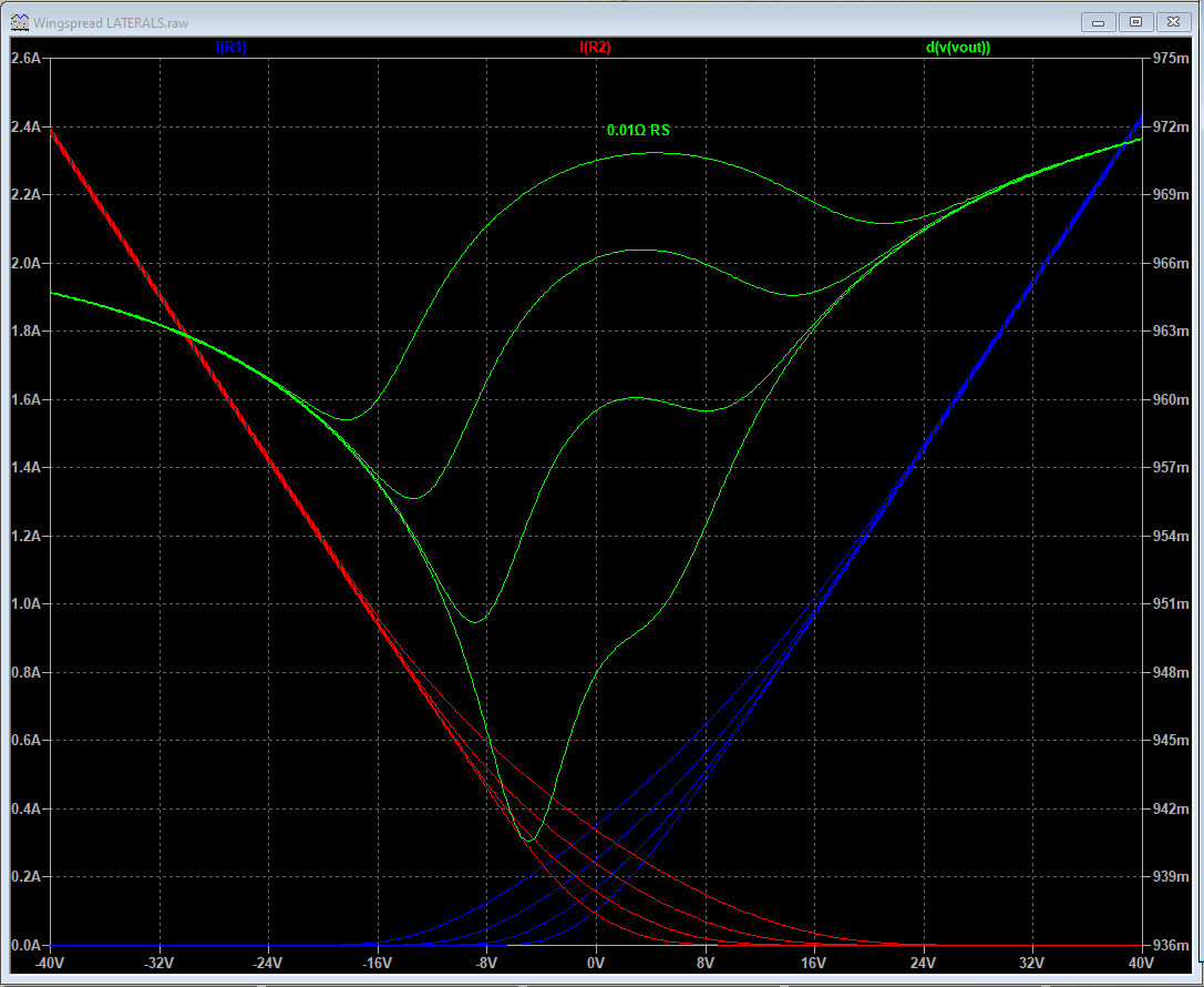

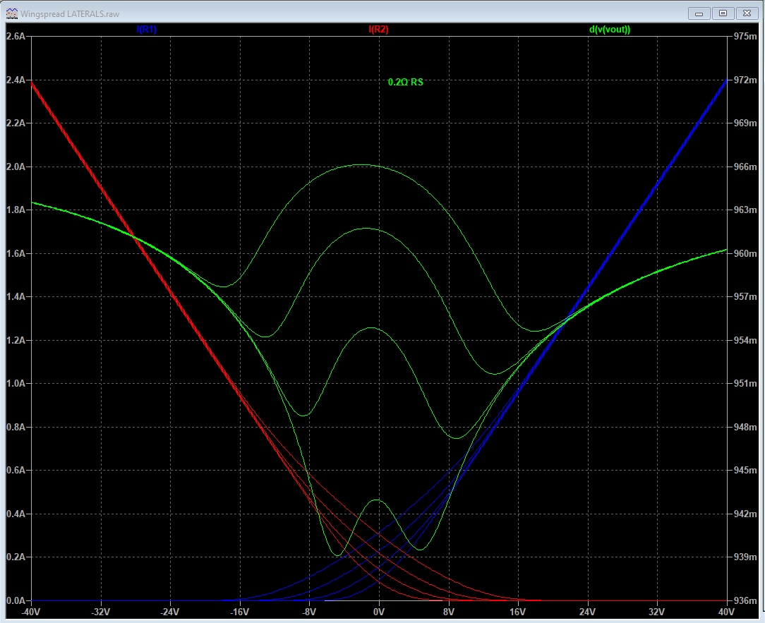

Source resistors where included to reduce transconductance droop at high currents.
I use source resistors on the positive side only to reduce crossover distortion by improving transconductance match of N and P devices.
This effectively reduces class A operation at low power levels but reduces crossover distortion at high output volumes.
To determine the value of this resistors I used a wingspread that helps to visualize the effect.
  • Wingspread LATERALS.asc
