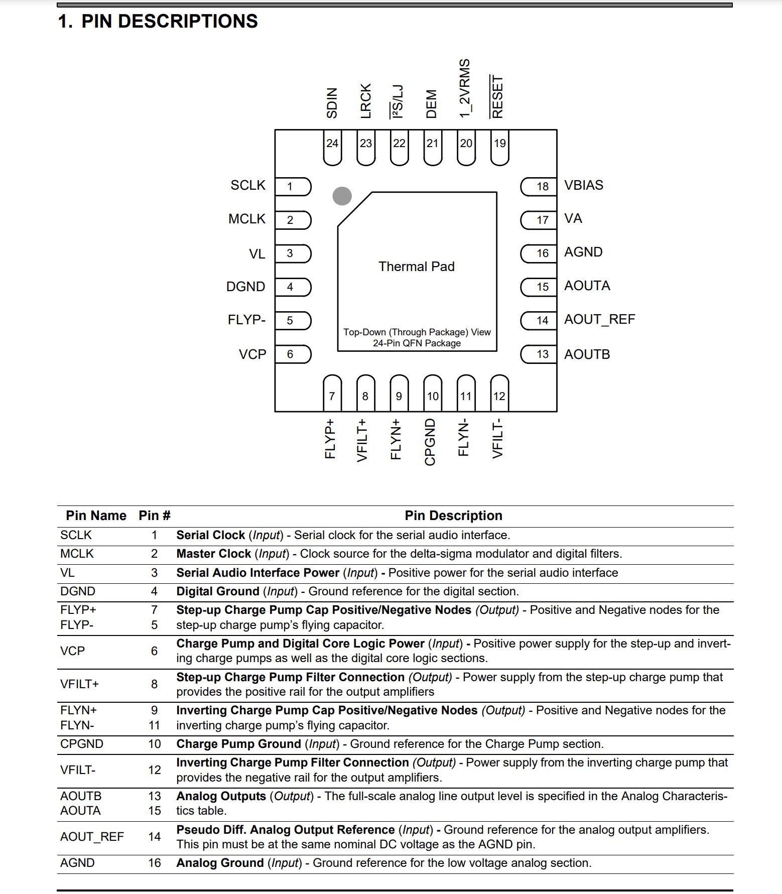

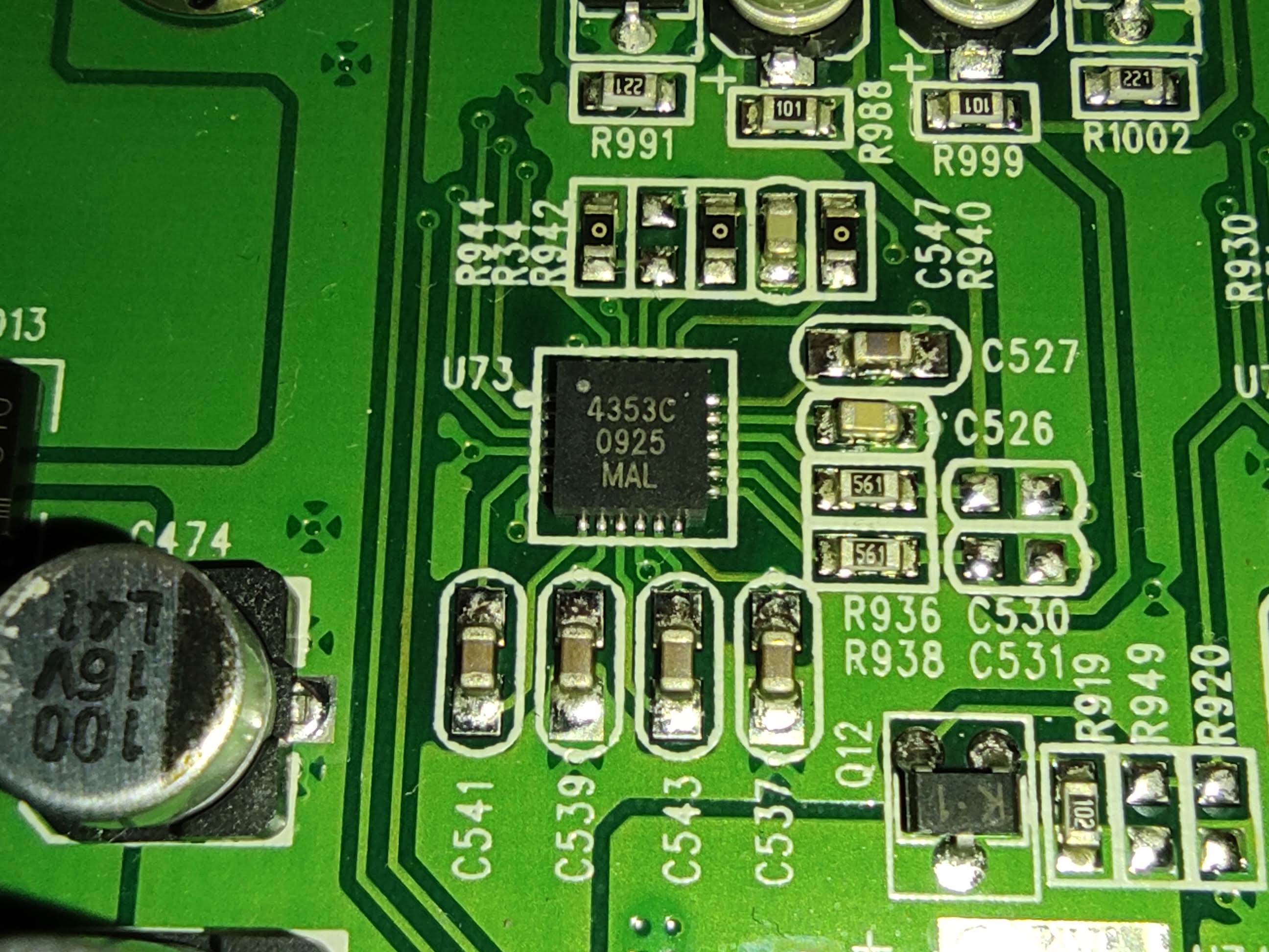

Looks like there are multiple dac chips. Your pic is too blurry for me to read the part numbers. So, you need to get the part number from the dac chips and look up the datasheets using Google search. Also, if you give us the dac part number, we can look it up too. There will be a pinout diagram showing which pins are the I2S input pins. You would need an oscilloscope to look at the signals.

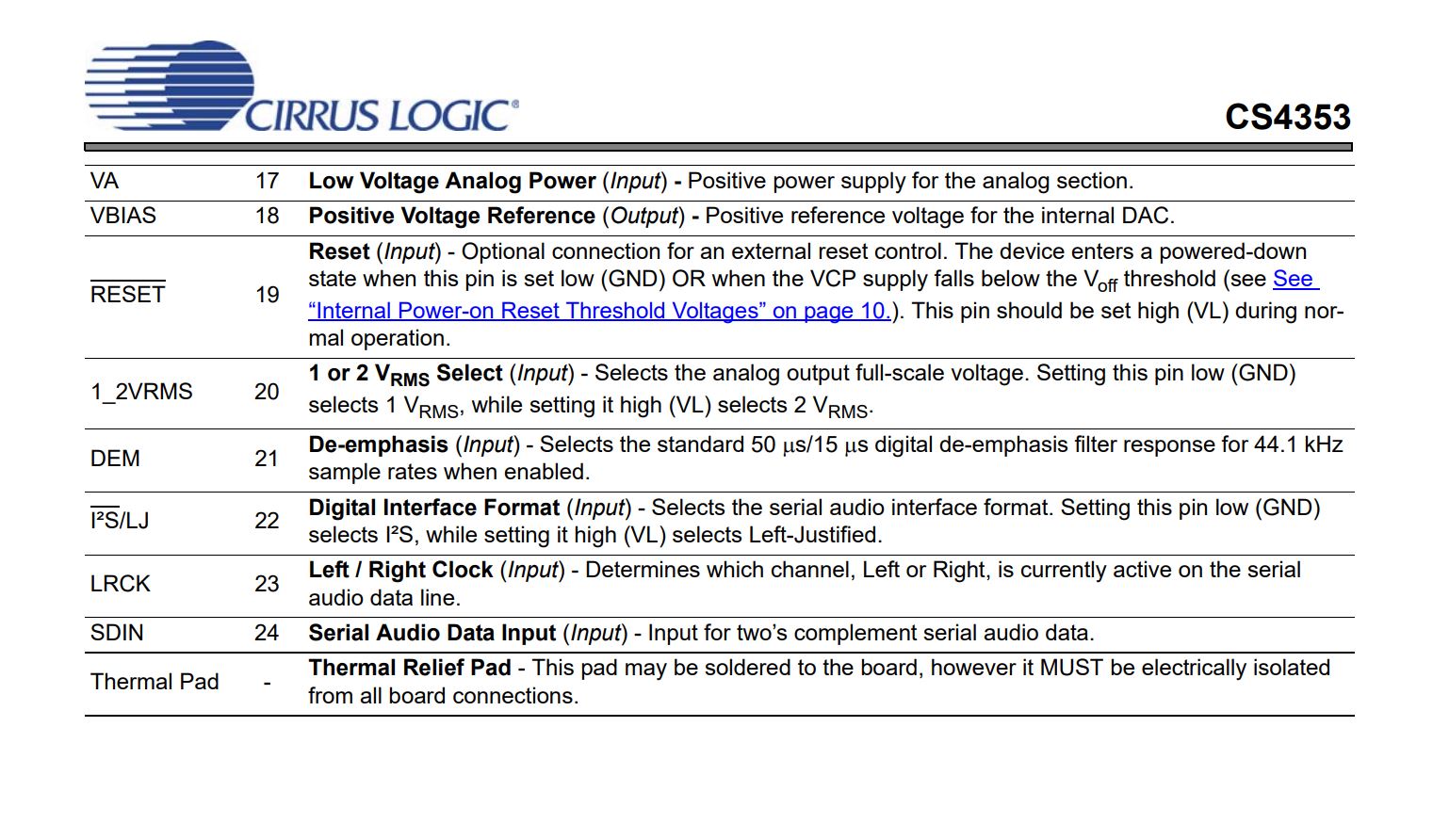

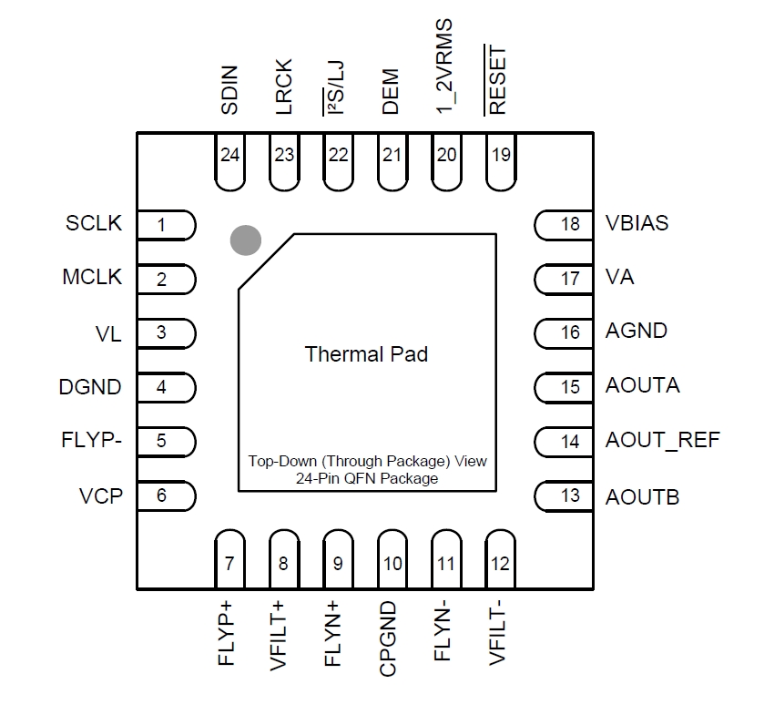

Yes, there are 4 DAC chips (CIRRUS LOGIC 4353), as this is a 8 channel DAC (7.1 audio extractor).
I uploaded a picture of the pinout...

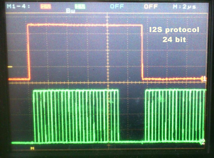

The four signals of interest would be MCLK, SCLK, SDIN, and LRCK (and ground, typically one ground wire for each digital audio signal). Technically, MCLK is not one of the I2S/PCM bus signals, but you would need it too if you want to stay in one clock domain (although there are ways to get around that).
Regarding a scope, MCLK might be as much as 50MHz. A 50MHz square wave would look closer to a sine wave on a 100MHz scope. If you wanted to see the actual square shape you would need a much faster instrument. I guess you might take a look at the popular 50MHz to 100MHz scopes on Amazon to get an idea. That's probably about the minimum you would want if you would like to include digital audio as realistic part of your electronics hobby. Although new digital scopes have some nice features, an old analog scope from ebay or somewhere might be a lower cost option.
All the above having been said, some people have succeeded at routing and using digital audio signals without a scope. However, troubleshooting can be difficult, time-consuming, and frustrating for everyone: yourself, and whoever may be trying to assist you.
Looks like the scope you linked to is 200kHz bandwidth, which is way too slow. You probably would want to have 2 input channels and a minimum of 50MHz bandwidth. For a new one you might be looking at: Amazon.com: Osciloscopio de almacenamiento digital Siglent: Industrial & Scientific

Okay, lets talk about I2S a little. Three signals are shared (all the same) between the four dacs in your HDMI box. Those are: MCLK, SCLK, and LRCK. Each dac also receives a unique SDIN signal, which means there are 4 of them.
To extract those signals from the HDMI box it would be necessary to solder a small wire onto each signal. Its possible they have buried the signals where it would be difficult to get to them, or it could be they are fairly easy to get to. One would have to examine where those signals go into each dac and see if there are traces on the PCB leading away on the surface. If there are surface traces, then even better if they go to an SMD component as that might be an easy place to solder a wire on.
Another thing to understand is that I2S/PCM bus signals are not designed to be run long distances. Not more than s few CM wire length would be ideal, although people have run longer wires and gotten away with it in some cases.
It could also be that your DSP board would have no use for the HDMI box MCLK signal. If it uses a process called ASRC to convert the audio data to a new sample rate, then its I2S inputs may be limited to the remaining three signals (and ground).
It might be a good idea to examine the HDMI box PCB with a magnifying glass or maybe a 10x power microscope to see what there is in the way of exposed locations where the necessary signals could be picked up.

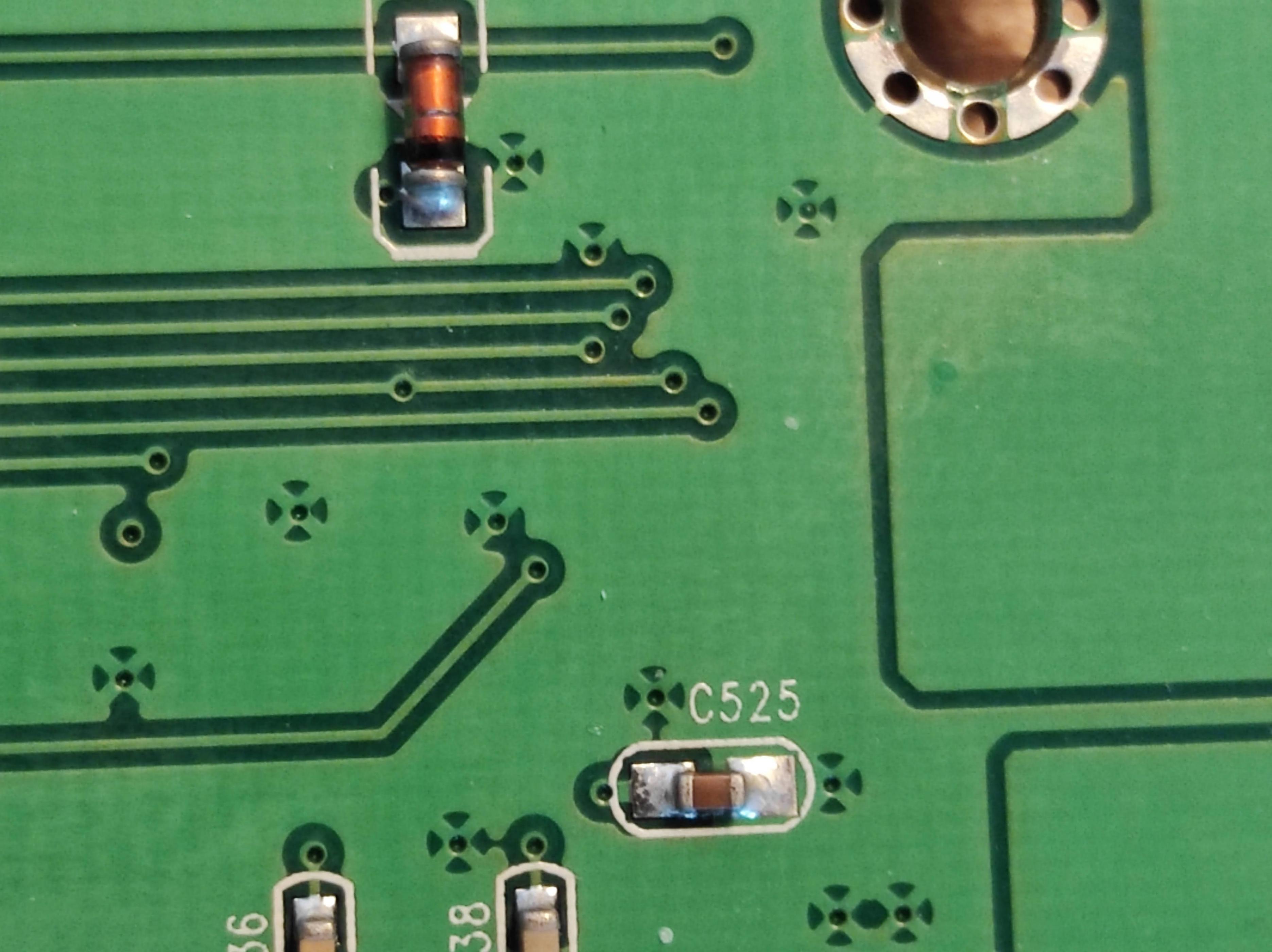

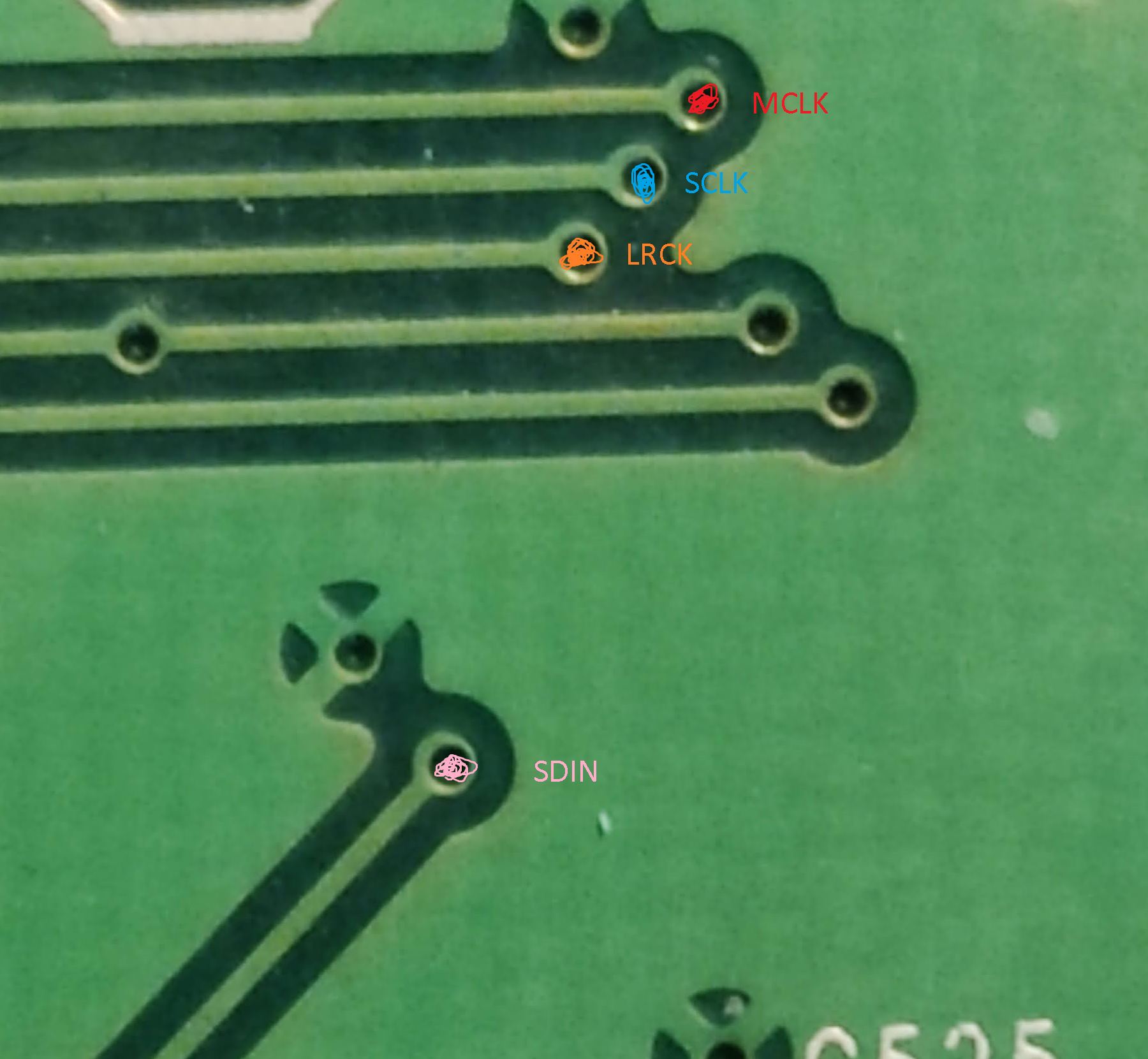

The signals don't seem to be buried in general. I uploaded some new pictures with more details and show some SMD components (caps and res). I placed a small USB-C adapter in one of the pictures for size comparison.
Obviously, the 4 pins I need do seem to be buried, so my only alternative would be to solder it directly to the QFN package...

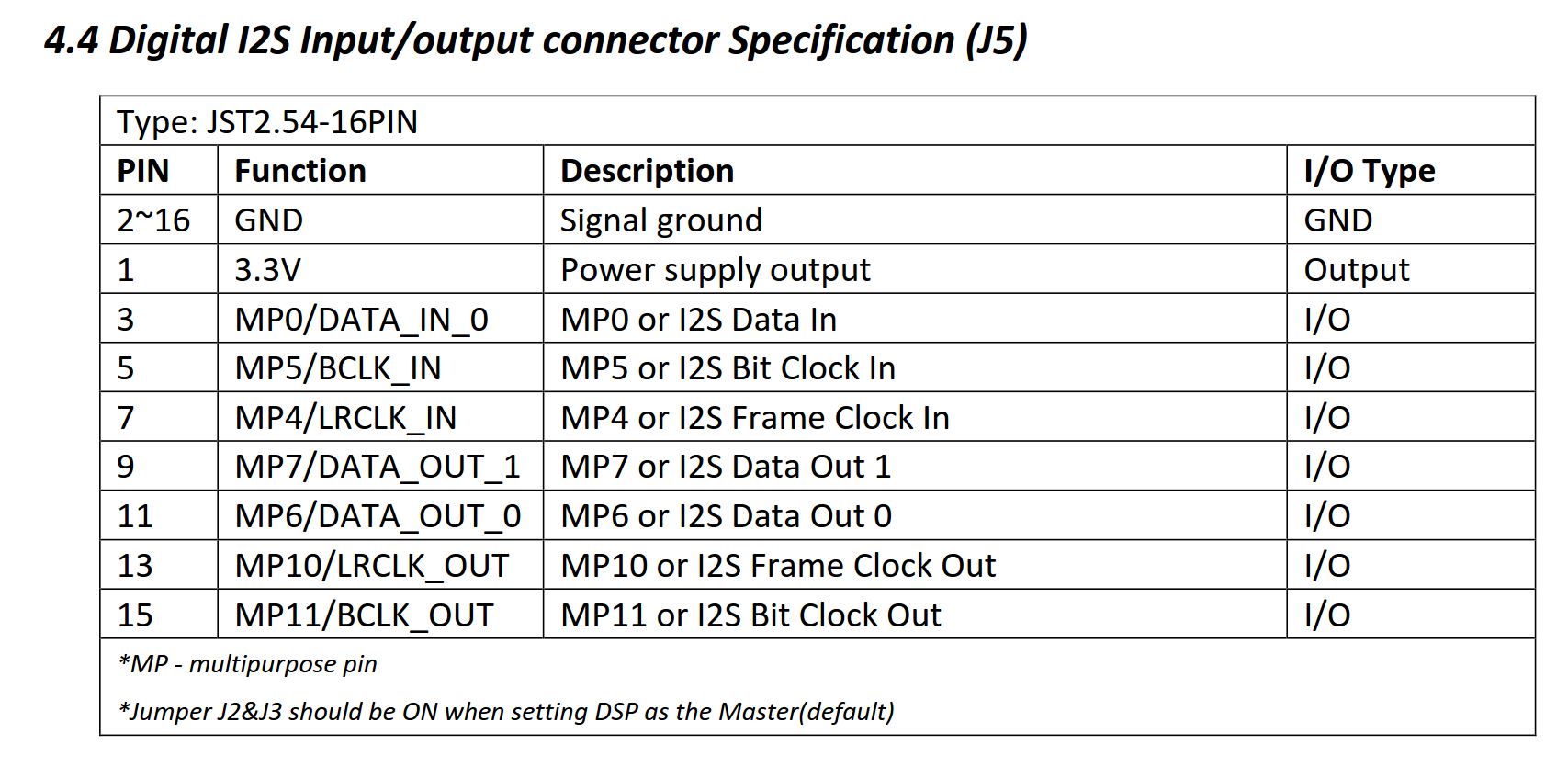

About the HDMI MCLK signal, it seems the DSP does not have use for it. I uploaded the pinout of my DSP's I2S port.

Looks like there are VIAs on traces going to the pins in question. Maybe easiest to scrape off the solder mask over the via with a tiny tool, then tin, then solder on some tiny wires. Attached below is a pic with the VIAs circled in red, and a rectangular area where it might be possible to scrape off some solder mask and attach signal grounds. Also a pic of the chip pinout. SCLK and LRCK would only be needed from one dac since they should be the same for all dacs. Sounds like you can skip MCLK altogether for this project.
Thanks for your reply!
I will try to solder thru the VIA, but first i will check if they are blind or through, as maybe is easier to get them from the bottom of the PCB.
After that I will wire it to my DSP and report.

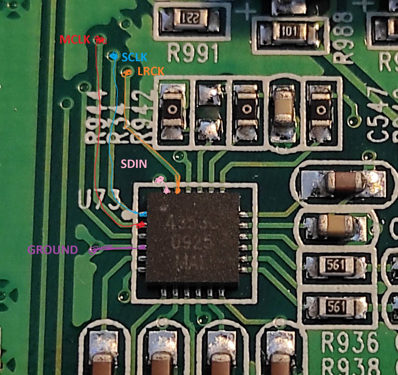

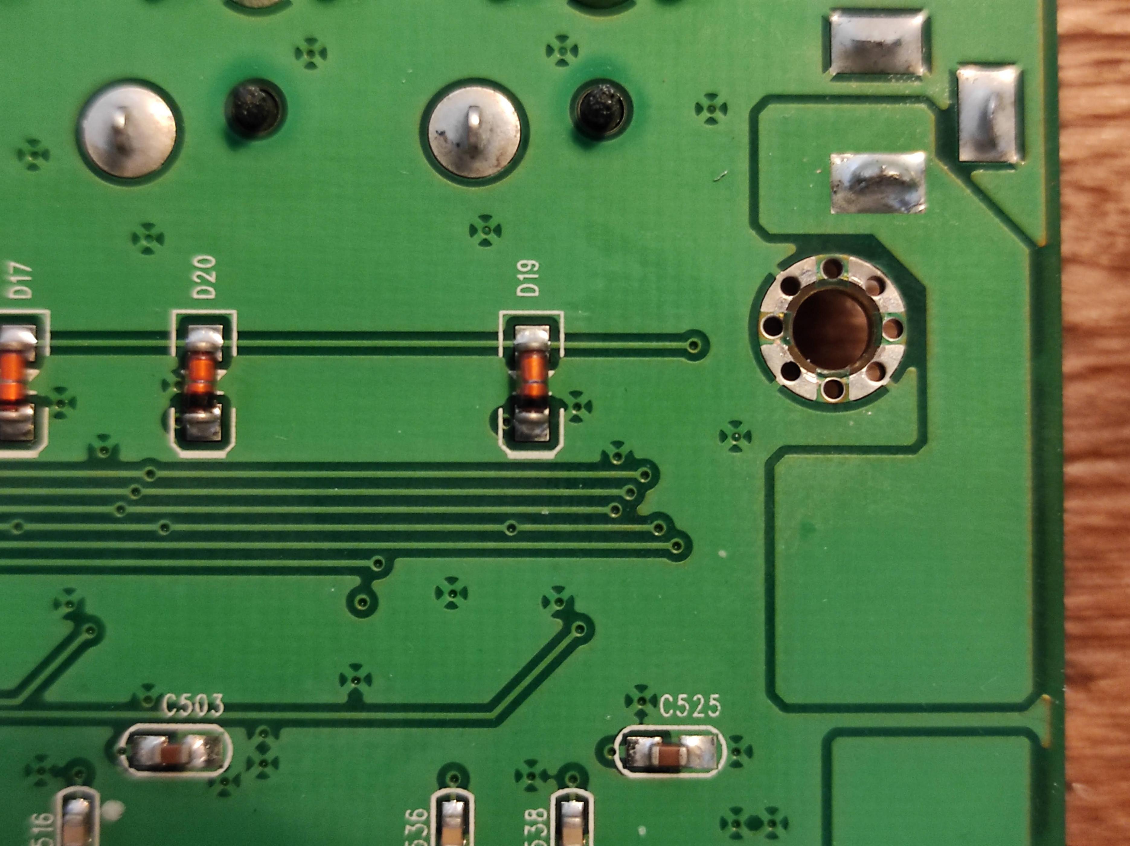

Last night I removed the HDMI Audio Extractor's PCB from the case to check if the VIAs are through, and they are! So it's a little bit easier to solder some cables from the back.
I have attached some pictures, and it would be great if someone could help me validate my pinout scheme.
Also, from previous posts, I need only one set of MCLK, SCLK, LRCK and Ground (digital), and one SDIN for every 2 channel (one for every DAC). Correct?
Finally, how long can I2S cables be? Is it OK 10 centimeters?

You can always scrape off a tiny bit of solder mask on vias or traces, then (with the board powered off) use a DVM in resistance mode (some have a beep mode available) to verify which traces are connected to which. To scrape off solder mask I usually use the smallest jeweler's screwdriver I can find or else a sharp Exacto knife (aka hobby knife). Note: If you may solder onto a trace or via then try hard not to scrape off any solder mask on areas of nearby copper you might not want solder to stick to.

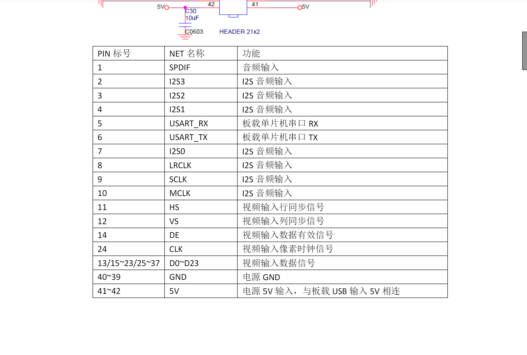

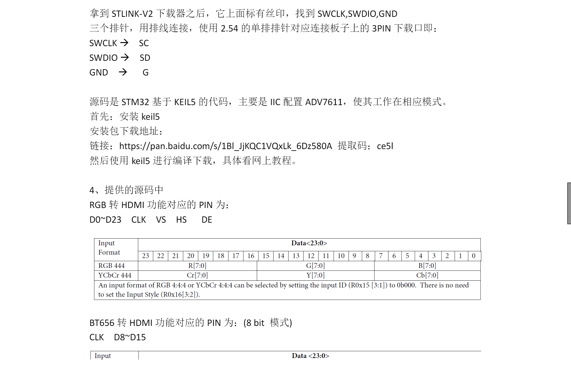

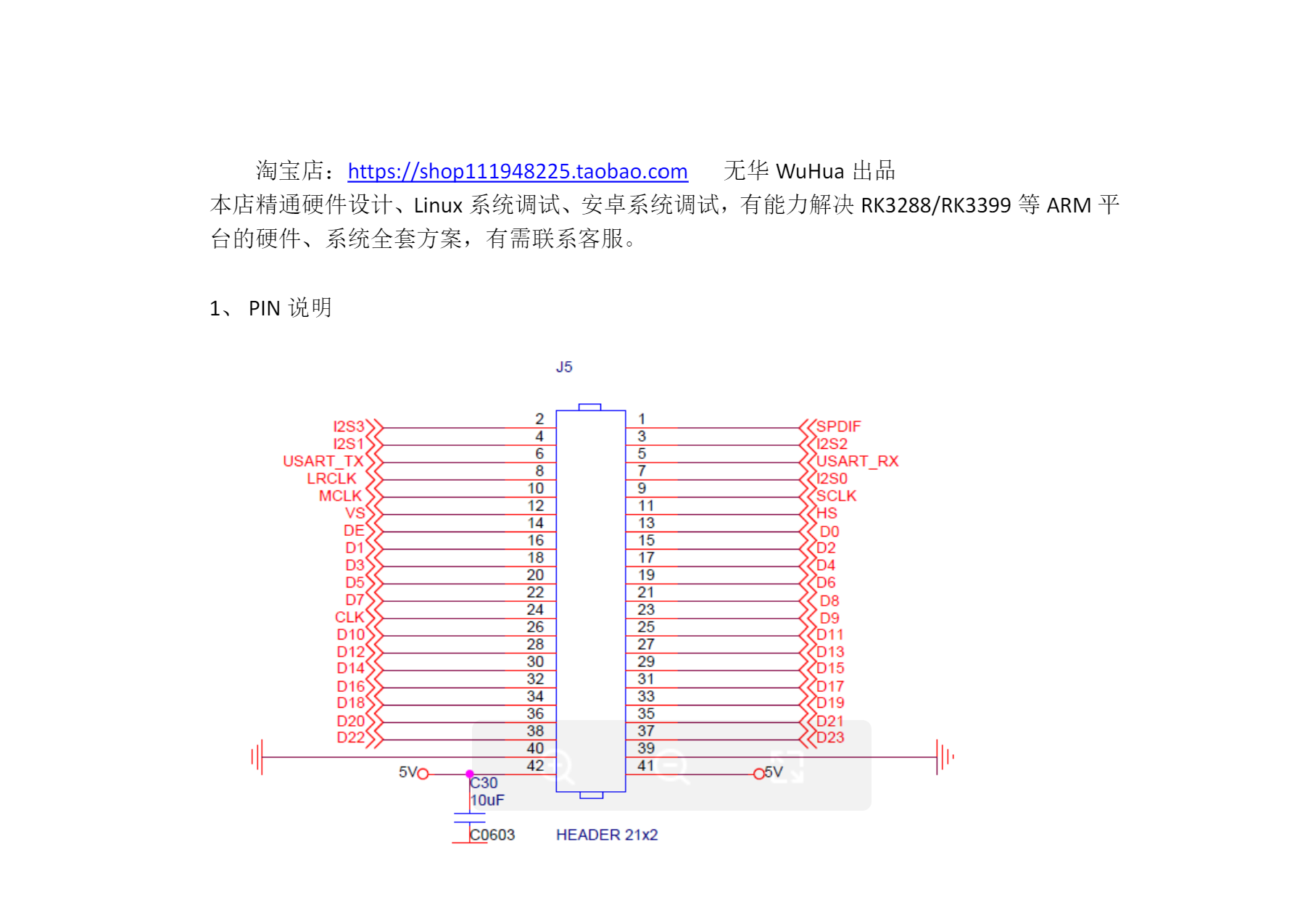

Sorry to refloat this thread, but I've found an HDMI developing board with the AD ADV7513 which is an "old" chip but pretty capable... and as it looks it seems this little board outputs 8 audio channels in I2S signal format, which would be great to extract audio and send it to a DSP, process it and then output it with a high quality DAC.
This is the board:
Placa de desarrollo RGB BT1120 BT656, entrada a interfaz Multimedia de alta definicion, salida ADV7513, placa de solucion de pantalla FPGA|Enrollador de cable| - AliExpress
Also, some pictures of the data sheet.
I know HDMI audio has a high jitter, but still if we can get a DSP with HDMI input, would be great.
