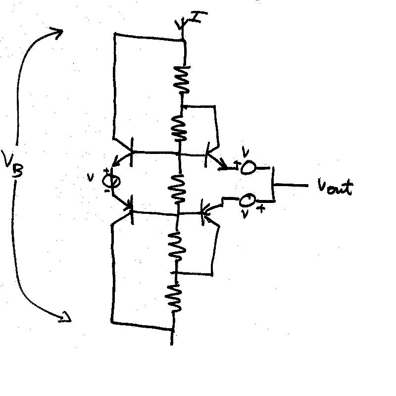

Is this familiar?
Nelson Pass said:
I'll give you a hint. It's a bias circuit for a complementary
follower output stage.
Hmm. Looks like a combination of temp compensated bias with the split collector resistors and some sort of current limiting. Then again, that part might also double as a Hawksford error correction circuit, depending on the resistor values.
Then again again, his may also be a novel circuit to de-ionize a listening room to remove listener bias...
Jan Didden
Nelson's circuit is from his 1976 patent. Hawksford's error correction circuit is derived from Nelson's circuit.
I think the point Nelson is making is that he tried these kinds of circuits 30 years ago. For him they were interesting for a while, but now he no longer uses them. I would assume that this is because, in his experience, they don't sound as good in the real world as one might think based on simulations or measurements.

BTW, you win Charles. I was scanning a 30 year old notebook
into computer files, and couldn't resist. 😎
