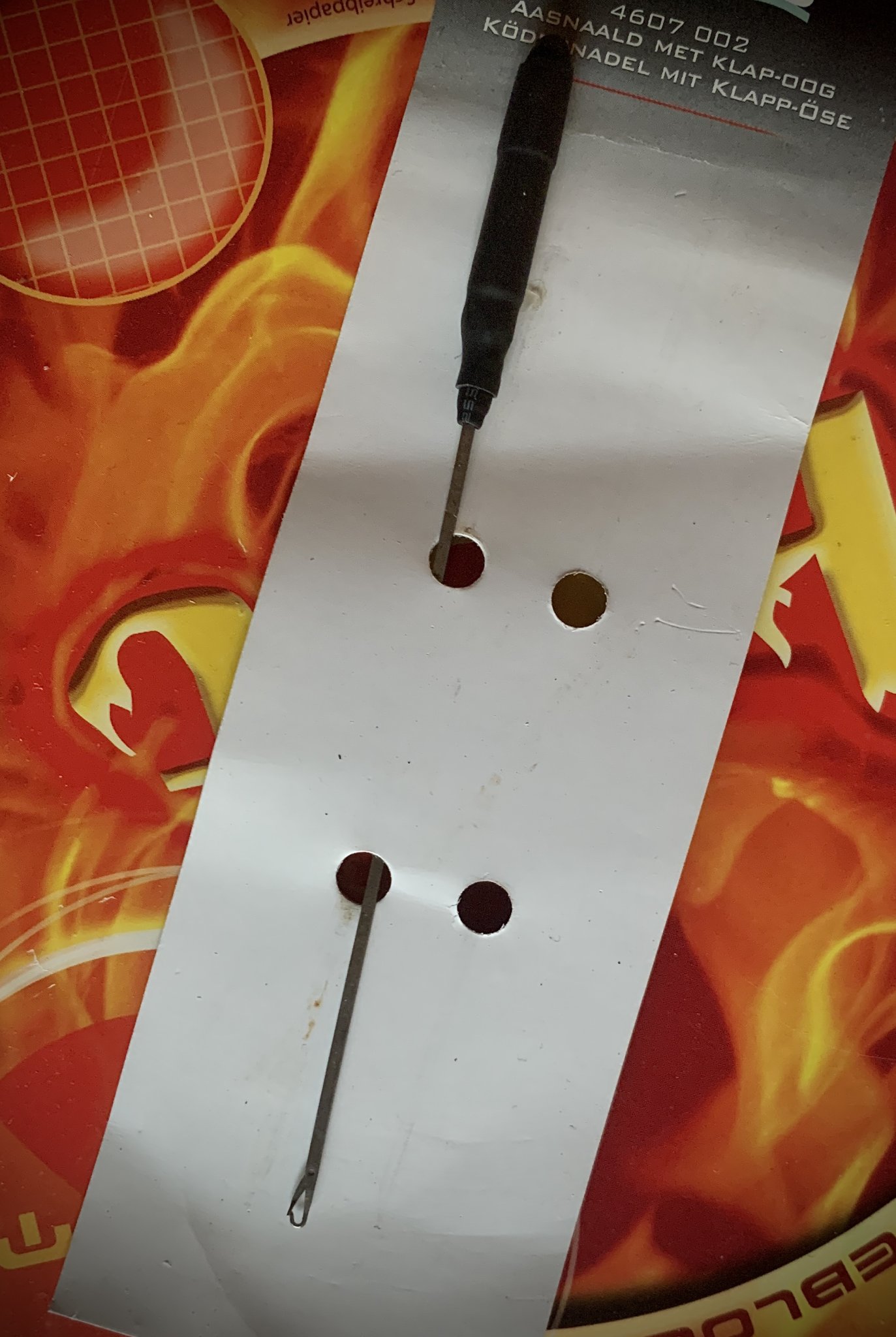

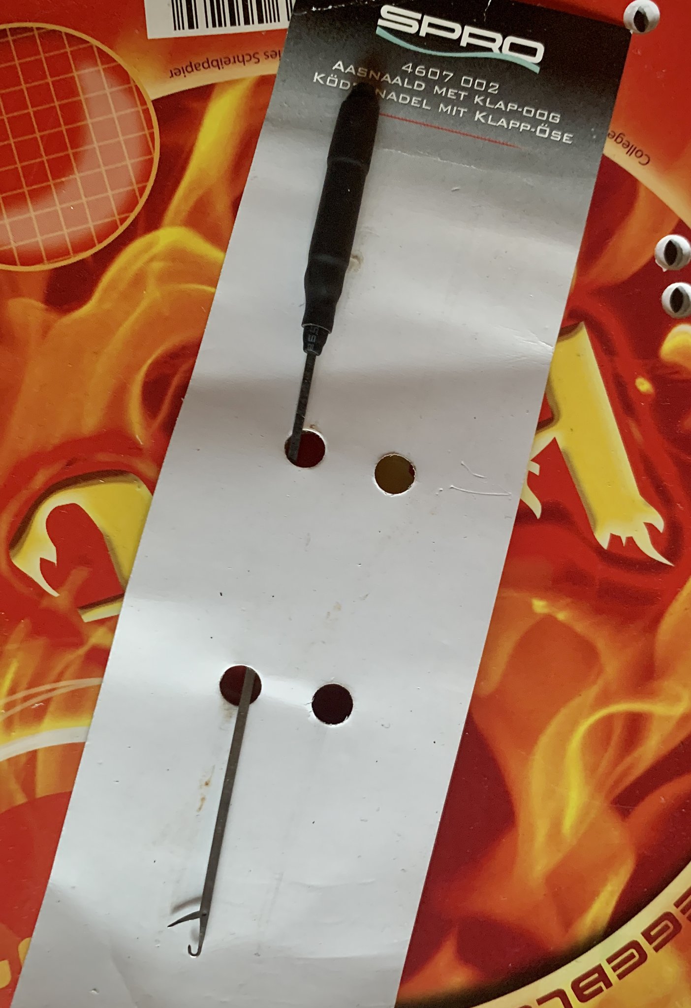

I once repurposed a baitfish needle from my tackle box and it works great. It's now one of my fishing and soldering tools.
