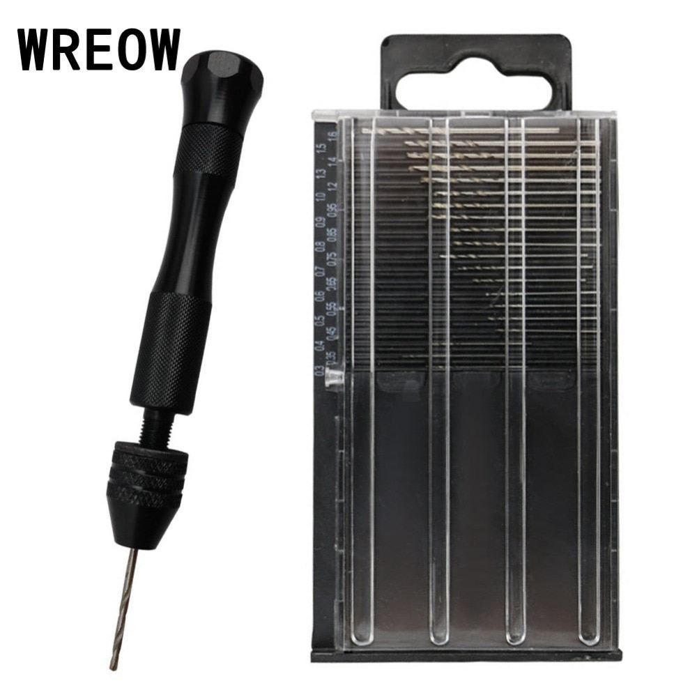

I have faced the same issue. The problem is the heat does not get to the solder that is trapped within the thickness of the board. For boards that are not too thick, let's say 2mm or less, you can use some of the needle style soldering tips. Push them through and further open the hole with a needle. Hopefully, you have a soldering iron of sufficient quality that it has replaceable tips. But when working with 3mm+ boards, even these do not work as they cannot apply heat to the trapped solder. For these cases, I have successfully used mini drills such as in the attached photo. These I have obtained from AliExpress for less than $5US. A set that includes .3mm is essential. And many extra drill bits, as they are of low quality and tend to bend. Start small and work your way up in diameter. One key is to not waste too much time using braid and solder suckers, they are ineffective and you end up overusing them and applying too much heat in an effort to reach the unreachable solder and damaging the board. Been there.

Drills can work with simple, single-sided old skool boards I have found, but am hesitant about using them on more compact, and complex, multi-layer boards.

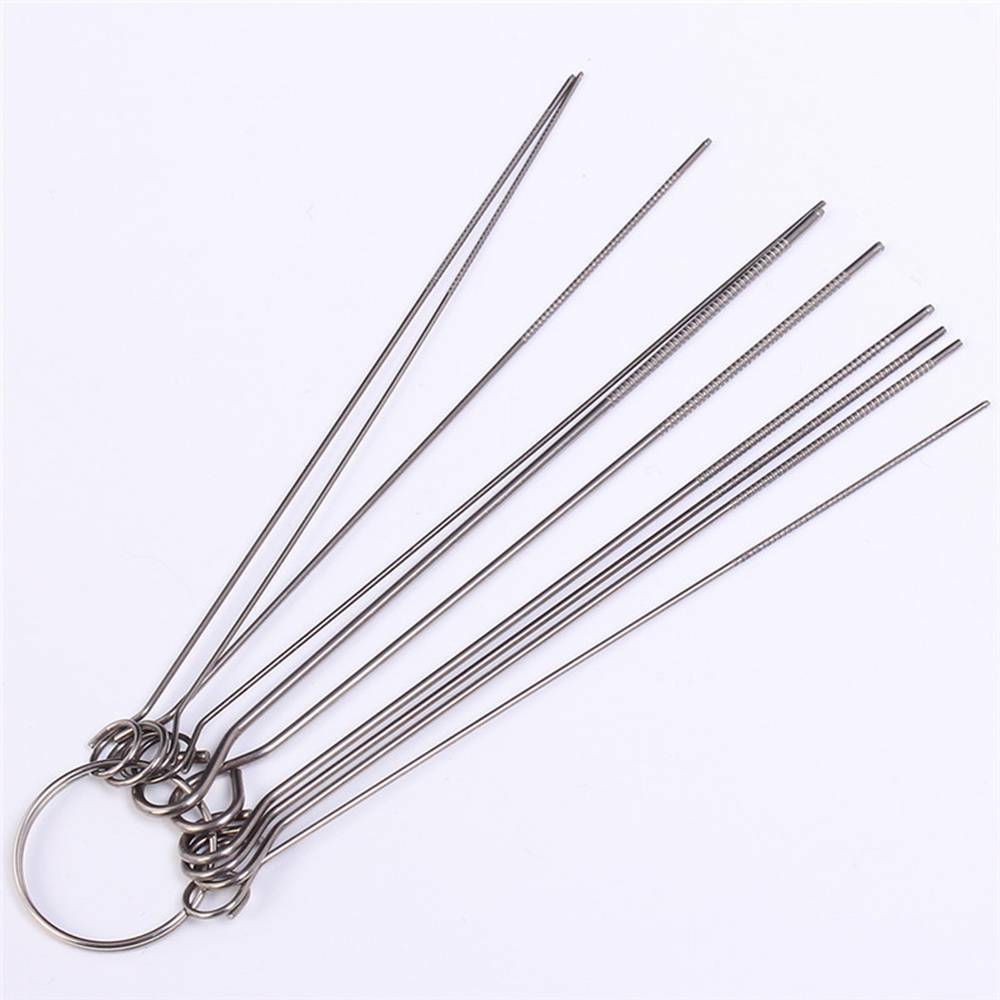

There is a simple way to desolder the innards of the tht-holes: Use some pin made of a material that rejects solder, for instance V2A. I use that ugly thingy my dentist uses to remove plaque. Heat the via from the component side, set the pin just onto the solder blob. heat is as well. When hot enough, press on it and it will slip into the hole and press all the solder out of the hole. Remove soldering iron, wait a short moment. Now you can remove the pin that does not stick to solder, your via is open now😉

They are called "desoldering needles" and many eBay sellers offer them for ridiculously low prices. Here is one example of many, many possibilities.
They're made of stainless steel, a material that electronics solder doesn't adhere to. Explanation plus video here
I recommend buying three or four sets, because the smallest-diameter needle (blue @ far left) gets bent pretty easily, and that's the one you'll be using 85% of the time.

Practically, 0.6 / 0.8 / 1.0 / 1.2 are the drill sizes, so get needles like that, thin needles can break. Thick ones with long tapered tips are better.
Stainless wire will work too, finding small pieces is left to you...
