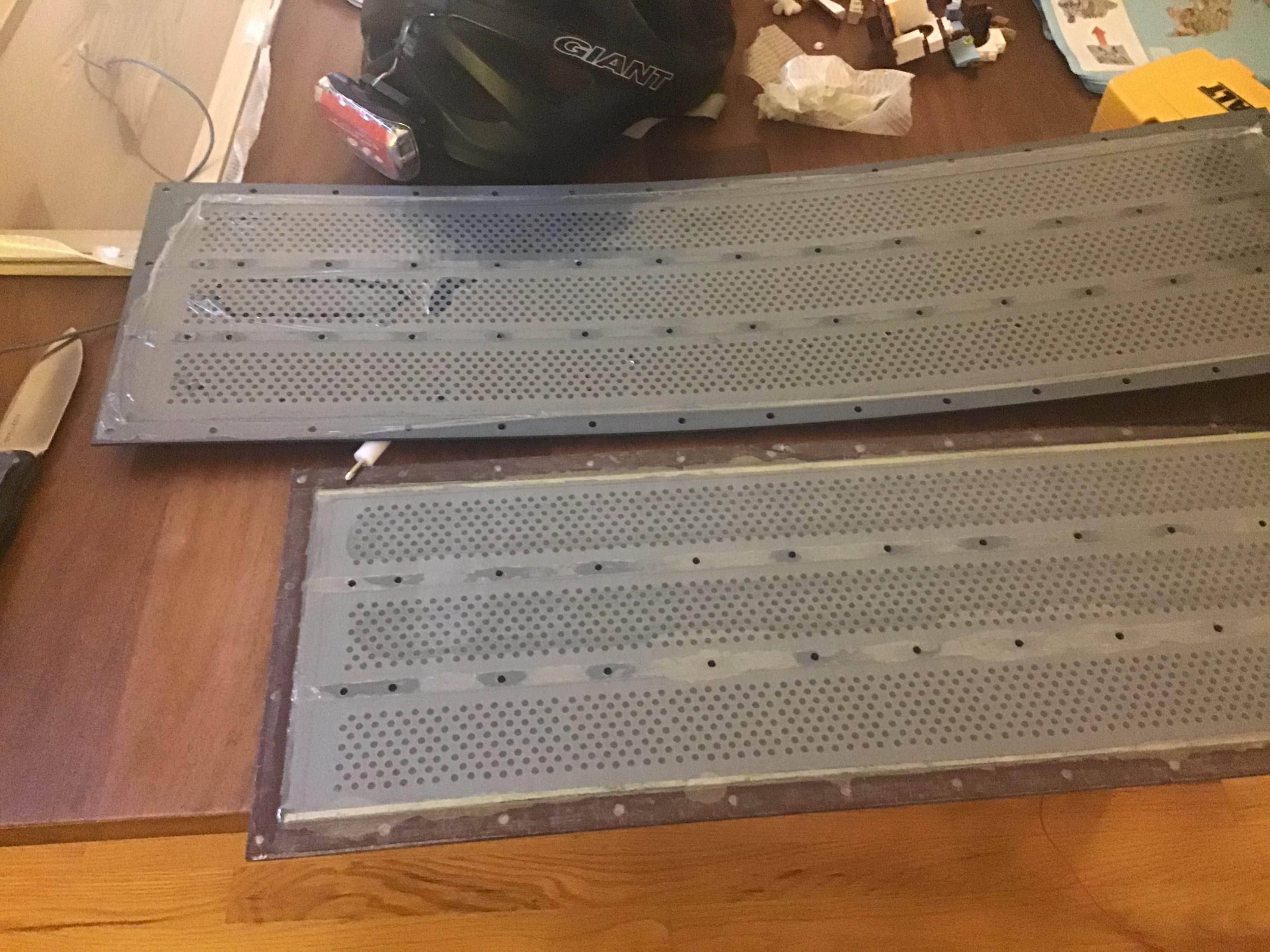

Is it me or should these not have two membranes???? One seems to be fairly intact. The other is a total mess. Big hole in the middle.
Is there something I’m missing here?
One other thing is that the membrane on the one with the red border has fused to the stator. It’s not ripped. I can push it out from the other side and it lifts off so I think the stators can be saved.
I really wonder what the other one is like seeing as it sound fine.
That is really weird, I've never seen anything like it. That's certainly not normal for a panel rebuild. The only thing I can think is that if Wayne used the same crappy nylon coating that quad used, and put it on REALLY thick, the "second" diaphragm you see could just be the coating that pealed off in a unit.
In your picture, you can see the real diaphragm glued to the bottom stator, and the mystery sheet is not really glued to anything. I suspect that is his conductive coating, but anything is possible.

It’s pretty damn weird.
It’s not Mylar as it’s quite stretchy and you can roll it into a tight ball like wax. I think you’re right about it being the coating. On the side with the membrane the membrane is stuck to the stator pretty much along the length and width of the panel. I think when I split the panel it pulled off the coating as it came away with the free stator.
It’s a miracle it made any noise at all!
Mylar itself is still glued ? You may be able to remove this wax, if not applied on both sides of the diaphragm.
