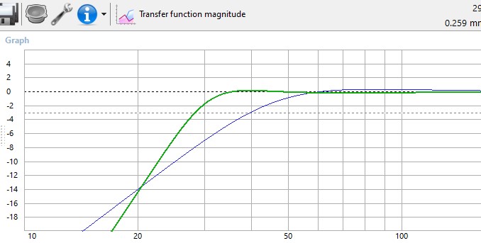

I really like my speakers and will probably never get rid of them (famous last words, right!?!?). What started me on the DIY path was that I want to use the subwoofers as stands and couldn't find any commercial sub with the right measurements. Using them as stands limits the measurements to max. 12x12x26" (30x30x66 cm), which equals a net volume of around 37 liters.
I have been playing with WinISD and come up with a couple of ideas. In the picture below, the green graph is an 8" ported design. The blue is a 10" sealed box. Since my goal is to extend the bass to around 30 Hz, which of these is a better choice? For the ported design it shows a port velocity of 3 m/s. Any other specs I should take in consideration?
Forgot to mention about the amplifier. Not sure what I'm doing about the amp yet. Probably an external amplifier. I have been considering a Hypex DIY kit or an Outlaw 5000 for both the bookshelves and the subs or something else.
I guess the link in post #16 didn't work. I'm trying again. (Hopefully) below is the screenshot of the WinISD for the two sub projects I created. The green graph is an 8" ported design. The blue is a 10" sealed.
3 m/s ?! Maybe at 1 W.
OK, the referenced Dayton Audio RSS265HF-8's classic vented alignment is ~ 36.86 L 'net', so could be a little less to fit the driver, but to get the performance it's capable of requires 350+ W and a large, long vent to keep its vent mach reasonably low [< 20 m/s] which requires nearly 20 L alone, so if you can run the vent outside the cab............[at ~56" mostly rhetorical].
Regardless, With inexpensive DSP, such tiny cabs are best sealed with as big and/or as many drivers will fit and EQ it to best blend in room.
Import the Hornresp file to view, copy, modify, etc.; omit the vent and it looks good sealed with modest DSP. A 'stereo' pair sims near THX reference from 30 Hz and if there's enough room/boundary gain, then could get down to its 20 Hz reference.

Sorry for not responding sooner. Work has just been incredible this week and I've been to exhausted to think about this.
You're right, it was 1 W. I hadn't even played with this power level before. I just tried 50 W and the velocity was almost 20 m/s. This ported box was using a Dayton Audio RSS210HO-8 8" Reference HO Subwoofer 8 ohm with a volume of 20 liter with a 2.5" round port. I guess I need to do some more calculating. Thanks for pointing this out. What wattage are you supposed to use when figuring this out?
For the 10" Dayton driver I was planning a sealed box as the volume is too large for a ported. A sealed box is sounding like a better and better choice. Especially since it's my first try with a DIY sub. Although I liked the frequency graph of the 8" ported better.
Any good DSP capable amps to suggest?
