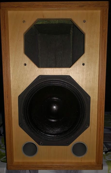

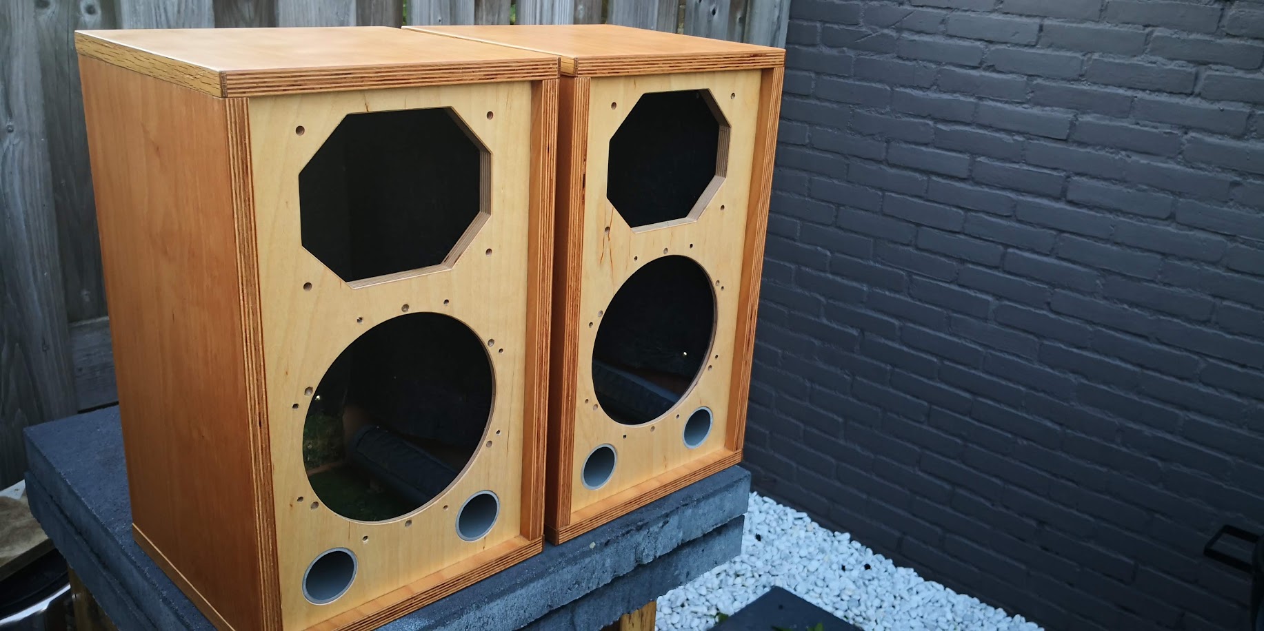

Have 18Sound ND1030 + XT120 and want to get Faitalpro 8PR200
Waiting for the horns and compression drivers.

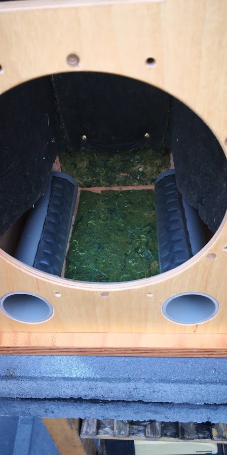

Apart from port length apparently loading it wrong. Audio Elite also pointed out that there should be at least 5 centimeter space between the end of the ports and the back wall. Currently this is 49,5mm (calculated 18mm into the front baffle) length of the port is 18,3mm. Depth of the speaker is 21,5mm
Luckily I did not glue the ports to the front baffle yet. So this should all be fixable.
By the way I calculated the inside volume to be around 16 liters. So it's close to 0.58 cubic inch instead of 0,7.
Ducted ports also work when located ( in reverse ) sticking outside the box.
Try that ( to see if the problem is related to blockage/constriction/ placement too near the back of the boc.
Also do an impedance sweep ( using Limp or REW's impedance measurement system & a jig ) to check your actual box tuning.
