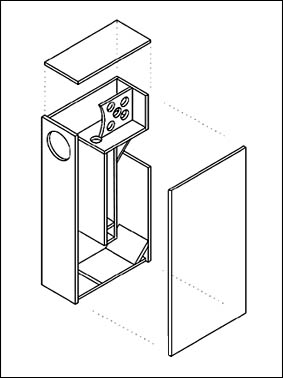

Here a image.
A bit late but I like these exploded views for drawing up projects. Post #8 https://www.diyaudio.com/forums/full-range/45082-tried-singular-enclosure.html#post550900
Does anyone know of any open source software to do this?
