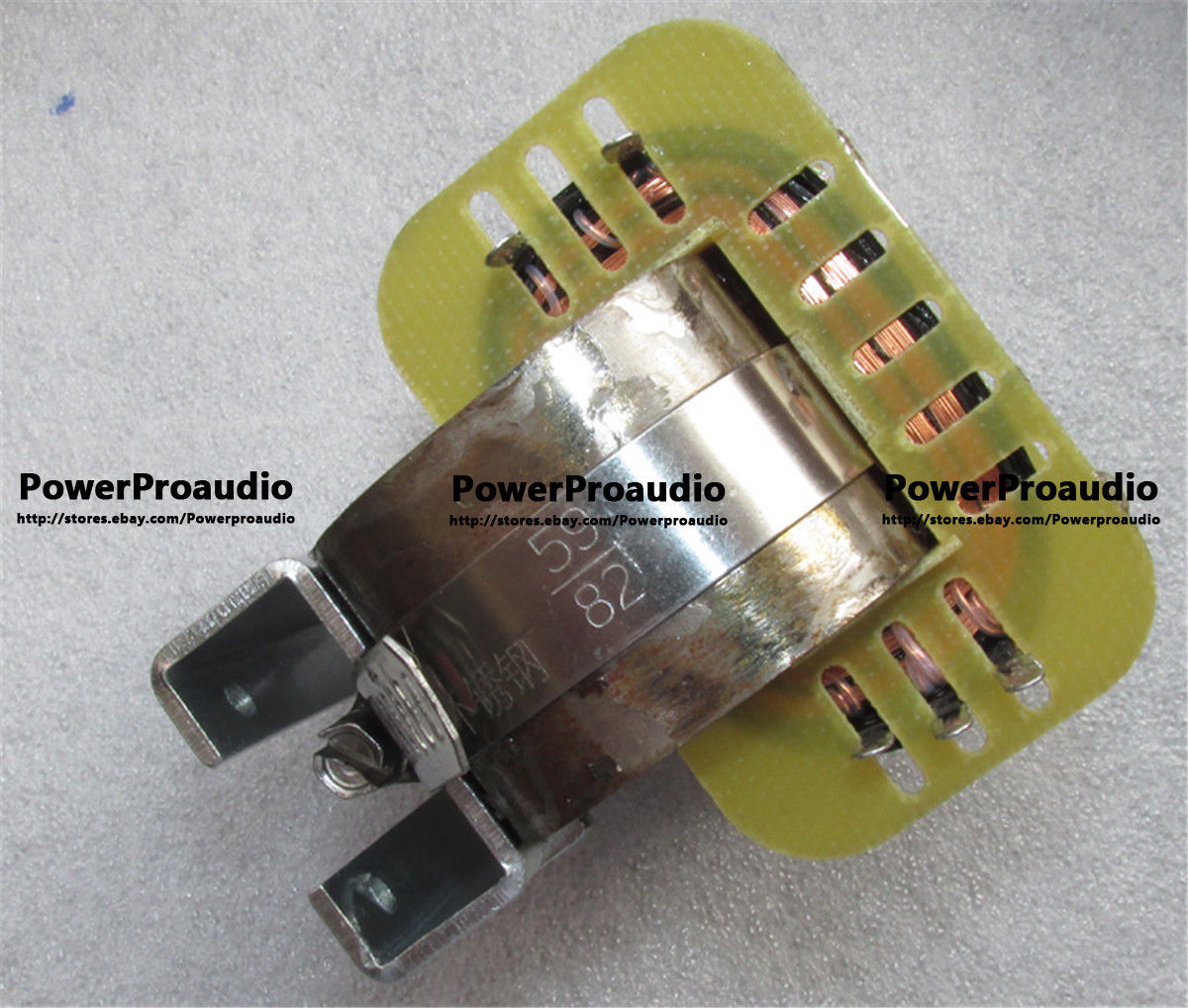

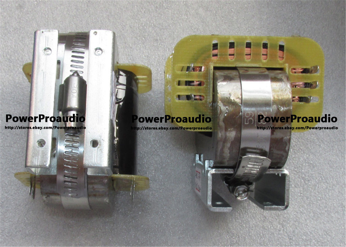

I saw Amorphous Single-ended c core Output transformer. ON ebay. could t they have an air Gap? LIKE c CORE
THANKS
pHIL

You can clearly see the strap or metal band that keeps two "C" parts together. Unless x-former itself is heavily impregnated or varnished for different reasons you may disassemble it quite easily, introduce the gap you need and put it back in order. Coating makes such a process quite dubious. Due to fragility and extreme thinness of the tape the core is made of it can be easily damaged beyond reparation. Again it depends of type and amount of varnish used. Please bear in mind that most likely the core itself is impregnated using epoxy. Amorph has to have protective layer for a particular reason: it does rust.
Transformer works just fine without the core, the latter merely keeps magnetizing current low enough.
There are hundreds if not thousands magnetic alloys out there. Old ones like Permalloy and such and "newer" ones like Metglass or Finemet. They could be quite expensive.
Impregnated types do have 5 to10 times worse specs in terms of hysteresis curve and subsequently losses in respect to the tape the core's made of. Metglass C-cores included.
Besides distribution such cores are used in common mode filtering, SMPS inductors and, most importantly in power meters' current transformers. The latter means really low magnetizing current and constant permeability or high linearity for that matter.
It's near impossible to gap unimpregnated core: see above. Please note that high flux density exists in a core only at low frequencies, so core related distortions do. At higher frequencies eddy current losses rule so it may have better high frequency response. However such cores have negligible losses up to few hundred kilocycles which, in turn, prevent passive dumping of the parasitic resonances in transformer itself.
