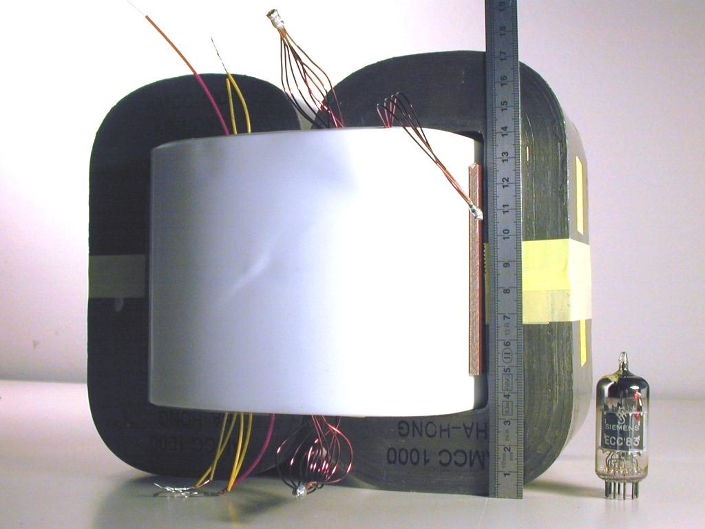

I'm looking into getting some LARGE push-pull Audio Transformers wound for tubes such as the 833a power Triode. These would be at least 1000-1500 watts each into 8 ohms and for Hi-fi. The transformer company who is willing to wind them said they would use Metglass C-Cores as they are a distributor of such.
I was initially favouring Orthosil M4 E&I Lams ( which has been very positive form what I have read ), but this particular company would have to specially order them in from the USA on my behalf. Also winding audio iron for 1500 watts is not quite as straight forward as winding for 100 watts - though the principles are the same. This company has never wound audio iron this big, for power transformers - yes; but not audio; yet they know how to wind audio for smaller sized transformers. With that being so, I found the following comment in an audio paper by Menno Van der Veen which was not favourable to Metglass in audio transformers at the high frequency end of the spectrum >

Very little of what I am reading from that quote makes any sense....
Nothing in that white paper is new information not already known since the 1940's and 50's, it restates the obvious and what has already been previously researched and offers no useful conclusion...
I have been designing transformers for 35 years from 10mW to 20 MegaWatt water-cooled...
METGLASS is a trade name for Amorphous cores materials....
There are quite a few types of METGLASS materials...some are more suited for audio applications than others such as the Iron Based ones as opposed to Cobalt based ones that have much lower Flux sat ... As for M4 EI laminations, these are very common and are available world-wide... as well as M3.... No need to import it from US ... Orthosil is just another trade name for CRGO Silcon Steel...These grades are suppose to follow the ASTM standards regardless of where they are manufactured..
One METGLASS to use for audio was the 2605SC...compared with the normal CRGO M6 these BH loops are very square and tend to break steeper into a sharper distortion upon over load...
The use of more exotic core materials with lower magnetostriction is great for smaller delicate SE amps with high efficiency speakers and smaller cleaner power supplies on board...
I do not see the benefits to use that material for 1500W applications and the type of speakers used in these power ranges, since this no longer Hi-Fi territory but rather more like PA system..
Your biggest problem with this type of OT is corona noise on the dielectric, which will be quite audible on large passages of music... Based on the High Voltages involved, you will need to be well insulated between Primary to Secondary wrappers... To keep the leakages at a minimum you would not want this dielectric to thick, which would lead you to high voltage synthetic tapes... MYLAR for example..ect... Winding capacitance would not be as much of an issue with Triodes as source... VPI process is not always friendly with the synthetic tapes...this is where the corona can occur and over time and break down the insulation...

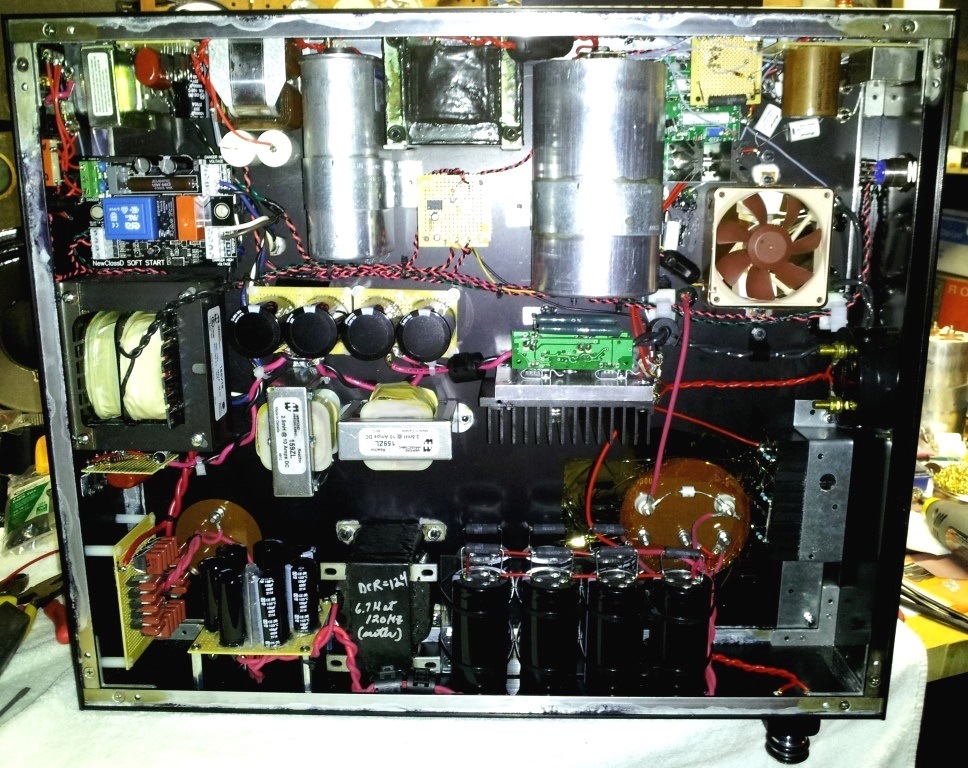

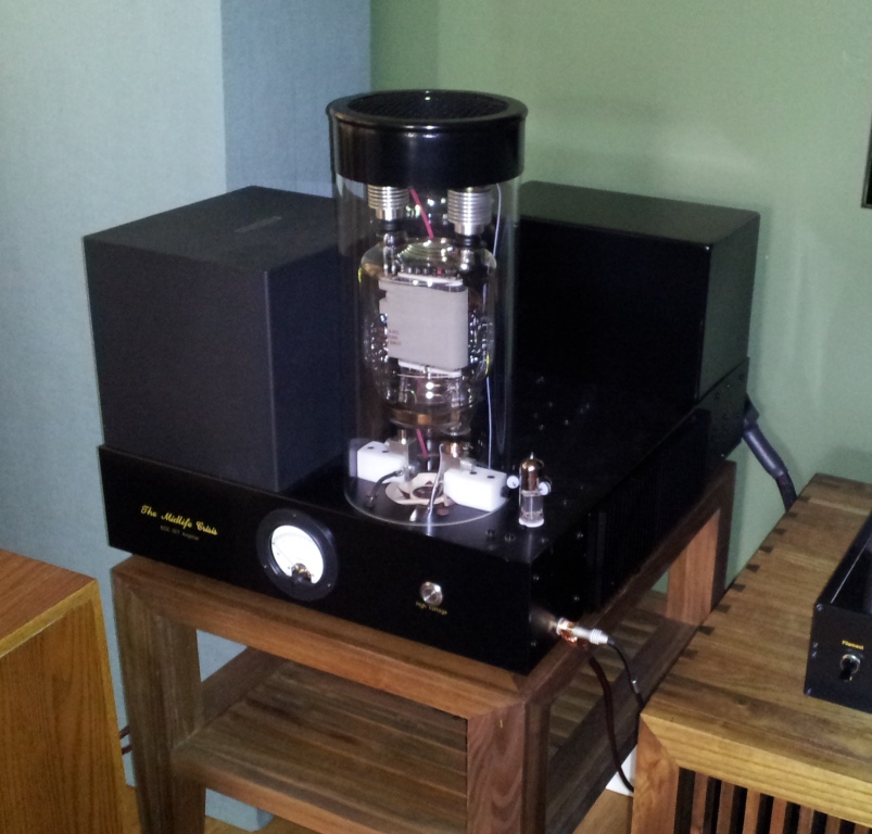

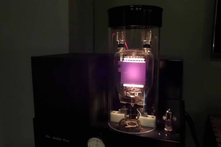

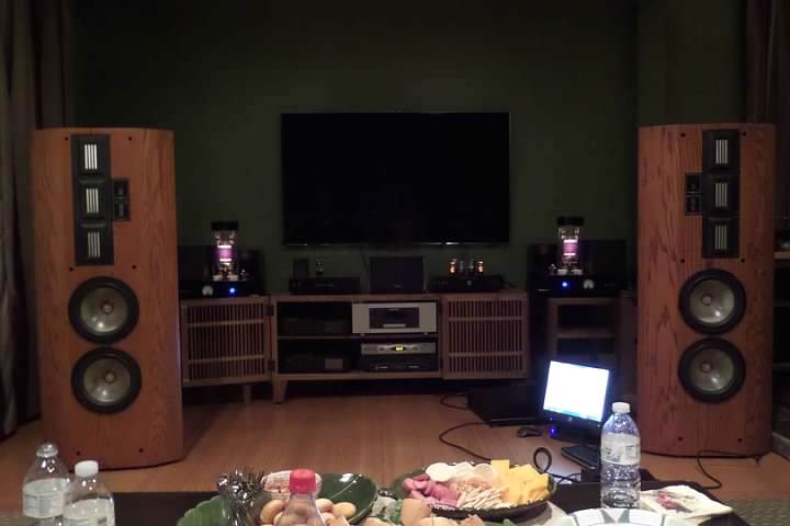

Yes, I do. Here are some more pictures. They drive the Infinity RSIIb speakers extremely well.
First picture is of one of the OPTs under construction.
Second is of the whole system playing.
Third is a closeup of a glowing 833C.
Fourth is the underside of one amp.
