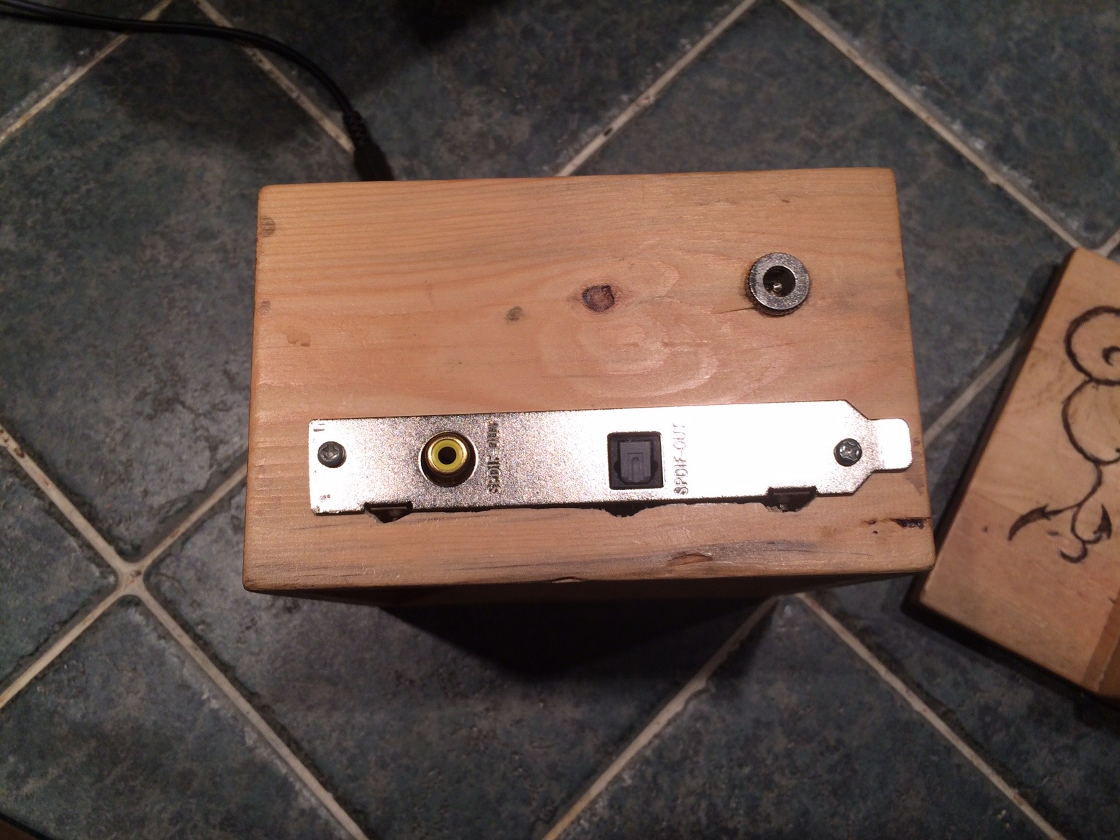

What kind of a USB cable did you use in the box?
How does the female end mount on the wooden box?
A mico usb cable that I cut on one end, stripped the wires, and soldered to the barrel plug. Only +5 and GND are soldered to the barrel plug.
Surely you didn't have to solder that? I had some ladies in the lab do some work for me on micro USB connectors and they needed years of experience and expensive equipment ( microscope with a TV camera ) to do it.
OR... do you just use the USB for power?
Yes, USB is for power only. Makes it easy to unplug from switcher and plug into PC if needed.
Another thing... only one wire into the S/PDIF input... I assume the signal ground is provided by the USB then?
Yes

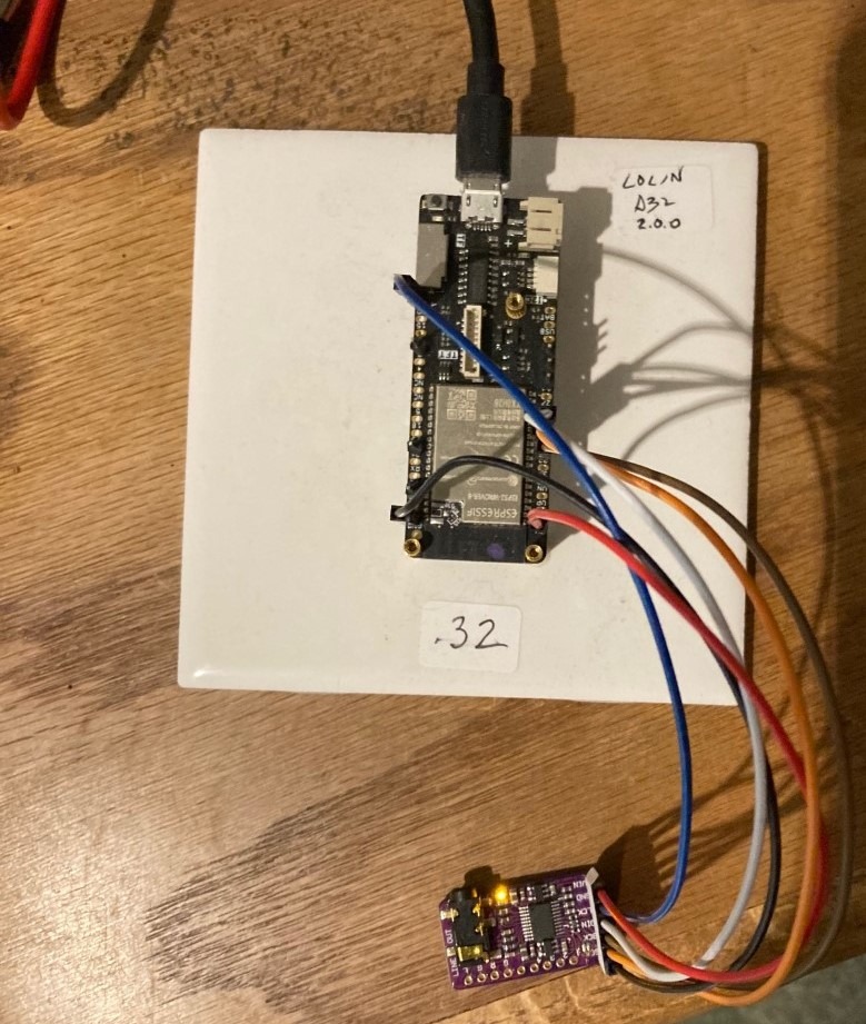

FWIW, the ESP32 can also output I2S. Here's an example connecting the ESP32 to a PCM5102A. Even though the ESP32 can provide MCLK, I prefer to ground the SCK (MCLK) pin of the PCM5102A, which triggers the chip to generate it's own SCK from it's internal PLL based off the BCK coming from the ESP32.
Do you solder the wires? Are push in connectors, or even Molex connectors, available?
Where is the analog signal output?
it'd be interesting if you could put in a switch that allows you to control the SCK source.

I soldered the wires to the ESP32, but only soldered female connector to the DAC.
It's the 3.5mm jack. There are also via's along the side to connect to RCA jacks.
If the PCM5102A doesn't sense a valid clock on SCK (if it's grounded), it will revert to it's own PLL. I guess one could have a switch to toggle between a MCLK and ground to allow for a four wire vs three wire input.
