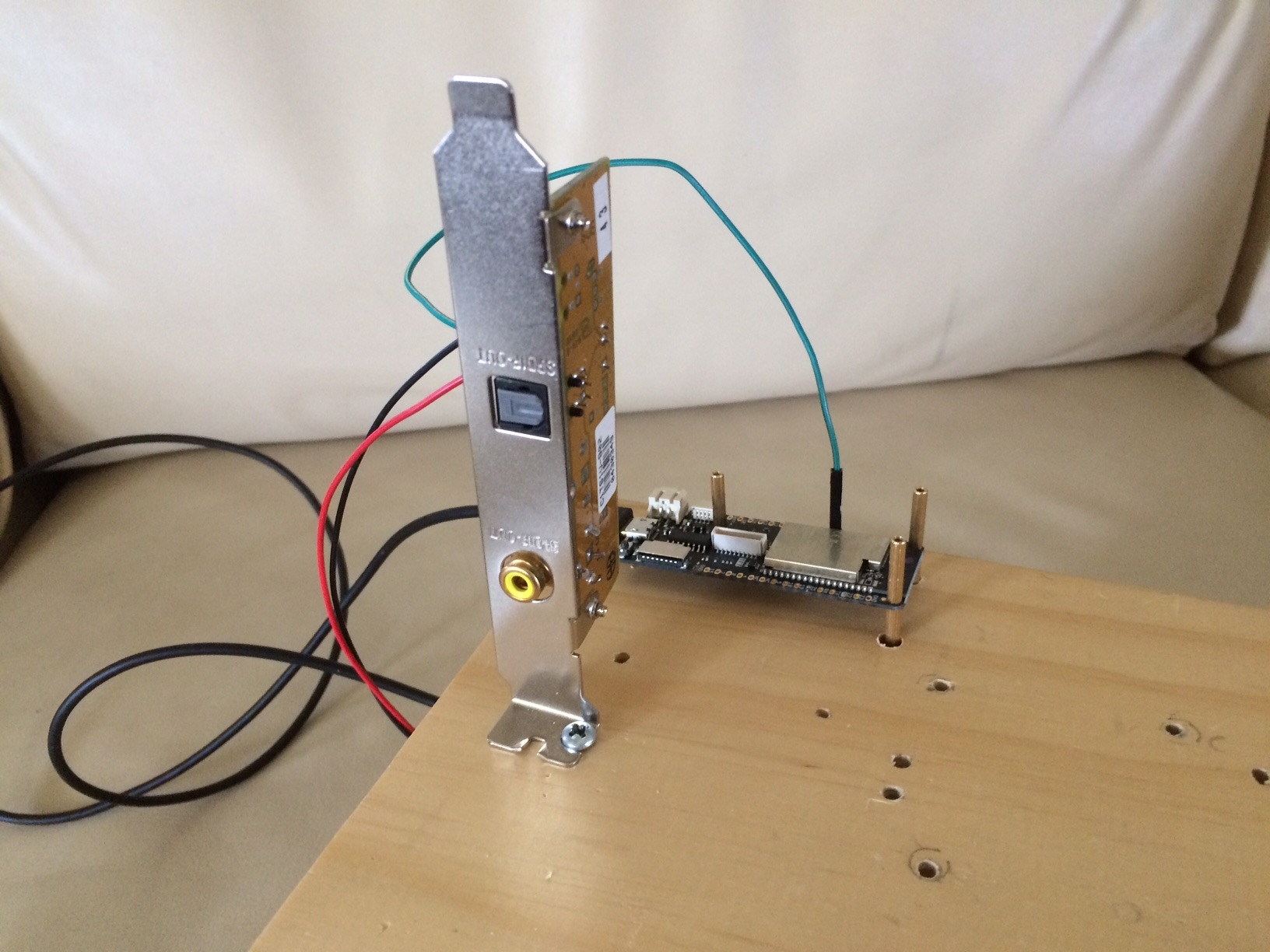

The reason I ask is I'm a LMS/Squeezelite fan. I run LMS on my Windows PC and Squeezelite on an ESP32. I bought an S/PDIF bracket normally used to attach to a PC motherboard and connected it to the ESP32. Granted, it's best used up to 16 bit/96khz, but for streaming that's plenty for me.

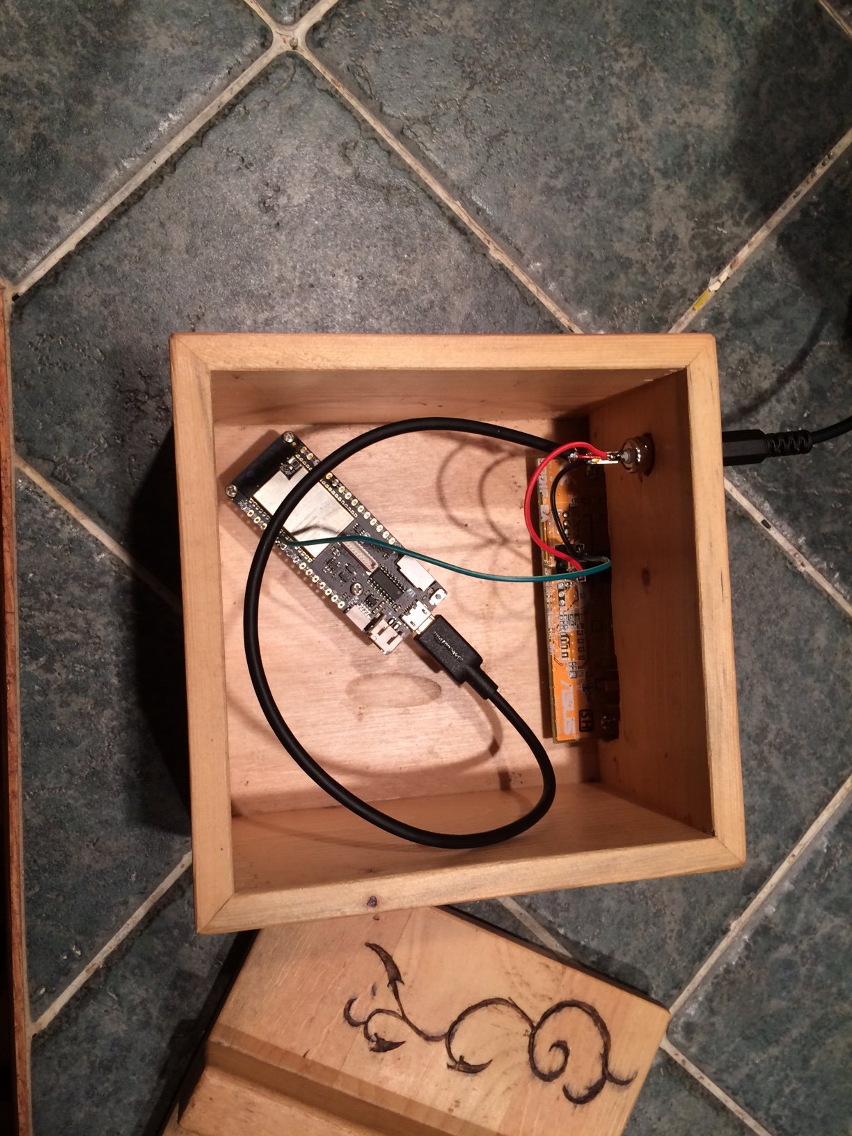

Here's my test setup. I ended up mounting these in a small wood box. It was a fun DIY project.
The micro usb on the board is used for both firmware loading and power. The power supply is a 5V switcher into a barrel plug, then a micro usb cable (two wires for +5V and GND) into the board. If I need to reflash the board I disconnect the power cable and plug the board into my PC.
The only wire from the board is the data. +5V and ground wires from the barrel plug to the S/PDIF bracket.
What kind of a USB cable did you use in the box? How does the female end mount on the wooden box?
Surely you didn't have to solder that? I had some ladies in the lab do some work for me on micro USB connectors and they needed years of experience and expensive equipment ( microscope with a TV camera ) to do it.
OR... do you just use the USB for power?
Another thing... only one wire into the S/PDIF input... I assume the signal ground is provided by the USB then?
