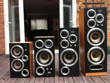

Hi phivates!I found Foster domes in a KEF C-20 (I think). And Radio People Wharfdale 70's in a local thrift store, from the mid 60's.
You are, of course, referring to the earlier Wharfedale W70 speakers rather than the later E70 high efficiency speakers which employed Foster horn tweeters.
Photograph from:Home - wharfedale-e-series-speakers-specialists
