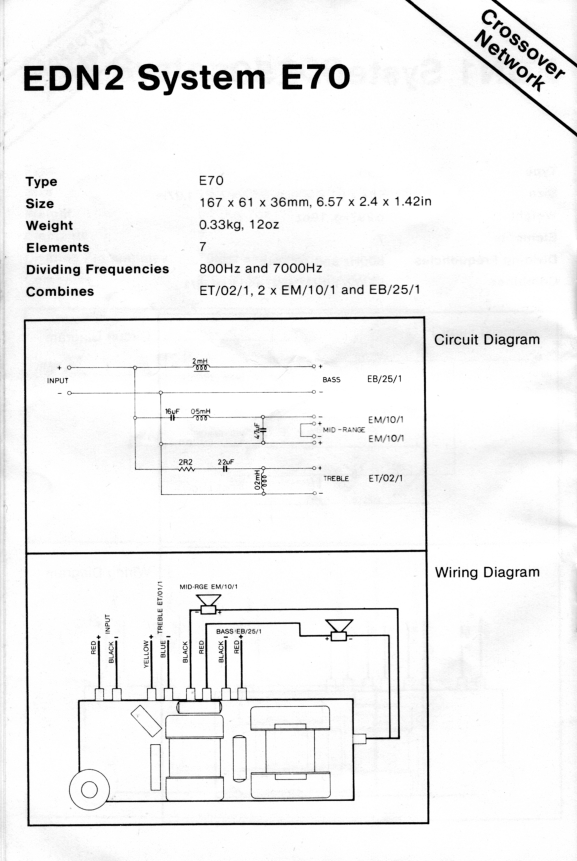

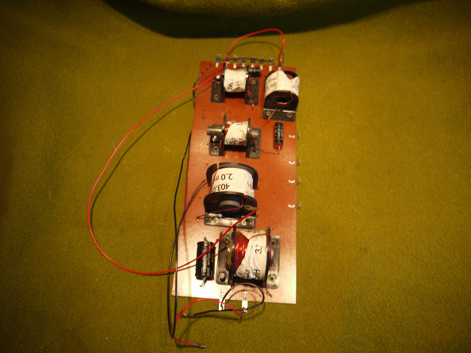

The commercial E70 crossover is a bit more complex than the kit crossover as it does some response shaping.
The suspect crossover does not have the correct crossover frequencies. In the Speakercraft booklet, these are stated as 800Hz and 7000Hz.
You appear to have been sold a pup!

IIRC, Steve's xover is correct. The other 2 inductors are to do with the twiddle knobs which are unnecessary. E70 does VERY well in DBLTs even on classical music and this is with the knobs at full.
The important inductor is the 3.25mH feeding the bass. The original has a short 19mm Diameter ferrite core. Don't use the cheapo (?) ones you can buy with long 9.5mm D cores. Better still, use an air-core but this will be BIG. The 0.2mH & 0.5mH should be air-cored like the original.
Replacing the caps with films is good.
If you score an E50 with a mangy cabinet, consider re-housing the bits in an E70 box of 3/4" ply with the treble above the single midrange. Better all round.
Yes, I believe that is the case. 😱

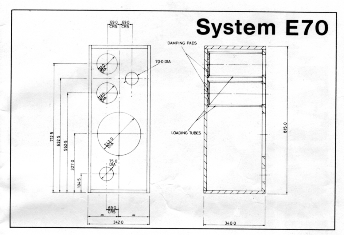

I can supply the Wharfedale Speakercraft enclosure plans should you require them.
That is very kind of you. It would be useful as I have only a couple of images of a Speakercraft brochure. Does it include a circuit diagram of the xover?

The kit crossover is the same as the one shown by Steve, but has two component value differences which I identified in post #39.
IIRC, the 2mH bass inductor feed and 2R2 treble resistor feed are correct.
Old Bones, the only tip I can think of at the moment is to build the cabinets in handed pairs with the treble units 'inside'.

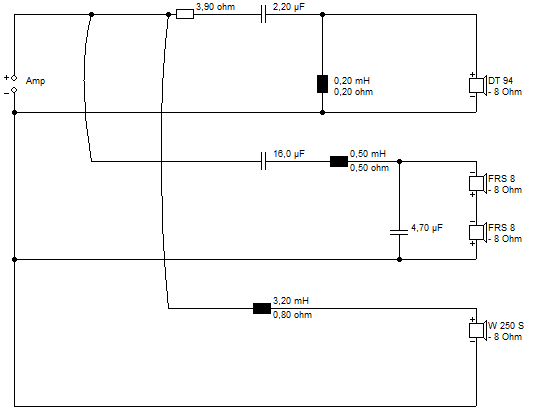

Now I am totally confused.
The inductor values I have before me don't agree.
Bass inductor- 2mh, 3.2mh, or 3.25mh
Mids inductor- 2.0mh or 0.5mh
Treble inductor- 0.2mh or 0.5mh
I have found these values from various sources including photos of an actual crossover.

No need for confusion at the moment on the crossover front. The kit version shown in post #50 obviously worked adequately well with the original kit drivers and forms a basic starting point for experiment.
Have you noted kgrlee's confirmation about the values of the bass inductor (2mH) and the treble resistor (2R2)?

Bass is 2mHBass inductor- 2mh, 3.2mh, or 3.25mh
Mid 0.5mH
Treble 0.2mH

And you were also recommended this crossover circuit to match those particular units listed above - is that correct?"I have these units which I was led to believe would be equivalent or upgrades to the original Wharfedale drivers."
Old Bones, who recommended this and the drive units to you?And you were also recommended this crossover circuit to match those particular units listed above - is that correct?
There's loadsa info I need to digest from your drive units but here is a first stab.
- Monacor unit is FAR too soft. Try the unit I suggested.
