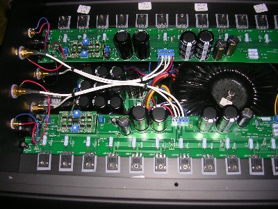

In a fully balanced design such as this that is biased well into class A I am not sure that such things are of a religious concern.
The point of posting these images is to point out why in hell would you want to mess with it.
Anyway I think its a work of Art.

Sorry, you are right ofcourse! If I had an original, I wouldnt modify anything....
macka said:Dude,
Those caps are fine and they are strategically placed where they need to be. While there is nothing small about 10,000 uf, multiple use of these at the high speed rectifiers and on the board right next to the output stage is brilliant. The transformer is a whopper and a Plitron no less!
iMac
First, thank you for taking the time and share the photos with us.
Assuming yours is X250.5 and not the X150.5, then I'm confused. The caps shown (50V) do not add up for 250W/8ohm, for me. From my rough cal., they should be rated >60V. Unless the thing is in balance mode at the output. I guess I'll never know.
"CN8": 2 larger white wires are the output.
2 smaller wires, red and blue, come straight the the rectifier's
output ? (or are they coming off from another bank of capacitors
from the bottom some where)
If direct, I strongly disagree with your statement. I highly repect the
designer of this unit. I admire his innovated designs. However, 20K for each rail at less than 50V is hardly enough (for me) for an amp at this caliper. There must be a reason somewhere.
I, also, repect what you're hearing. However, I still stand firm on my
previous posts.
BTW, when you say "they are strategically placed where they need to be. While there is nothing small about 10,000 uf, multiple use of these at the high speed rectifiers and on the board right next to the output stage is brilliant",
I assume you mean physically. The rectifier is approx. 10" away some where. IHMO, whichever the case, it's not an issue. Electrical distance is the thing. These have very low energy storage and by no mean low ESR (they are general purpose Panasonic as far as I can tell from the pictures).
The way it looks, if I have do it myself, I step up to 40-50mm (low ESR) size caps assume the current ones is 30-35mm caps. Go as high as I can to the ceiling. While I'm at it, hang a couples of high quality film caps somewhere.
As they say, you never know until you try.
Regards.

if nothing else - thing is in balance mode at output .........
macka said:In a fully balanced design such as this that is biased well into class A I am not sure that such things are of a religious concern.
iMac
Thank you for answer my balance puzzle.
macka said:The point of posting these images is to point out why in hell would you want to mess with it.
iMac
Perhaps to achieve better sound based on one's preference.
With all respects, I don't share your view of x250.5 being the best sounding amp neither, as I sense. What about the newer XA and XA .5 series amps. Are they for better or for worse ? What I'm certain is they correct some short falls of previous series. IMHO, it's all about best compromises. And I truly admire Mr. NP for his compromises to seemingly make their products highly musical to happy customers.
Now that's business.
Regards.
Thank you.
BTW, what does this mean
I should have look more closely at the PCB traces lead to the output wires. So, balanced output, 3 pairs each phase !
Regards.
PS (to all): who owns one of these things. I don't. Just try to be helpful.

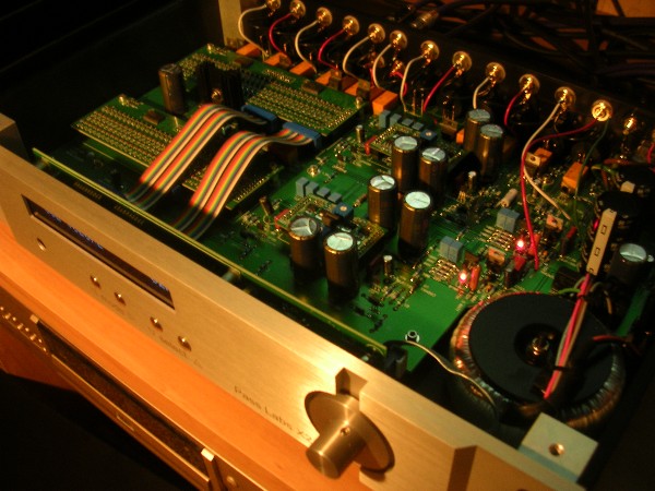

As a foot note and for the benefit is diy_Qui who appears to be unfamilair with the product there appears to be a total of 100,000 uf filter capacitance per channel in this model with local bypassing of 2200 uf if you care to count.
By virtue of a soft start device and a clever stand-by circuit the capacitors remain charged after initial switch on.
Mert,
Here is the X2.5 preamp which is quite compact and functional.
iMac
Mert,

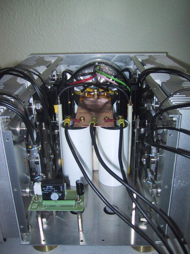

macka said:As a foot note and for the benefit is diy_Qui who appears to be unfamilair with the product there appears to be a total of 100,000 uf filter capacitance per channel in this model with local bypassing of 2200 uf if you care to count.
Current product uses 180,000 uF.
Hey guys!
those are some schweet pics!
Steenoe,
those are my kind of heatsinks AND caps! I briefly looked for Rifa in the US a few years back, here they go by Aerovox and it's not the same stuff. Anyways I could never find the supplier. Where do you get yours?
As for the 250.5 the balanced design allows to keep the PS voltage lower for the same amount of power, so 2x50V is plenty for a 250W amp.
The last time I heard a Pass Amp was a 250 hooked up to the open baffle proac speakers (don't remember the model) and it produced the best sound in the whole audio show. I think the speakers were not well designed since the scan speak woofer unit was moving +/- 10mm still the whole thing sounded great.
I imagine the .5 version would be giving better highs if nothing else.
Steenoe,
