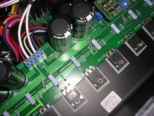

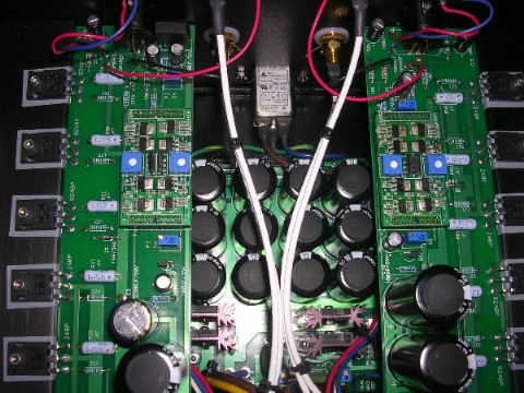

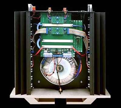

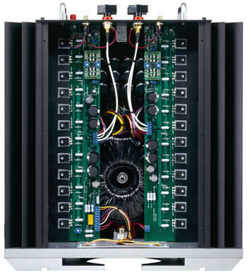

However, take a look at these photos I collected online.
It appears the X250.5 is special (or odd) compare to the X350.5 and X150.5. (assuming these photos are correct. You can certainly verify for your self). The packaging is different compare to the other 2 (PCB mount caps, unless the large, screw-mount caps are under the output PCBs). If this is the scenario, the only way to go is up (higher value capacitors with same diameter footprint). And, de-soldering/soldering skill required. If it’s the X350.5/X150.5, it’s a walk in the park for any experienced DIYer to replace the screw-mounted caps.
Caution: Usually, Pass Lab. uses a varistor to limit in-rush current during start-up. If it is the case, I suggest, as a guess, new total capacitance does not exceed 150-200% of the original. Certainly, higher in-rush rating varistor can be in place, but requires more digging. While you’re at it, by pass the rails with some high quality film caps in the order of sub micros. Sonic Craft’s THETA (here, in the Sates, you can get them at PartExpress, but no idea where on your side of the world) is what I’m familiar with and use which are excellent and does not empty your wallet like other exotic brands.
Caution: Now a day, caps are also counterfeited by Chinese manufacturers. Especially, Electro. Caps. One way to be sure is getting them from reputable vendors (Newark, Digikey, Mousers,… RS Component, Farnell, ELFA are some others on your side).
Caution: This mod will also increase (I think) the rail voltages a little (1-2V perhaps, depends on the final total capacitance values). As I’m not familiar with Pass’s topologies (and never able to afford their products beside the ALEPH P I had years ago), do other experts care to comment on effects of this increase ? My best guess would be minimal. Perhaps, it will raise the heatsink temp. by sub degree.
Caution FINAL: So far you’re advised to not mod the unit. I just suggest IF you’re absolute must. Certainly Pass Lab. will not, for sure, honor such actions. For having said that, be extremely careful when putting the unit back together since, from the look of it, you have to almost dissemble the thing to get to the caps’ PCB. Including unscrew those TO3P transistors on the heatsink. And, tons of cables/wires disconnect.
My guess, you have to spend a few hundred bucks for the caps (and tons of hours) for this mod. At the end, my gut tells me, it pays a lot more compare to the exotic power cable you installed. (BTW, I noticed from the photo, Pass Lab. Has already installed an AC filter to clean up the gabbage coming in. Did you notice any (noticeable) difference with this cord ? Just curious.)

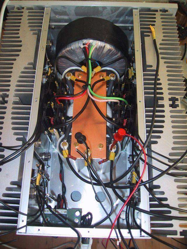

Here is a pic of my Aleph-X psu..... Dont think, that I think, that I am better than NP!!! Ever.... Nonetheless, here you are....
Dude,
Those caps are fine and they are strategically placed where they need to be. While there is nothing small about 10,000 uf, multiple use of these at the high speed rectifiers and on the board right next to the output stage is brilliant. The transformer is a whopper and a Plitron no less!
