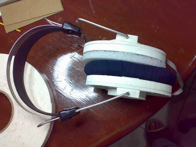

I've looked at that article a few times on Headwize and your version looks very
professional.
A note on the bass response...
It looks as if you are using some kind of felt to cover your ear pads. I would strongly suggest
using leather or pleather (fake leather) as it creates a better seal with your head. I have experimented quite a bit with headphones(dynamic, orthodynamic, electrostatic) and switching earpad materials has a profound impact on the sound. Stax uses leather on all of their ear pads
and I suspect it is for this reason.
Good luck!

Dear Vaughn,
I have nothing to complain about the bass response. I love it. It is far better than other headphones that I have.
About the ear pads, I use insulation material which I find from the left over around my house. It is like a plastic sponge. Although it doesn't feel as comfortable as the real sponge, I find it to be acceptable. I cover it with plain cloth. Yes, I think leather should be good for this application. However, it is quite difficult for me to source for it.
I really think that the diaphragm material makes a lot of difference. I have bought a small amount of 1.5 microns and 0.9 microns mylar, and they should arrive very soon. I will try them out and let you know how much difference they make.
Wachara C.

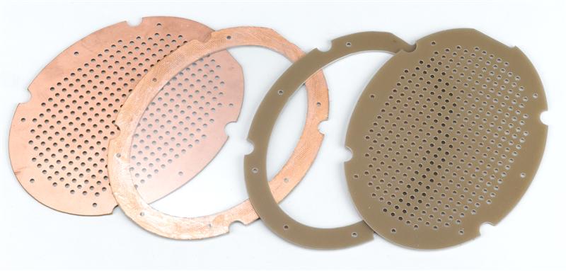

Ok, the attached photo shows my version of stators and spacers.

A greater open area gives a better frequency response (at my mind !), but performance depends on a lot of factors.
