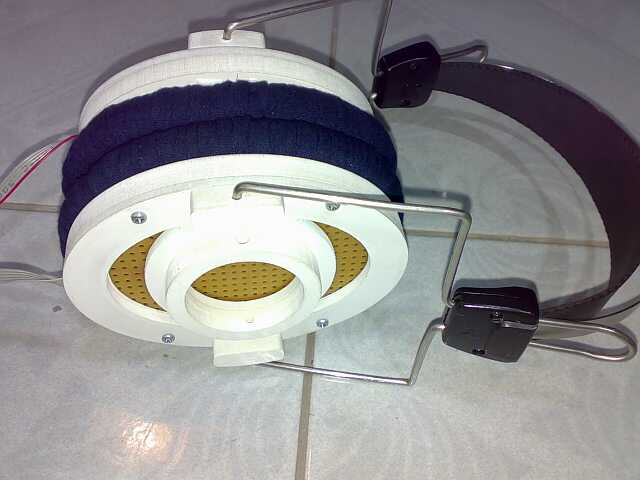

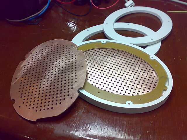

I tested a 0.4 mm spacer with food wrap plastic as diaphragm. I have to say that I am now very confused. I can't get any sound at all at 600V, 900V or even 1200V. I check and check for any mistake that I might have done and I couldn't find any.
My configuration now is 1mm stator, 0.4mm spacer, diaphragm, 0.4mm spacer, and 1mm stator. I coated the diaphragm with graphite powder this time.
Is it possible that the diaphragm was suck to one side? How can you tell if that is the case?

or, there was no contact between your bias supply and the diaphragm?
you could try holding it up against a light bulb. if you have the correct angle you can see the diaphragm, maybe this works?

It's all my own fault. My conductive material doesn't contact with the diaphragm very well and therefore no electricity goes to the diaphragm. I also have a problem with my 0.4 mm and 0.5 mm spacer. I have tried a few type of glues and they don't stick to the diaphragm well. I now go back to my original spacer which is 1 mm thick and I am using around 1200V as bias voltage.
I've just found out also that I had a mismatch of impedances between the output of my amplifier and the input of my headphone. I now use 4 ohm output tap from my 2A3SE to drive the headphone and it is now singing beautifully.
I am still searching for a thinner material to use as spacer and also a thinner mylar. But as for now, I'm happy.

I tried with lower volatges. At 900V, using a 2A3SE amp and a preamp, the headphone sounds OK. But with 600V, the sound is a little too soft.
Well, good to hear that you make progress!
try to find a thinner diaphragm, and spacers in the 0.5 - 0.6 mm region, and with around 600V bias and either a nice step-up or (better?) a direct drive amp you will see what is really possible with electrostatic headphones...

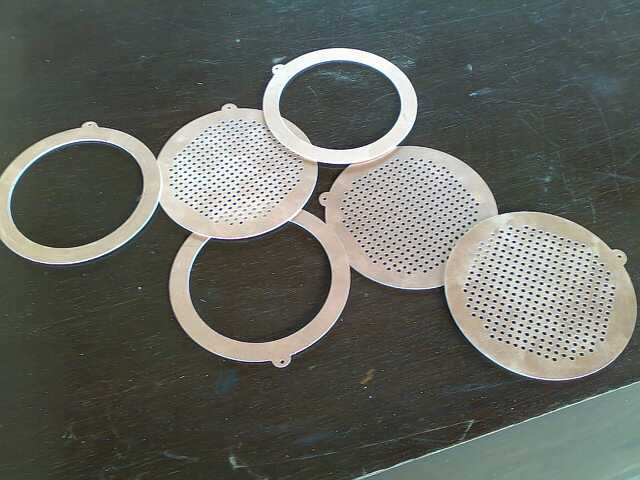

I´m going to get my coated stator sheets today. I´ll try 1.2µm film.
The improved bass response could be a matter of ´creating´ a small closed chamber between membrane and head by using the cushions.
Measured freely a lot of HPs have a falling response below ~100Hz.
Its the chamber formed by the cushions, the membrane and the head that ´improves´ the bass response.

The thickness of the diaphragm really does make a difference in the low frequencies response. I started my 2nd version with 11 microns diaphragm. Only later that I was given the 6 micron mylar by a friend. With everything else stays the same, the difference in low frequencies is just too much to go unnoticed.
Where do you get the 1.5 microns material from? I really like to try.

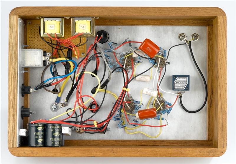

Hi Atarashi,
The amp directly drives the headphones. I got the circuit drawing from http://www.tubecad.com/november99/page8.html . It sounds really wonderful.
I hardwired the amp, since there are not so many components.
Wachara C.
Wachara C.

I used graphite powder, and it worked very well. I also have got a can of graphite spray. It seemed to stick to mylar quite well. I haven't really given it a try though.

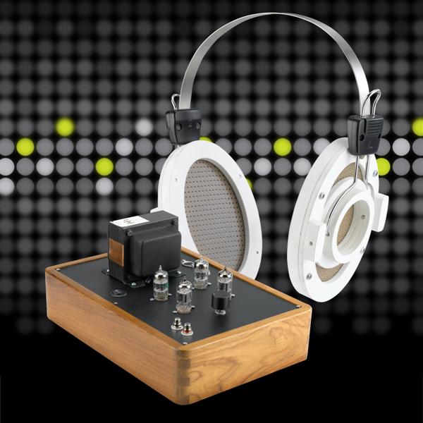

Nice work!
Have you machined the "frames" for the head phones with your CNC as well ?
What material did you use?

Yes, I machined the frame using my CNC as well. It is only difficult when I first design it. After that, the machine does all the work for me. The material is plastic. I use 5 mm for the back cover and 10 mm for the front cover. I got the plastic sheets for free from my friend who uses it for making sign board and advertising stuffs.
I really like your ESL, and I'm going to make a pair similar to yours.
