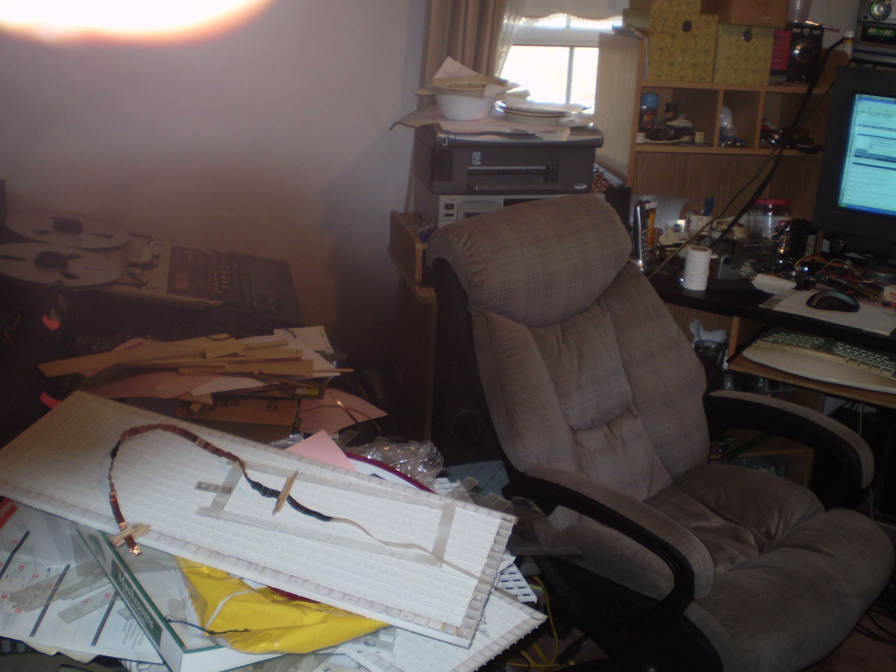

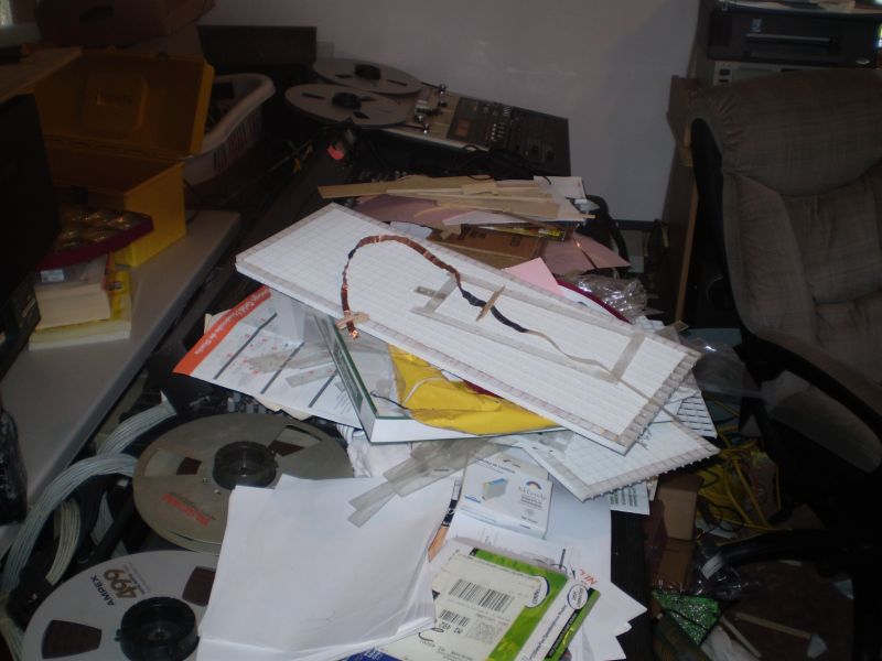

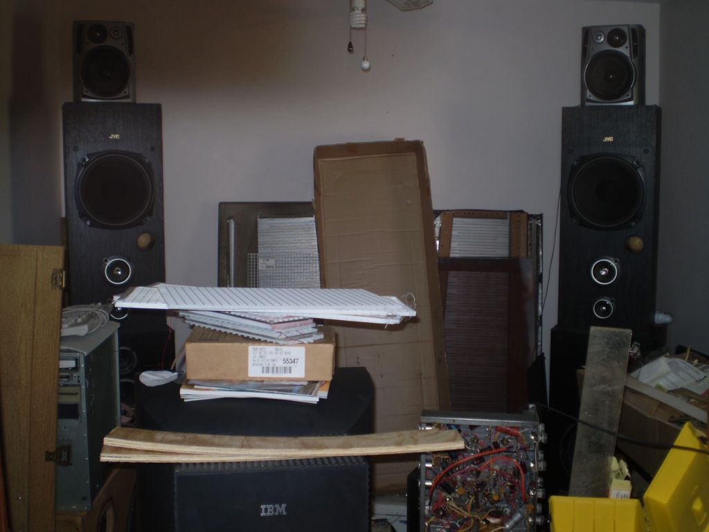

I have been contemplating something just like this for quite some time.
I'm just not sure how to go about deterimining and predict the horn shape and dimensions.
It can't be that hard though.
I guess the best way is to just do it and see what comes out.
I won't be able try any thing yet as I have to finnish setting up my equipment and iron out A few minor bugs.
Clean the place up so that I can have some room to work In.
As well as build two of my variable bias supplies and put them in a proper box so that the H.V. doesn't find it's way back into my equipment.
Like it did last year. jer
