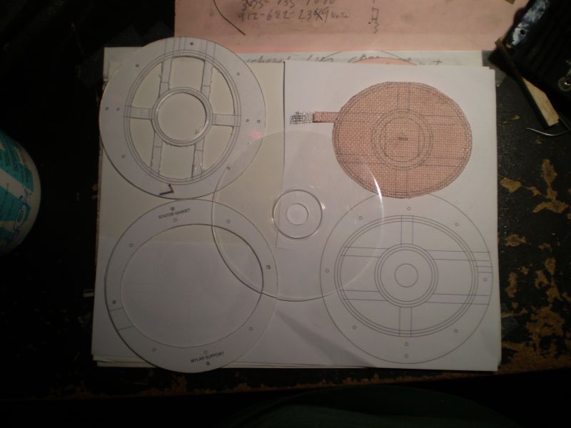

I finaly got around to start constructing some headphones.
I have already designed a direct drive amplifier for them as well using 4 fet's and two dual opamps(times two ofcourse).
I just need to get some hvfet's,although I have learned to stack the low voltage ones as well.
Mean while the transformers are standing by.
They are designed to be taken apart and reassembled easily so that different diagphram types can be swap out as well as d/s spacing adjustment by adding gaskets.
Also I will incorperate a slide plugin that will slide into the side of the frame sandwich.
I drew it up in tiny cad (a free program) and can easily change the shape and size of diagphram and just cut some new spacers (I just relised that my thinnest material is not wide enough by about an 1/8",oops!).
I have been thinking about using the shape of an egg for the diagphram area aswell.
Right now I am contemplating on a stator design as I have several options and finishing up the connector patterns. jer

Hi Geraldfryjr,
Your design looks nice. What material will you be using to make your stators? From the pictures it looks a lot like mesh wire.
Keep us posted of your progress, please. 🙂

yes ,my orginal plan is to use a wire mesh.
Recently I had discovered diy anodizing and was thinking about giving it a try.
Then as I was reading through this thread it was mention that a piano wire stator works good aswell and I have lots of 1/16" tig wire.
I also have some preforated aluminium with 3/32" holes on 3/16" staggered centers that I used to build my very first panels.
In which case would probably okay.
However I was not particularly impressed with the transperency by doing a simple test of holding a peice of it next to my ear and listening to various sources at a low level.
I detected some sort of ringing and/or restriction in the sound passing through it.
This may not be an issue once mounted and coated.
This would be the easiest way to go.
But the window screen of course was undetectable.
I am currently trying to figure out how I can glue it to the support frame and keep it perfectly flat without it sticking to the construction surface while mantaining perfect alignment. jer
