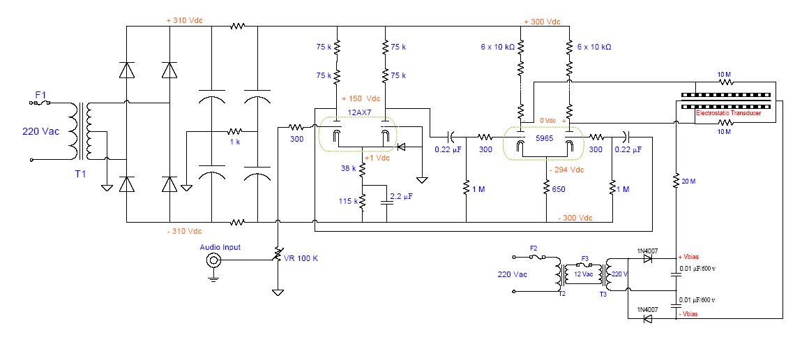

Hi Vaughn,
I'm glad to hear that you are still trying. Please take a look at the attached schematic diagram. IF you need any help, please let me know.

Hi Wachara,
I do have one question about grounding in this amp...
I see the input jack is shown with a traditional ground symbol. Should the other ground points also be taken to the same ground and grounded to the chassis/earth? Like the transformer center tap etc?
I think my transformer is fried🙁
I'm not sure exactly why but apparently there is an excessive current draw somewhere. As I said I had it playing for about 30 seconds when the transformer sizzled and smoked. I quickly shut it off but the damage was done. I now get no reading on the HT secondary and the 6.3V tap is low.
In the power supply the power resistors on the two rails are not marked, should they be a particular value or are they selected to drop the voltage to 300v?
I am about to order another transformer but I am hesitant to try again without being certain. My wiring is all in order as far as I can tell but it is possible I had a bad tube that took out the transformer.

Hi Vaughn,
I'm sorry to hear that the transformer is fried.
The resisters on the two rails that are not mark are for dropping the voltage to 300V.
The current requirement for the amp is quite small. I use a transformer with 100mA HT secondary, and it's very stable. If you have any doubt, please refer to The Tube CAD Journal, Electrostatic Headphones . That is where I got the schematic diagram from. Oh, please check also that you do not ground the negative supply of the diaphragm bias circuit. If you do, that might cause a short circuit.

Hi Vaughn,
I just looked at a custom wound transformer that I have been using to build this amp. I ordered a few of them quite sometime back, and they all worked fine. The transformer's HT secondary is only rated 50mA. I'm sure that you have a short circuit somewhere.

I've ordered a new transformer and will try to find the source of the problem while I wait for it to arrive. Here is a picture of the underside of the chassis, if there is anything glaringly wrong please let me know. I don't have the negative side of the bias supply grounded so I don't think that is a problem. It is quite possible that I grabbed a tube with a dead short out of my tube drawer to test this. Although I'm not sure how it would have played for the 30 seconds that it did if that had been the case...

Hi Vaughn,
I've tried to look at your pictures, but I can't seem to find the problem. I remember that you have actually played with this amp before you stopped using it a few months ago. Have you made any changes since last time?

I rewired the audio section of the amp to make it more compact/cleaner. It wasn't working at all when I put it away last but I discovered during the rewiring that I did that there were a couple of cold solder joints that may have been causing problems.
When I went to try it out this time (after reworking it) I inserted a 3 amp fuse into the fuse block as it was all I had on hand. This was an expensive mistake and the amp ended up using the transformer as a fuse🙁
I've got fresh tubes and a transformer on the way so I will give it another try when they arrive (with the appropriate fuse).

Isn't one solder lug touching the lower mounting nut on the upper left tube socket?
No, but it is close... about 1 mm away. I'll trim back the lead just to make sure.
I've been running an amp very similar to yours (fully regulated PSU and 6S4A output tubes running at +/-350V but the same basic topology) with a 100mA HT winding and it's also been rock stable for over two years.

It is up and running!😀
I looked back and was surprised that it has almost been a year since I began this project.
I received my new transformer and tubes and switched them out and the amp and headphones have been working flawlessly. I must have grabbed a shorted tube out of my tube drawer and had the wrong value of fuse when I tested last. An expensive mistake I hope to never repeat.
