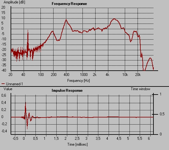

Maybe, in a dummy head, the square wave looks better.
I enclose a near field (5 mm) measurement of my Stax electrostatic EarSpeaker SR-80, not a pretty sight!
Read:
Learning Center - Build a Headphone Graph | HeadRoom Audio
