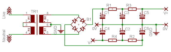

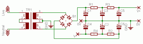

Thinking about my Aleph layout????
BP........I have tweaked your suggestion for power supply as
shown in image below................I want to reduce cable runs so I have flipped one supply rail...........is this going to work......

Hi, it looks like it should still work (as long as you add the AC at one end of each run of capacitors and resistors and take the opposite end for DC you should be fine), although, I'm not too sure why you needed to swap this round on the scheematic? If you are intending to do your physical layout in this way it should still be fine though, and should be intresting to see when you have things put together.
Supply
Thanks BP......I thought it looked OK......the reason I wanted this layout...was an attempt to make the internal wiring much neater.....I am basically having the + fets on one side of the amp and - fets on the other....I will post my Mk2 CAD layout shortly.......
