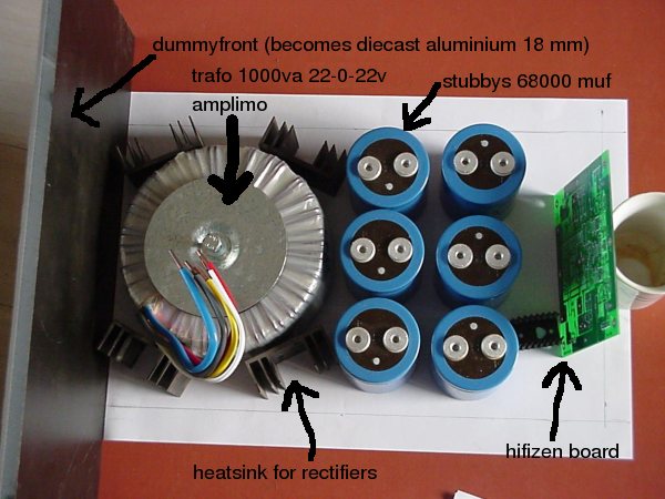

My space is tight as well..........take a look at my monoblock design....posted earlier......

Don't forget your Traffo,regulator, resistors, main board and caps will probably emitt arount 50-65watts of heat.....right in the core of the amp......these Aleph's are mean suckers.....

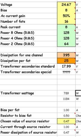

I was also going to go with D3s spec of 8A bias but what i am going to do now is start with a lower bias and work my way up as high as I can go without cooking anything with my current heatsinks, I will try to do this before the 8 weeks is up so if i think I need the extra bias i will order the extra sinks.

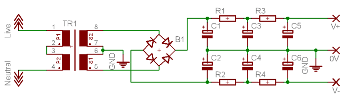

Regarding the power supply, would using 2 of Bigparsnips rectifiers (one for +ve rail, one for-ve rail) bring the voltage down even more than using one would? actually i dont think it would.

With say 20v and 8a bias......and with the sinks you have.....
you will have in the region of 90deg....ouch!!!!
You will probably looking at around 4a bias........keep the same no fets..........then up the bias later once you have better cooling.

Hi, if you do use two board for the supply (ie one for each secondary winding then conect the comon ground after this) you will indeed lose a bit more supply voltage, as you will have double the number of diode drops in there (so instead of having one per rail as you would have with the siingle rectifier, you will get two per rail insted, and so lose an extra 0.5 - 1 V per rail)
And richard, if you think your chasis is going to be a squeeze, just think how mcuh fun it should be for me tying to fit my mono blocks into a case more than half the height of yours (the internal space will measure only 330 x 345 x 69 mm, only just enough height for me to squeeze in my supply caps on their sides).

I think I am going to use a CRC PSU network. The R will be around 0.47Ohms. As discussed elsewhere, my main caps are 25V, and although I doubt there will be any harm if run at 26V, I would rather be safe than sorry. If the load (Aleph-X board) is removed, the PSU jumps from ~19V to ~26V. I had forgotten that I will need bleeder resistors to drain the caps. Won't this lower the output Voltage when used in conjuntion of the CRC network?

For the bleeder resisrtors to keep the output at the same level when the circuit is not conected, you would need to be drawing the exact smae current through them as the actual board. So, unless you want to have some very big bleeder resisrtors letting 8A or so straight through to ground all the time (and dissipating just as much power as you amp), I don't think that this will help you here.
Generaly, you would only have the bleeder resistors in there to drain the caps off, in a controlled manner, when the supply was turned off (a few tens of milliamps should suffice in most cases, although, it may need to be a bit more here as your caps are so huge).
