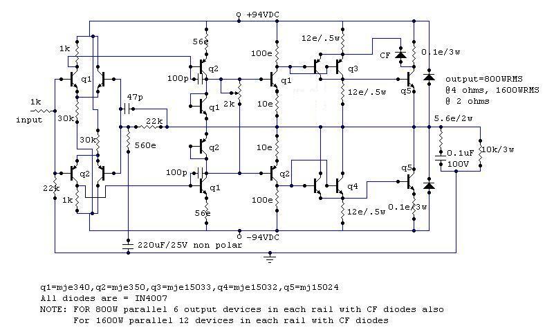

photos of amp I posted are of experimental stage.While wiring real amps I will try to use as thick wire as I could as per your suggestions.Regarding Rod Elliot design all I could get is this unclear picture.can I get clear p.c.b design.

Hi Vedmitraa
What Transistors You Will Use On Rod's Amp?

well as I told I have 50 pairs of mj 15024 - 15025 with me I want to use them.Even p.cb. of driving circuit will do .plus you trick of baising.

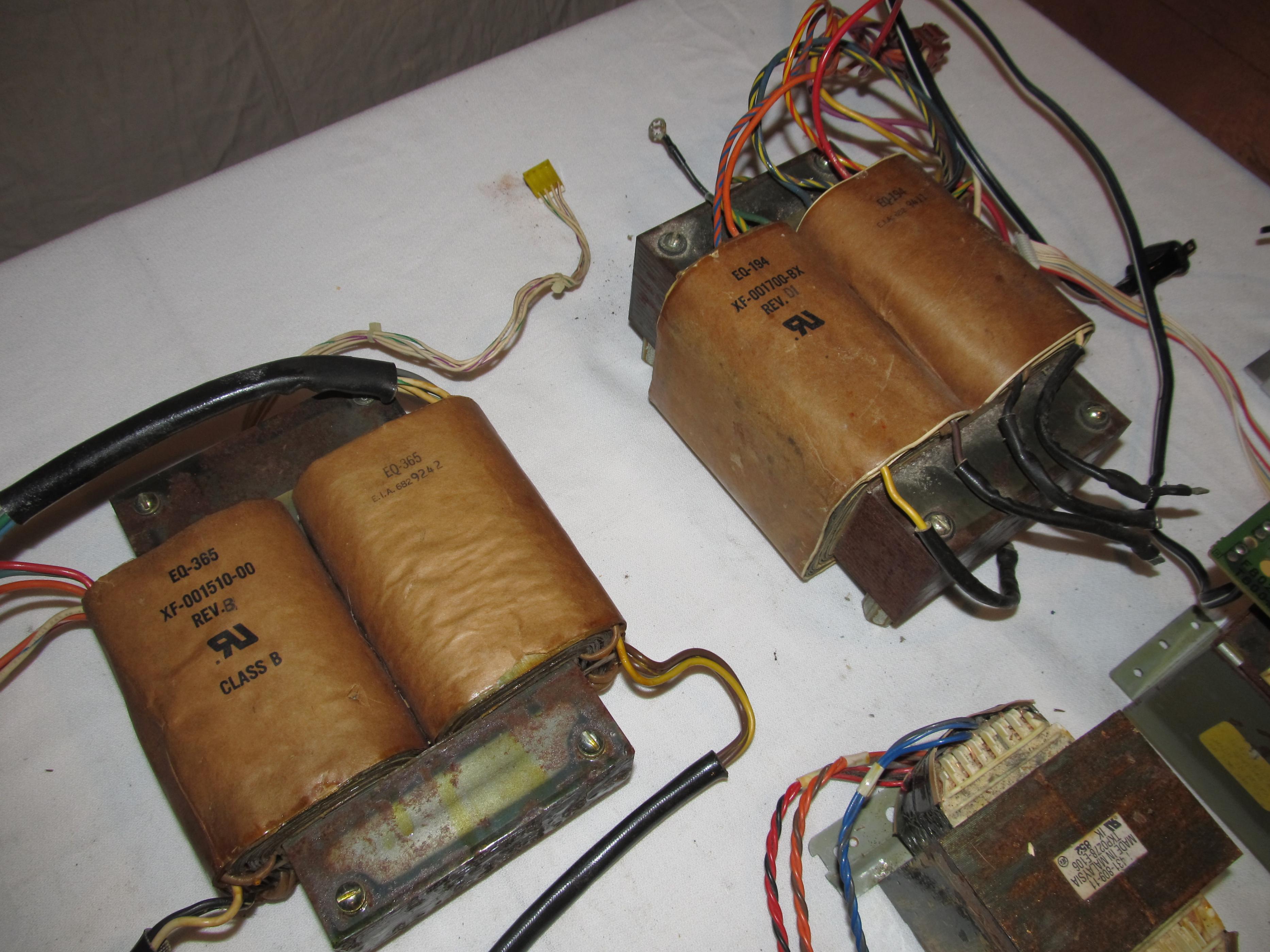

I have two large transformers from QSC amplifiers USA1310 and MX1500
I desire to build a large 500watt 8 ohm amp capable of 4 ohm sub work.
I like Workhorse design seems very roubust... lets continue this was getting intresting.
A posting of Rods revised circuit would be great too.
My transformers hit 95 volts after regulation, would love a great circuit for them.

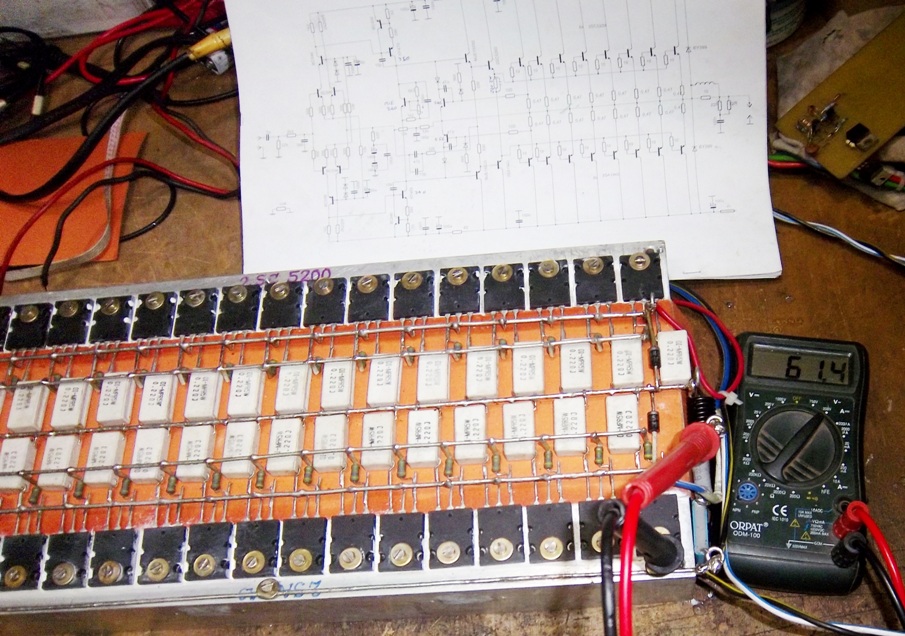

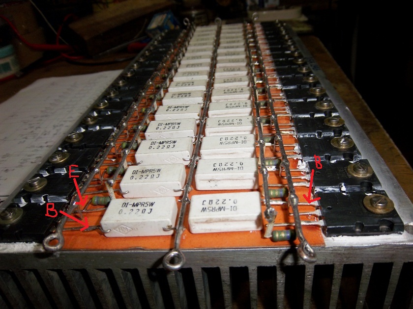

@ Sir Vedmitraa
Maybe you have done a mistake, as in the pic you have connected 0.22R resistor to the base of the transistor which goes to the output, and 4.7R resistor to the emitter of the transistor on both sides, Kindly check before powering up.
Aniket🙂
Aniket🙂
Thanks Aniket for pointing out the fault.that photo is quite old yeah there was this mistake but I rectified that mistake next day.Here is the photo of working amp with 1 ohm load and digital meter connected at output with test tone of 1khz.Meter is showing output voltage.
I am not familiar with any instrument at least like the ones shown in the picture that are able to measure correctly anything above 400HZ but may be i am wrong .....
I have used my cheap DMM @ upto and including 50kHz.
I use the comparison method when ever I need good accuracy and/or repeatability.
If I set up an input attenuator that exactly cancels the gain of the amplifier under test, then I can compare the input voltage before the attenuator with the output voltage after the amplifier.
I am comparing DMM Vac readings that are the SAME voltage and the SAME frequency.
If the DMM tells me the voltages are the same, then I believe it. Even when I know that the DMM is decades outside it specified operating frequency range. eg, the input could be set to read 2Vac at 200Hz and at 900Hz, but might read 1.4Vac at 10kHz and 525mVac at 50kHz.
Well I am not that much in theories but when measured with this meter it gave me 66 volts on 100hz ;61.4 volts on 1khz and 52 volts on 20 khz;on 1 ohm load at output signal voltage 1volt with my signal generator on sine wave and rail voltage 90-0-90 on load.

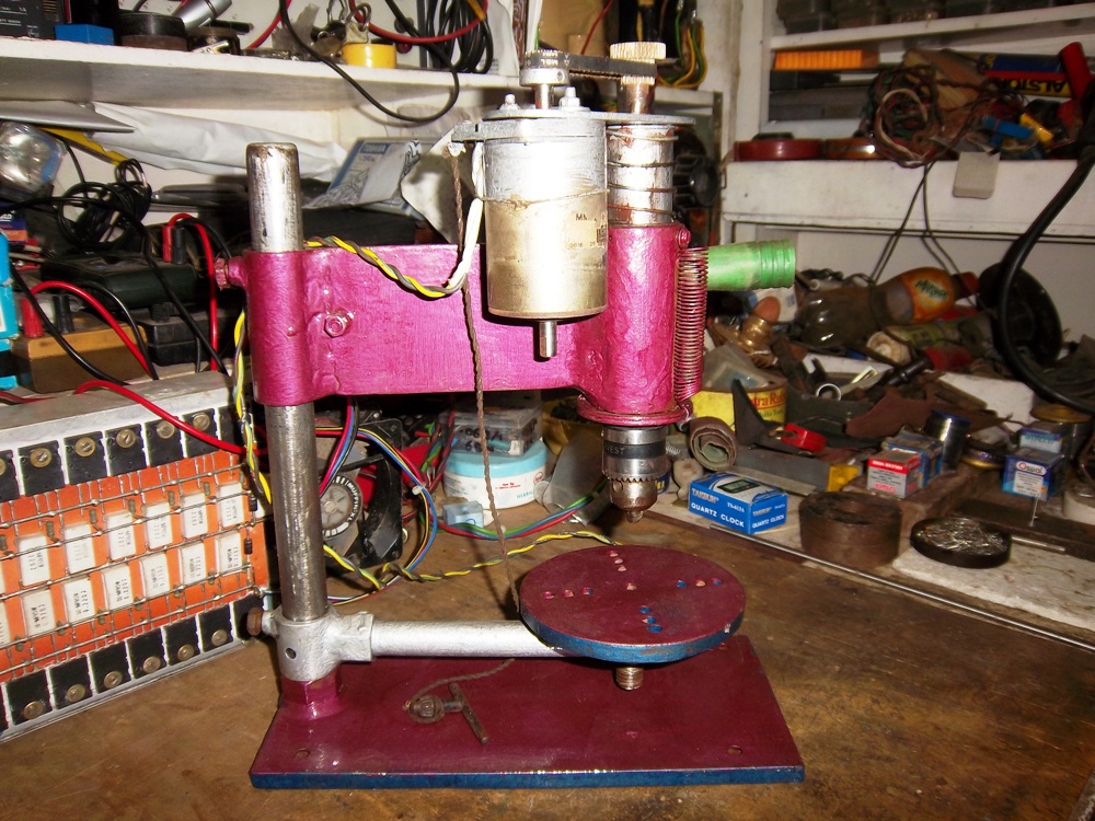

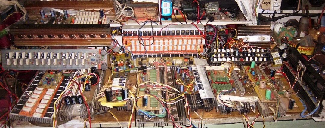

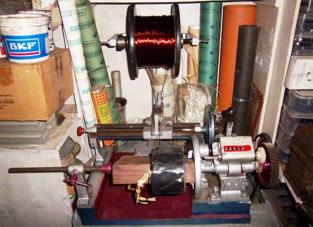

works I have been doinng
Thanks to all seniors in diyaudio because of them i could do this work ,some of my works photos,please see my page at facebook for more photos.
Vedmitra Sharma
Vedmitra Sharma

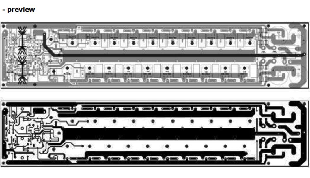

- Has any one built this 1KW amp?
