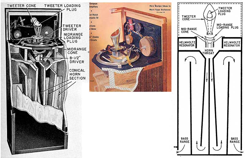

I know. But my idea tries to fulfill the same function.....eliminate the back wave. But not for a tweeter but for a woofer or subwoofer.A meta absorber is a bunch of quasi-random quarter-wave resonators.
Maybe my question shouldn't focus too much on the "boffle" but more on the CLD element.
If the back wave has to travel through some kind of maze (later the shape and nature of this maze could be discussed....it could be chambers, straight, tapered, open, closed....) made up of CLD material walls (uniform or varied thickness/compliance) what would that do?
How much sound energy can it absorb? And in what frequencies? What would determine the absorption frequency range?
Instead of a boffle I could imagine a long tapered channel (b&w nautilus style) with CLD walls that is folded into a rigid box. The narrower the channel gets the thinner and more compliant the CLD wall gets.

That is the point of a labyrinth, more practical applications are aperiodic transmission lines.

The CLD is for building the box and to keep inside noises inside. The maze you describe was first implention i saw was in the Hegman One, the idea seen in a gestation in the Eico-Hegeman zz9more a quarter-wave variant) from the diagram.
Hegeman 1, i’d ever seen insides like it when i pulled the driver and stuck my head in …
https://www.stereophile.com/content/hegeman-model-1-omnidirectional-loudspeaker

Also need to metion there was a Seaker Builder with an article on a simple LF “meta” structure with the basic math.
To apply to the maze of varying length & cross-section quartre-wave pipes out the back, and damping is an intriging idea. A side effectwould be a really ridgid "box”.

Largely the same kind of thing as a stuffed box.. if you can manage the line.If the back wave has to travel through some kind of maze (later the shape and nature of this maze could be discussed....it could be chambers, straight, tapered, open, closed....) made up of CLD material walls (uniform or varied thickness/compliance) what would that do?
Unless you are trying to lower the reasonance Q, there is no need to remove the driver back wave if it isn't modal. The boost in resonance Q is harmless as long as it's the response you need.
No it has to be "transparent", in original they used that brownish felt ro packaging vacuum tubes.My question is this, wouldn't it be better to use CLD material (constrained layer damping) in stead of felt curtains......or CLD material covered in felt?

Would it be an idea to use multiple baffles of rigidly supported, perforated steel mesh - using the resistance of the air passing through the perforations to gradually absorb the back wave?

If it is made as frames with felt on the sides, which are in contact to the walls - Yes. Like it is on the plan from hartley. Frames has double role, to made felt contact suface and damp walls slightly, and first role is to make same distance for rounded felt holes...Does it just reduce unwanted resonances or does it also support bass output compared to a uframe?
It is not primarly connected with bass since that is small distances and areas, but more to the lowmid and central BW - somehow make it more clear. Without felts it is somehow "muddy"...
The key point for hartley patent is that material has to be semi transparent. And rigid in the same time to mantaint straight areas withut bendind as much as can be.
So my tip for best experimental construction is:
Make frames but smaller than inside frame dimensions. Count in the space from brace to wall to be fit 2-3 thin felt material usualy 2mm when pressured. AND alu thin mesh to carry on the felts and to form straight surface.
Frames widh calculate for same distance between the felts...
Then cut out the different diameters in felts and attach it to the frames with aluminium mesh.
You can put one or more synthetic felt sheets. It ias easy to find that in the stores.
Philips noted about the name for matherial they used in PHI plans, I dont know it by hearth now, but I am sure that is noted. On the other hand I think that is obsolete, because I tried to find when I made mine... 🙁
Anyway it is almost a must for open bafle U or H frames. And I am pretty sure that can be used in expanded form
of Mesh Potato sound disperser for OB. In front and behind the central speaker. 🙂
