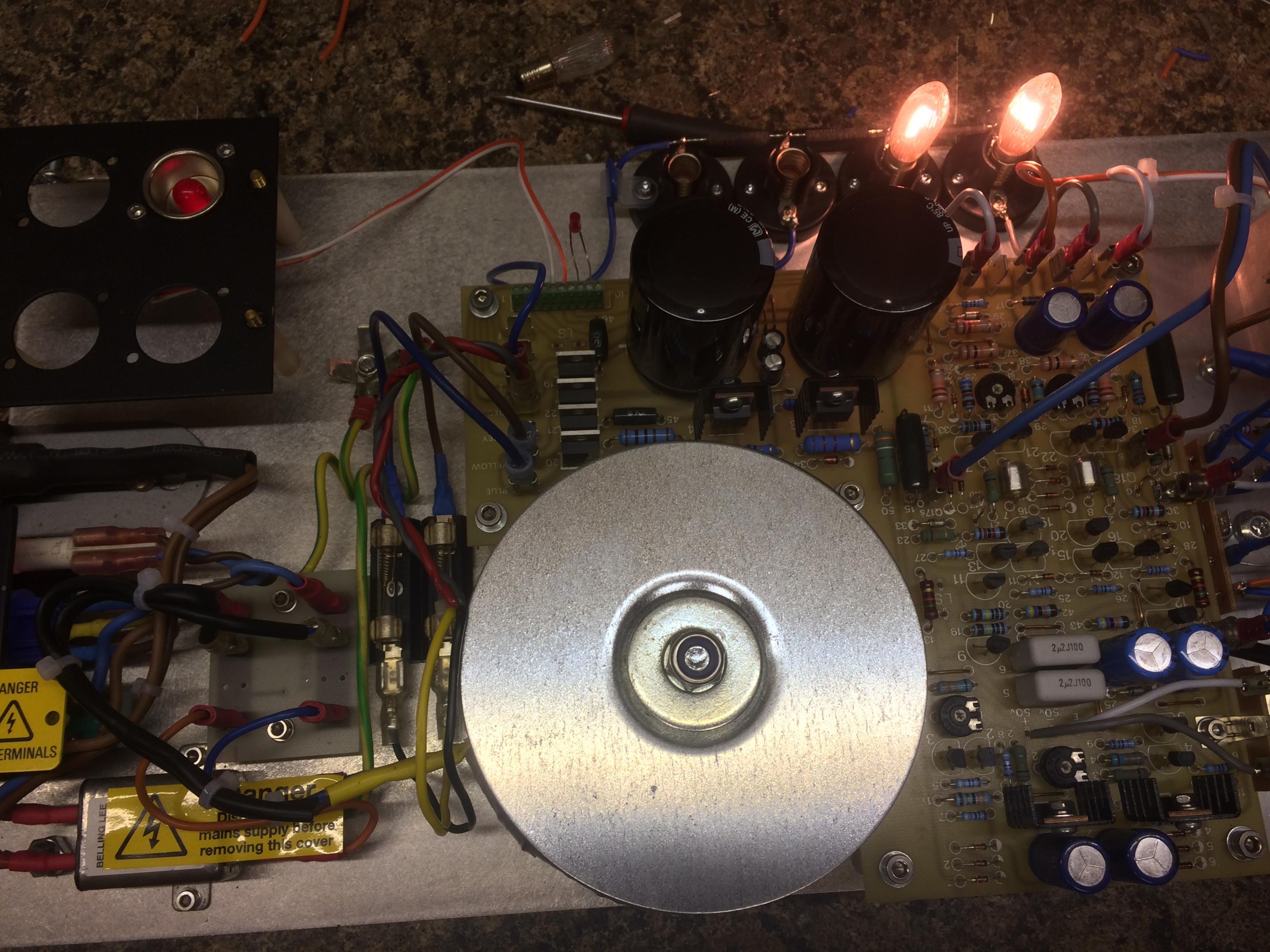

I would start be ensuring proper fusing and swapping the transformers over. That'll tell you if the problem is with the transformer or the amp/PS

Hello .. in this model of build the sec are not fused, you could have a shorted bridge rec diode, does happen. unplug the sec connections from the main psu board, if the fuse still blows pretty much 100% faulty transformer .. my bet is the fuse will not blow with the sec connections disconnected unless the transformer is already damaged. When I make my amps I always fuse the sec winding
Will try this now (ish).....plug fitted with 3A fuse BTW??
Hi , i would recommend to disconect secondaries from board, and connect transformer to mains not directly, but through incadescent lamp. If transformer iš good, would not consume high current on primary ,lamp will not lightup. Also can measure output voltages ,and voltage after lamp . User 100w or more rated lamp.
At least , you can try this : disconnect secondary windings from amplifier ,leave connected only mains winding , which is connected to power swith ,mains fuse etc . It has higher resistance ,maybe few ohms . Secondary winding will have less than 1 ohm i think , disconect them . Try to turn on with smaller rating (1-3 amp ) fuse, it should not blow if transformer is ok .
OK....just got back...and tried powering up with 2ndary windings disconnected
...3A fuse went immediately...tried twice...so transformer is gone!
Before I go and replace it.....would I look at rectifier next??

If specification ensures proper voltage for primary ,then it has probably burned primary winding and this causes fuse to blow . Toroidal transformer should consume very little power if unloaded, just few wats. Replace transformer then ... Yes ,its 50v two secondaries 3.0 Amps rated .
Most problem in amplifiers is output transistors shorted ,and no fuses after rectifier present ,so mains fuse blows then ,but transformer gets overloaded hard until fuse blows . But if fuse is replaced to over-rated value ,then result is like this . Fuse should never to be replaced to higher rating if it continues to blow . Yes , i would check rectifier and big capacitors for shorting ,sometimes diode bridge gets one of diodes shorted ,and then you may damage new transformer .
You wrote about a mains fuse - can you solder two wires to blown fuse ,and connect a 100w+ incadescent or halogen lamp to those wires ,and put this in fuses place ? It will protect new transformer while you will repair amplifier .

I think you need to be asking yourself 'why did the transformer fail' as it's unlikely that it would do so unless physically damaged or over-stressed (heat will damage the enamel insulation on the windings causing a short). If the transformer isn't physically damaged you need to find out if the cause of it being over-stressed is still present otherwise you might end up with a replacement transformer in the same state. First thing is to arrange for the correct fuses to the secondaries before using a replacement.
Agree completely . If fuses not present , add them . Check output transistors, rectifier. I'm doing this when repairing amplifier,after transistors replacing :
1. DC output voltage ,going from rectifier to amplifier, connect through small power rated resistor like 10ohms 0.25w , also you can calculate current consumption if amplifier works ,but no signal.
2. Measure DC voltage at amplifier outputs, can be in range few millivolts,for some amplifiers more like 10mv.Adjust if needed.
3. Measure idle current of output transistors and adjust if needed.
4. Apply some signal with speakers connected, but not loud, remember small power resistors may burn. If all ok ,and resistors not smoke, can test with smaller value ones ,or with fuses . Maybe i'm wrong somewhere or missed something, also to connect scope to output would be usefull.

Exactly...something has caused this!
Will be looking at rectifier (Diodes x 4??)...see if one 'of 'em is defective...I can do that with my meter!! 🙂

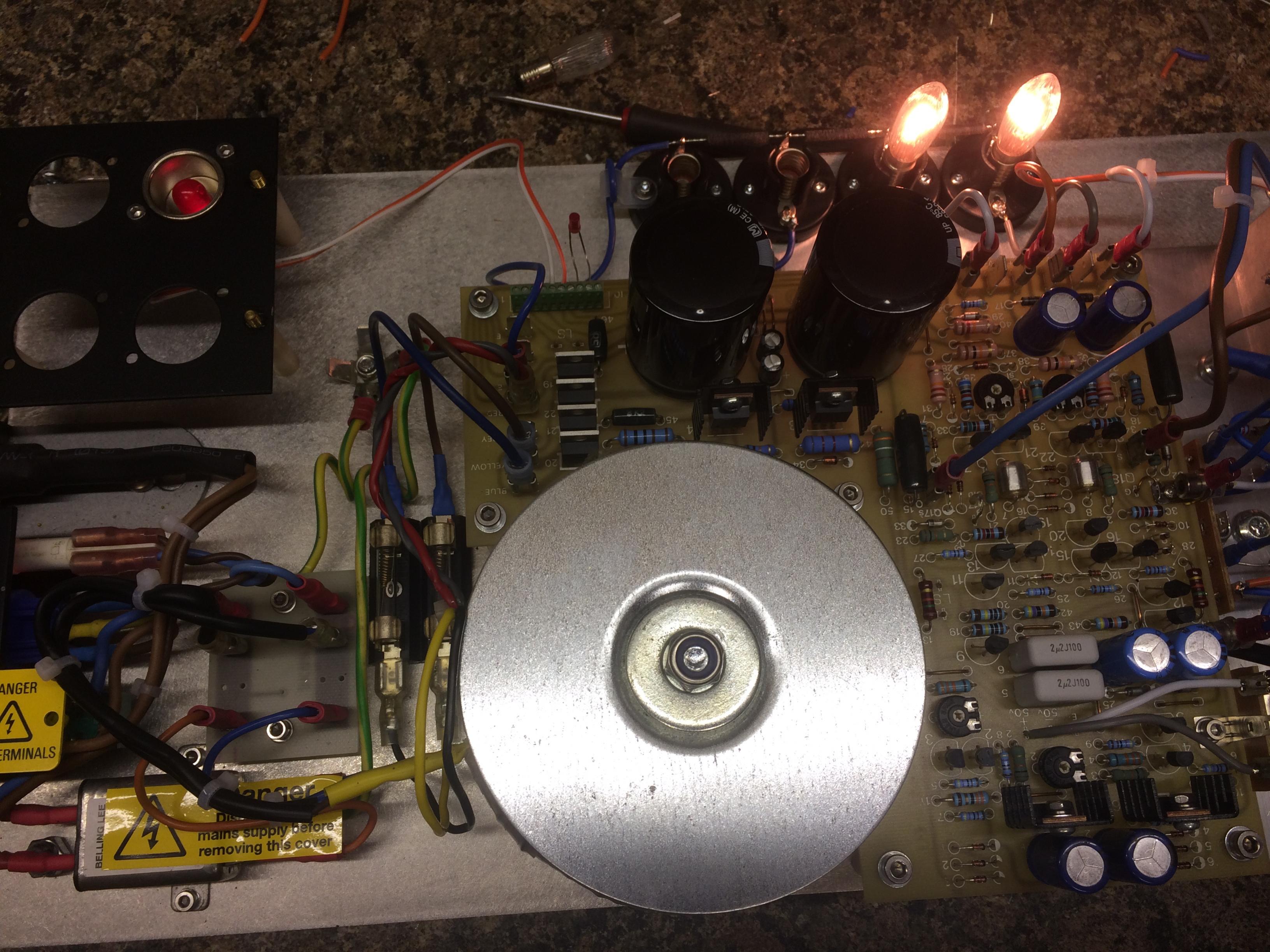

Hello .. this is why I made a power supply test bench, notice the sec fuses before the PSU PCB ... just posted for info
Right...need to think about where these would go in the actual case....your test rig has an extra bit of room!! 🙂
Can you please point me towards the fuse holder that you are using....and also recommend values for Primary and/or 2ndary fuses...?
OK...all 4 Rectifier Diodes (BYX49) removed/tested/replaced...good.
Reservoir caps removed (4700mfd 80v X 2)
Visually...one of them showed signs of leaking of black substance from around 'white' terminal...this was hard/dry. Some slight bowing of the connector plate.
This one has continuity between White/Case
"2nd Cap....no leaking/bowing....but shows continuity between Red/Case and White/Case
....is it fair to say that they're stuffed?? 🙂

If you have capacity meter, or some dmm can measure , check if capacity is ok. Ofcourse if capacitors don't shorted.
