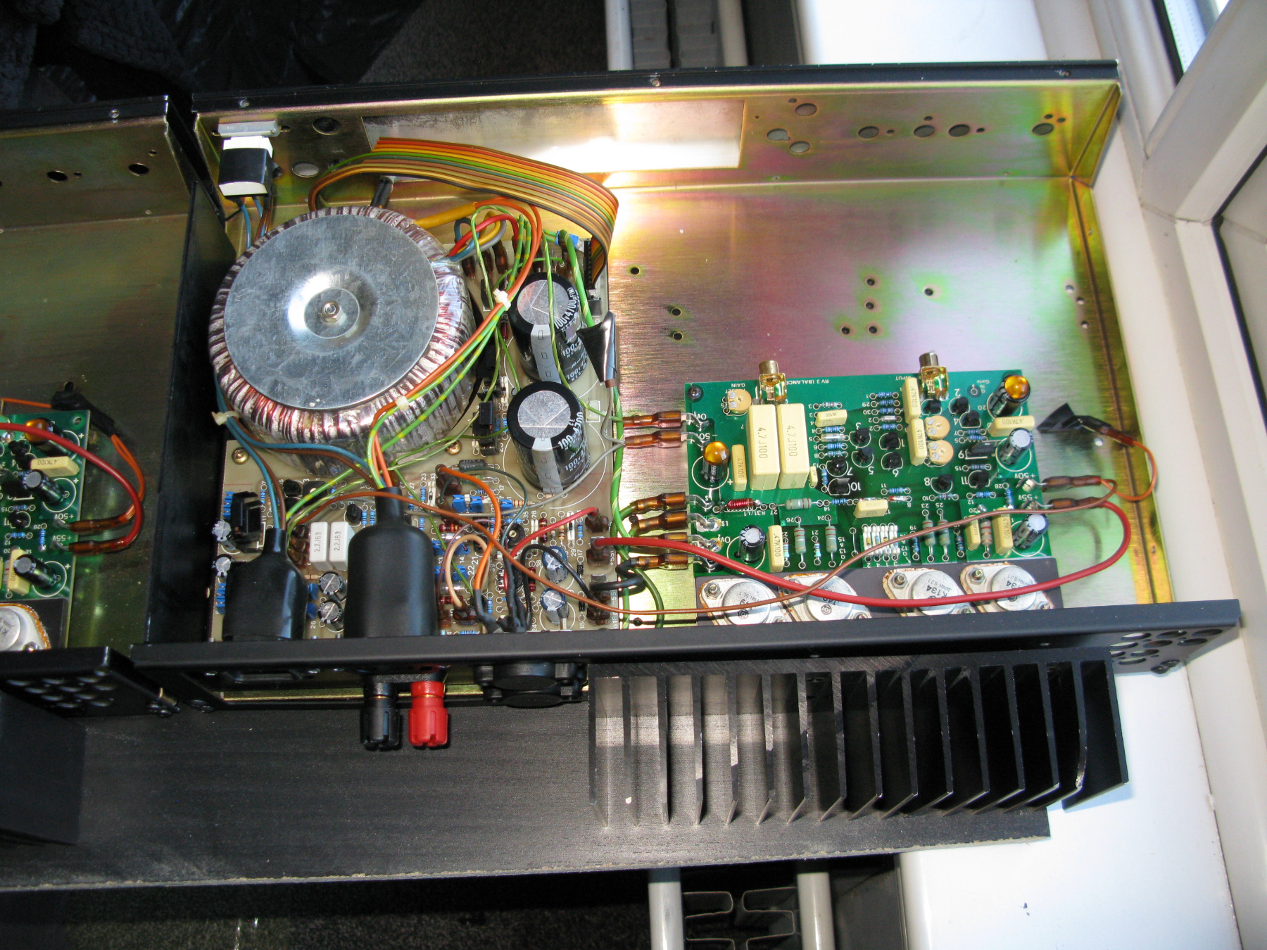

Hi Ian...and thanks for the input...particularly on 'lifetime'!
My local RS here in Leeds stocks Kemet...among others?
Apologies if I've overlooked a topic that may have already been covered on these pages.
My plan isn't just to be changing caps 'Willy-Nilly' BTW!!!....I've concluded (post #78) that a pair are now defunct, and must be replaced in order to move on.
Trying to ascertain what these types are...and where to get 'em here in the UK.....and some highly regarded types for audio are only around 3,000 hours. ....

Kemet make a wide range of caps but the brand doesn't tell you whether the quality of a specific grade is fair for the price or you're paying for something that won't do much more than any other new cap. I haven't taken the time to look at their whole range but RS seem to stock some of their moderately priced, general purpose grades. You could also try Farnell or CPC in the UK:https://uk.farnell.com/nichicon/lls1k472mela/cap-4700-f-80v-alu-elec-snap-in/dp/8813280
