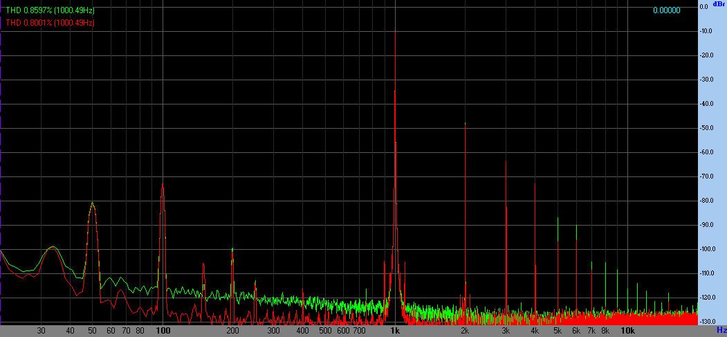

Harmonic pattern of SE

Seems like the herd still don’t get it. It is still about harmonic pattern/profile, for which an example was presented, NOT about simulations!

Step back; as mentioned more than one time the most important test is THD vs frequency at different level, specially for s.e. where the power is limited and, in some cases, the quality of OT make difference. Of course in parallel with a wide freq. response.
And the THD vs Level, this help to understand what happen when the amp reach the saturation; normally for a good s.e. the curve has a soft increment.
