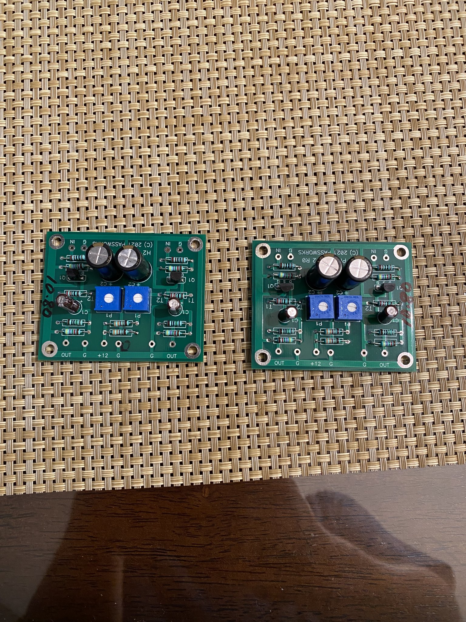

Hello everyone, can anybody tell me if it would be possible to make a balanced version of these. I do not understand the concept very well and would like to know how to wire them.

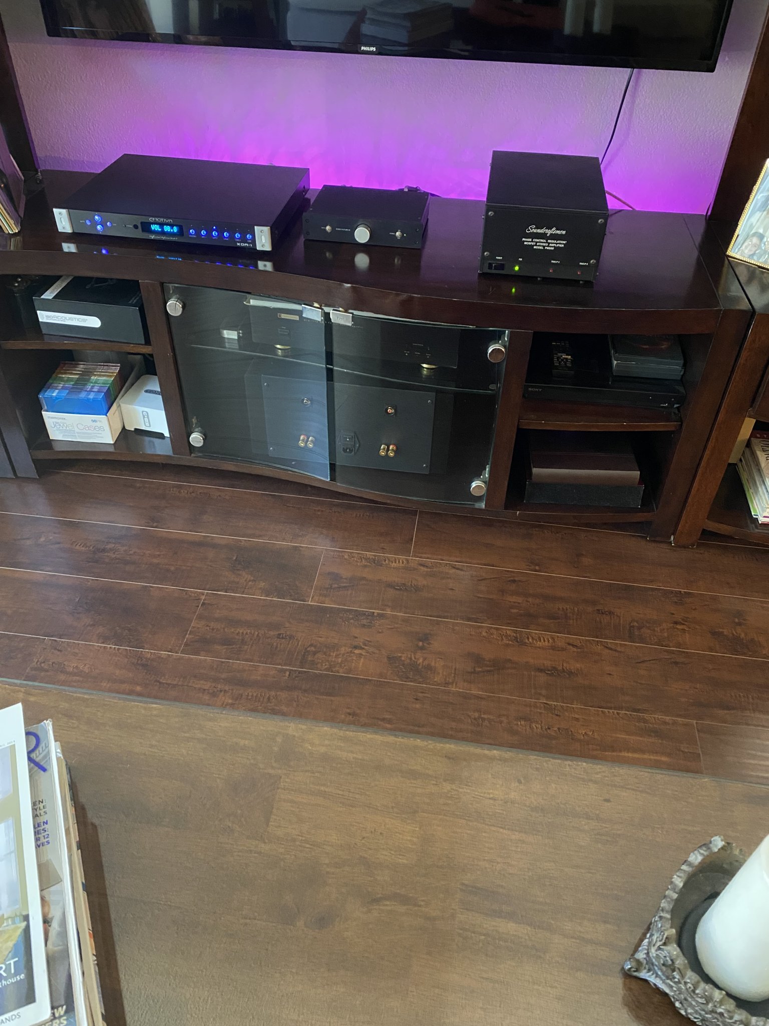

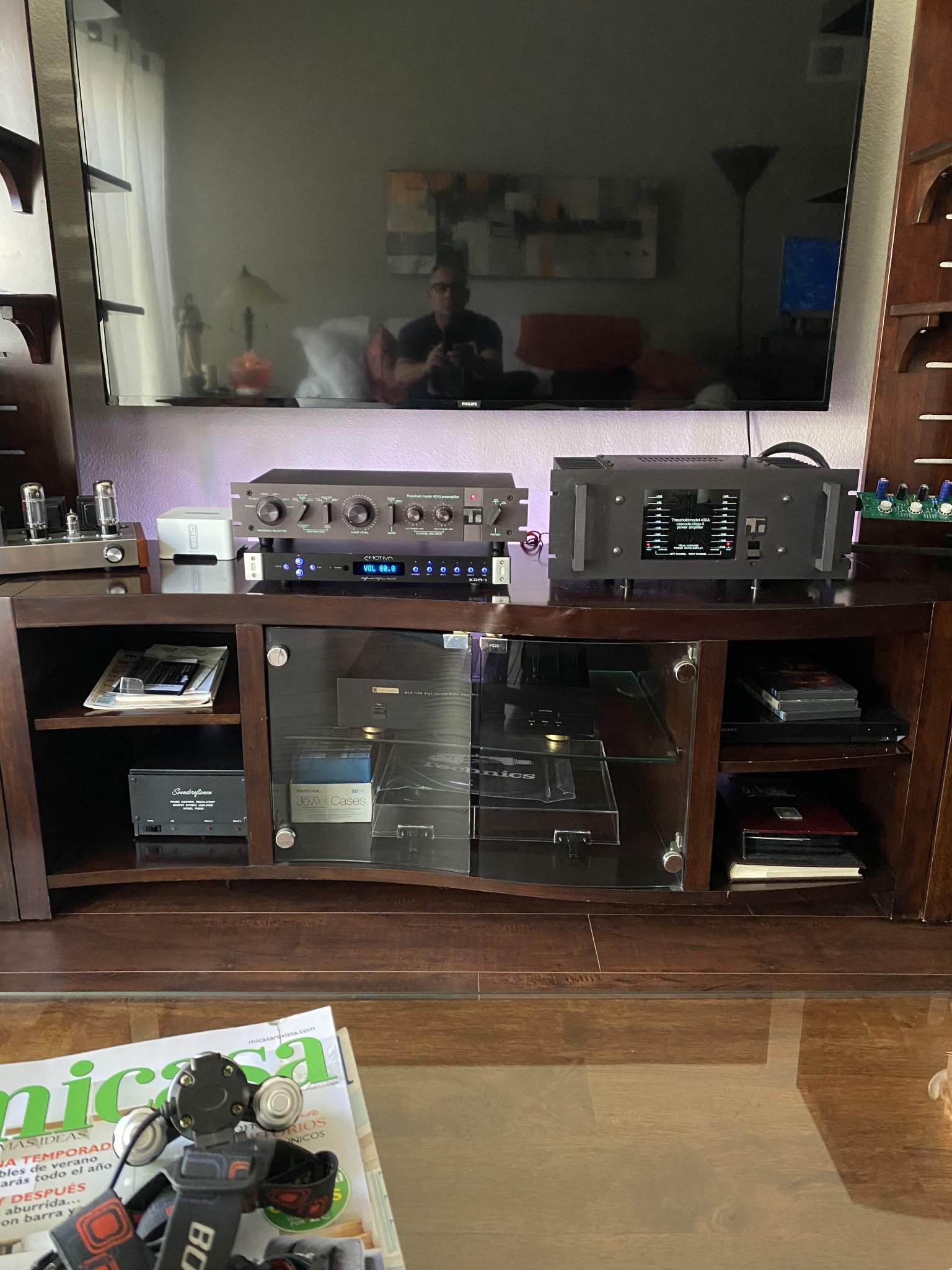

system? I basically have a bunch of bits and pieces, tryin to find out what works the best. My old Emotiva dac has balanced in and outs

The H2 generator is unbalanced, so you would have to add it at a point in your system where
the signal is unbalanced. Of course, you could add one H2 in each phase of each channel,
but this would tend to reduce the benefits of a balanced system. But you could try that anyway.
Since the H2 circuit is single ended, wouldn't the added distortion be different at each moment
in the two phases, since the two phases of the signal are in opposite polarities?
Then the difference of the phases at the output (even if that is at the speaker terminals with
a balanced power amplifier) would not have just the simple H2 distortion.
in principle, 2nd is going to be nullified in Bal mode
of course, each phase can be set differently, resulting in whatever is wanted/needed for THD Spectra
though, that being achievable only by someone who's not in need to ask that sort of question at Forum, demanding not just some level of experience but also some hardware for measurements and setting da thing
I was just asking because another member on this forum built a balanced version...but your right, I don't have the skills or the experience or the test gear to dial in 2nd harmonics. I just thought there was a advantage to having balanced. I will stop working on this for now and continue with other projects thanks for your reply zenmod.
