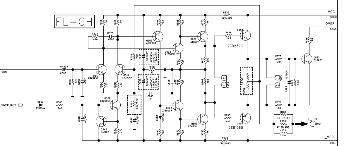

I happened upon the schematic for the AVR146 power amp section today, then searched diya and found this thread, thought I should post it here for others to see. A bit different and interesting arrangement: LTP with plenty of degeneration, concertina phase inverter and emitter followers driving complementary symmetry VAS, no vbe multiplier. The outputs are darlingtons.
