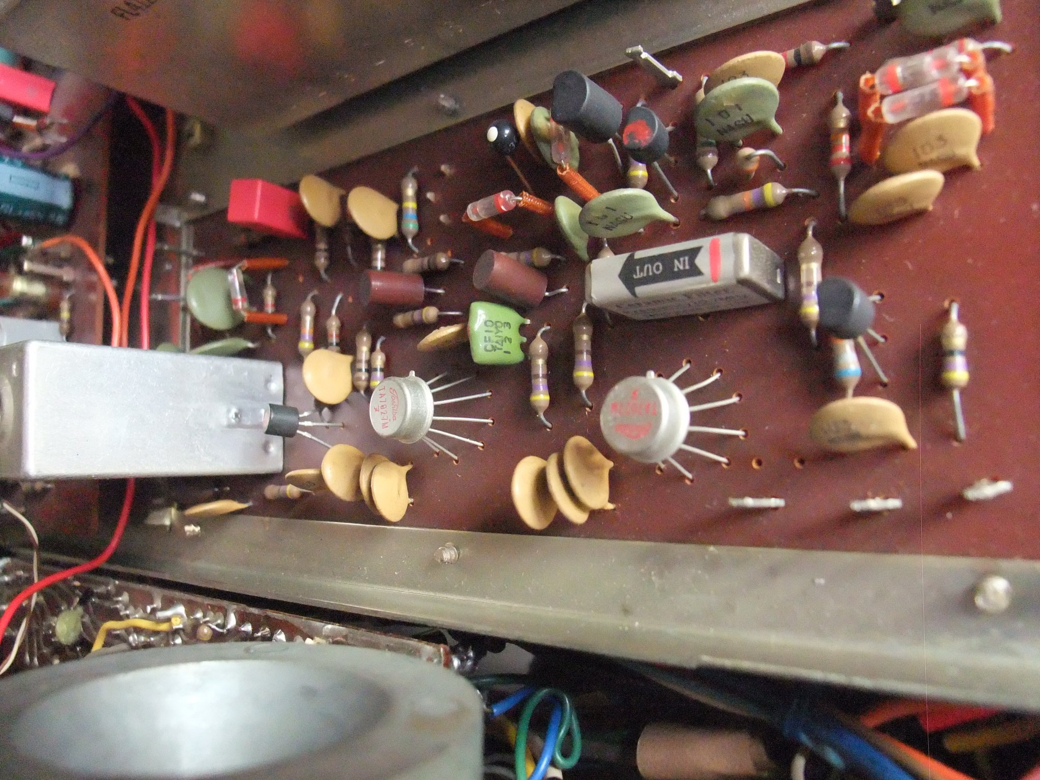

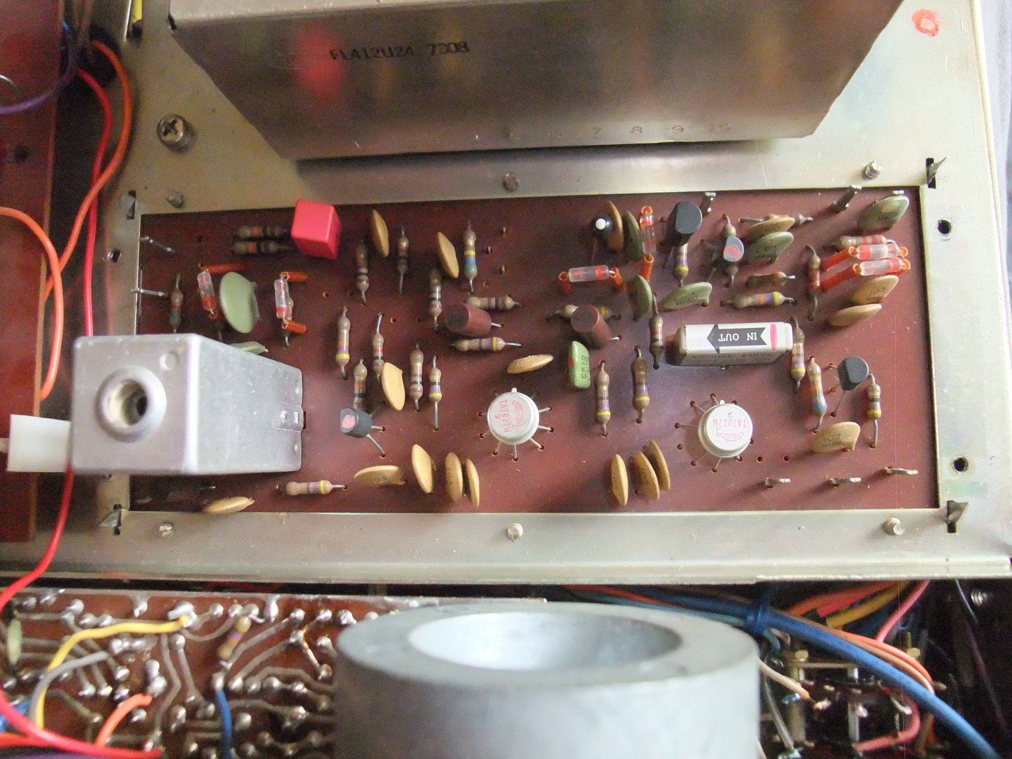

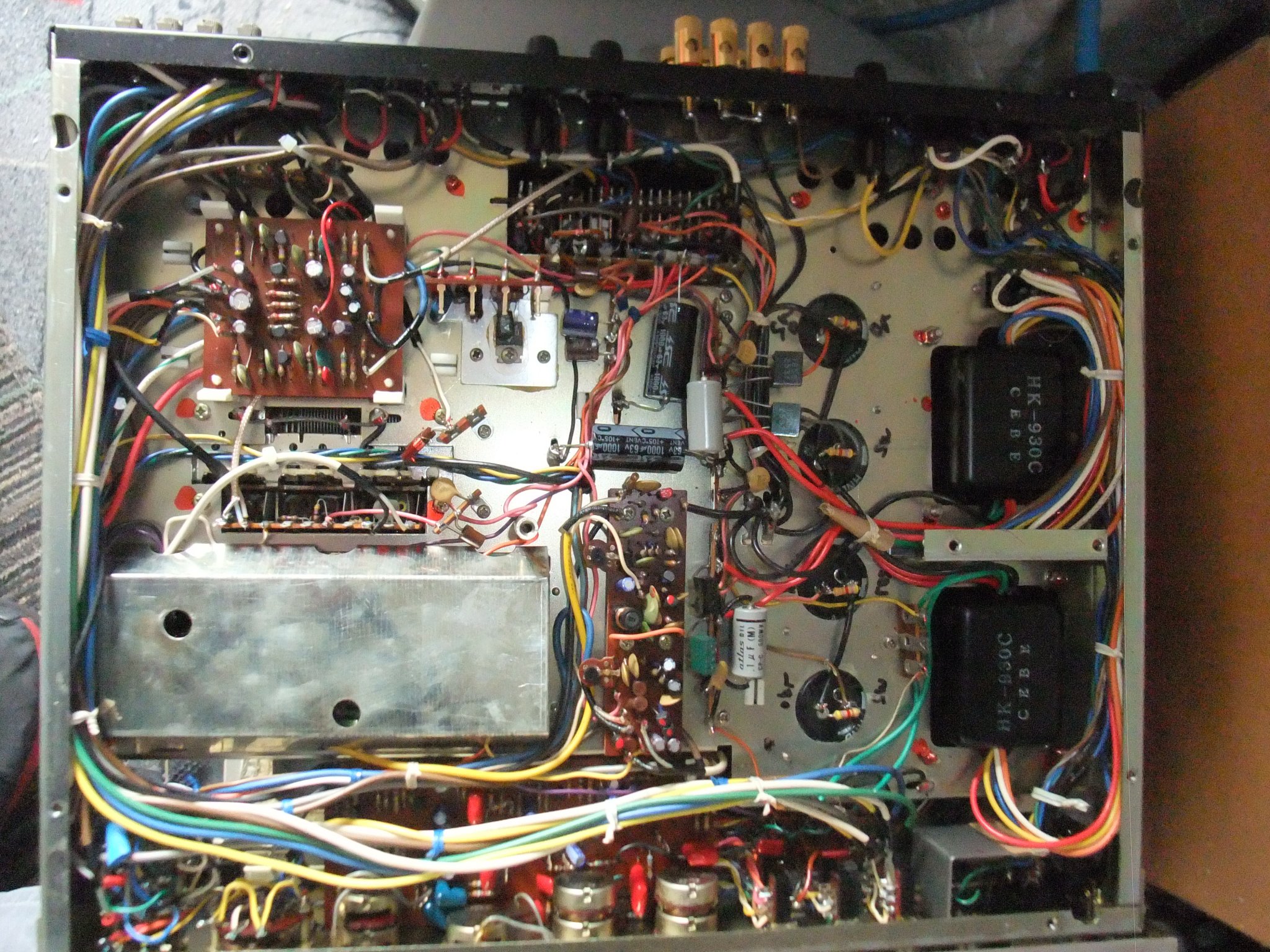

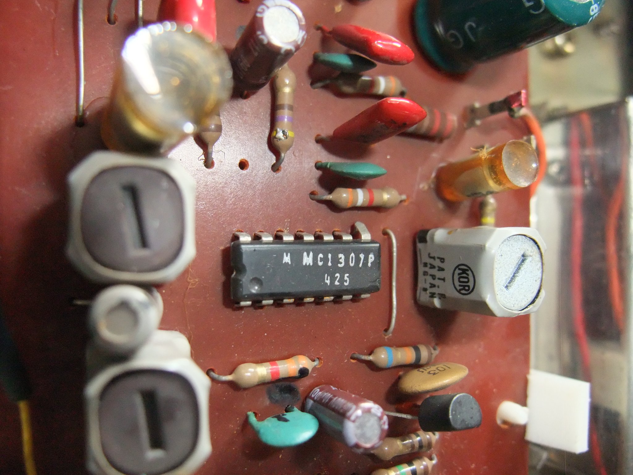

On the desk I have currently a device of this model, where it is exactly the opposite - also to observe in front of the stereo decoder with MC1307. This means, only the RF-unit and IF unit create this deficiency. Popping is only temporary present and in low level mode (audible during pauses in speaking). In the attachment are images of the IF amplifier without screen cover, and resistors in the kind as to find in the images from post #23 under
https://www.diyaudio.com/community/threads/harman-kardon-930-bias-adjust.239812/page-2
- known for issues in such kind - are not in use on this IF PCB.
Which parts should I replace first? Ceramic caps, germanium diodes, dual ceramic filter or IF amplifier ICs ?
Thank you very much for an advice.

Unless you've got the mandatory test equipment and experience to do a complete alignment of the IF and stereo multiplex boards, I'd recommend you leave those ceramics, diodes, filters alone.
Start by troubleshooting and monitoring voltages in those circuits, perhaps a funky electrolytic is the cause, or maybe a resistor that got noisy.
An o'scope and RF generator is another required piece of equipment when dealing with critical tuner issues.
An other device of this model seems to be the best solution, because then I can change the 10,7MHz IF board and do observe, if this unwanted effect also change to the second device or not. If yes, after this task I change the parts step by step on the IF PCB's until the effect is walking again to the PCB in perfect working condition.
