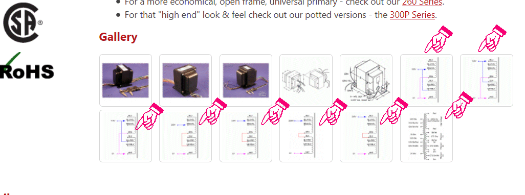

Just in case you have forgotten-
https://www.alliedelec.com/m/d/53f4d8b76a2d1edccd06e60532e6190d.pdf
The connections are detailed here:
High Voltage (Plate) & Filament - 39 VA to 940 VA (300 Series) - Hammond Mfg.
The un-used leads must not touch each other, chassis, etc. I would normally shrink-wrap each one separately and then tape/tie-up the bundle out of the way. So if you do move to another land you have full leads for re-volting. Deluxe would be to bring them all to a terminal strip, but that is usually done only for multi-market production. You can (after testing!!!) clip them back, leaving just enough to shrink-wrap securely, but it is rarely "necessary" and may be annoying in some future life.
