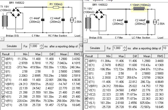

Out of interest i tried modeling one half of my F4 supply and replaced the .1r resistor (four .47r in parallel), with a Hammond 159ZJ (10mh, 5A, 0.16r). Only real difference i see is a reduction in ripple from 161mv to 71mv. Might pick a couple up and give them a try.
