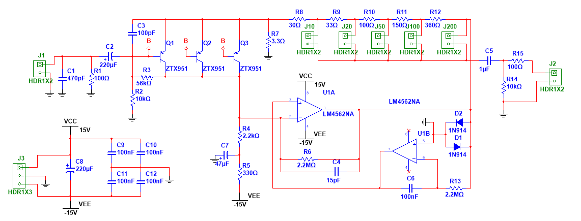

"Would need a little guidance of which fet replaces which BJT."
You can't just replace a BJT with a JFET, Keep in mind that a BJT is a normally off device and you have to bias them on to work properly and a JFET is a normally on device and you have to bias them off a little for them to work properly. Completely different biasing. You are talking about a complete redesign.
Here;s a first cut on a 2x2 inch PCB. The SMT analog of the 2N4400, 2N4403 are the MMBT versions BUT these are obsolete even though Rochester Elec has tens of thousands. There are some needed adjustments to use the ZXTN2018F, ZXTP2027F which are about as low noise as you can go with an SMT bipolar:
It would be worthwhile to replace the 4401/4403 with ZTX 851/951.
ZXTP2027F = ZTX951. They need to have much higher Ic to attain the lowest noise levels.It would be worthwhile to replace the 4401/4403 with ZTX 851/951.
