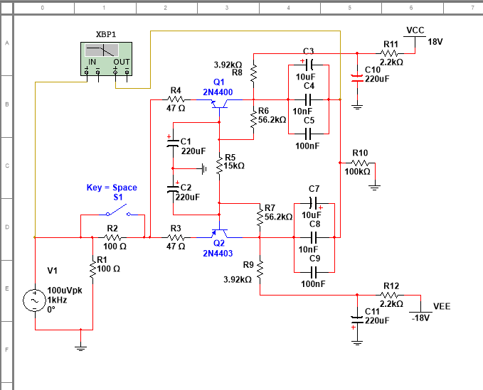

Yes Jack, Hafler did offer two pre-preamplifiers for the DH-110. The DH-111 and the DH-112, both of which fit inside of the DH-110. Either of these are installed in the Phono 1 input circuit so you would have both an MC input and an MM input (Phono 2). The instruction manual describes how to install each of these in the DH-110. I have a DH-110 but both of my phono inputs are still MM.

Thanks Ken, now I recall. I had it archived in an old copy of Multisim.

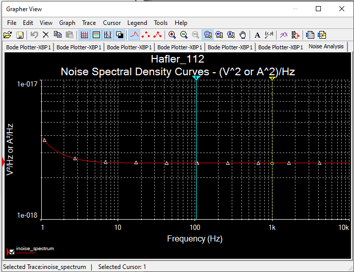

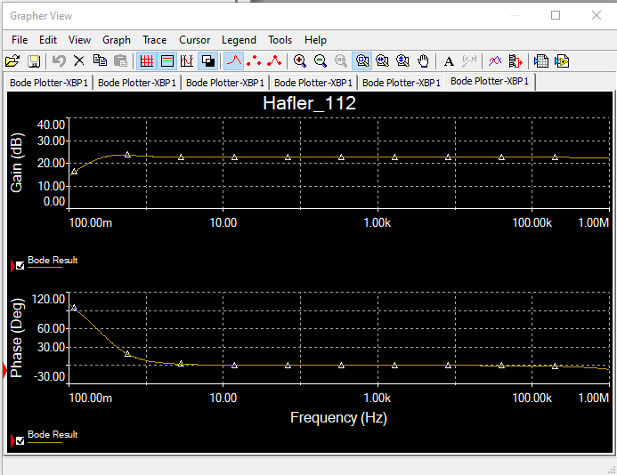

My youngest son (who now has 3 kids) has both the Hafler DH-110 and 220 that I bought at a HiFi show on Long Island in the early 1980's. So it was the DH-112 I eventually purchased, but never got an MC cartridge. Here's the schematic and a graph of the results. +23dB gain. With surface mount you could probably make it tiny!

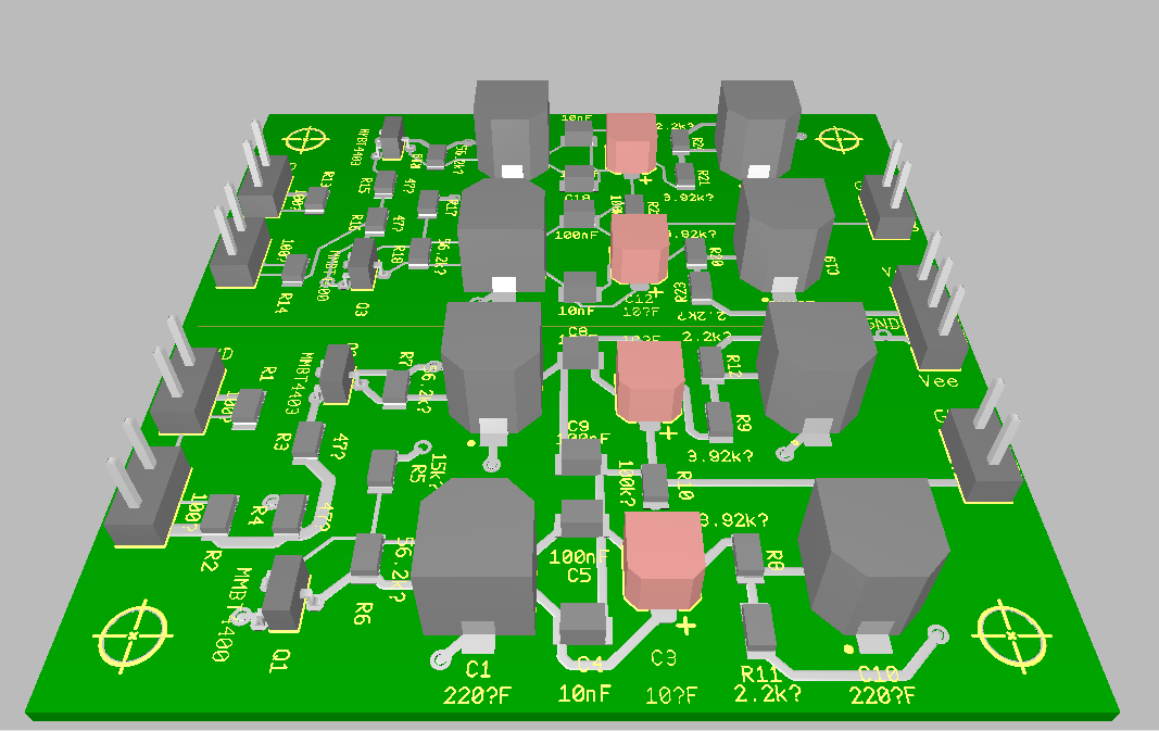

Here;s a first cut on a 2x2 inch PCB. The SMT analog of the 2N4400, 2N4403 are the MMBT versions BUT these are obsolete even though Rochester Elec has tens of thousands. There are some needed adjustments to use the ZXTN2018F, ZXTP2027F which are about as low noise as you can go with an SMT bipolar:
