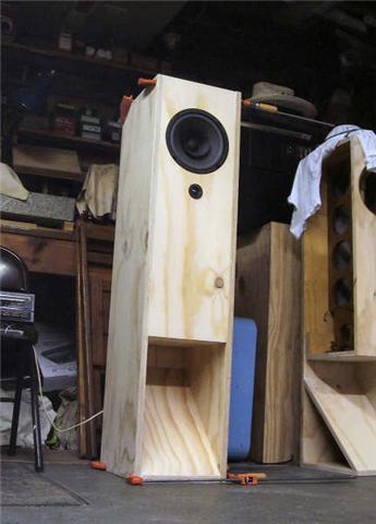

I have a set of Half Chang that need replacement drivers.
The original foam surrounds on the Pioneer BOFU are letting go.
Is there a replacement foam surround for the Pioneer?
Or.... Should I replace the drivers.
visiton B20, SB20FRPC30-8 or the GRS BOFU are within my budget for these boxes.
Still need some help choosing a driver

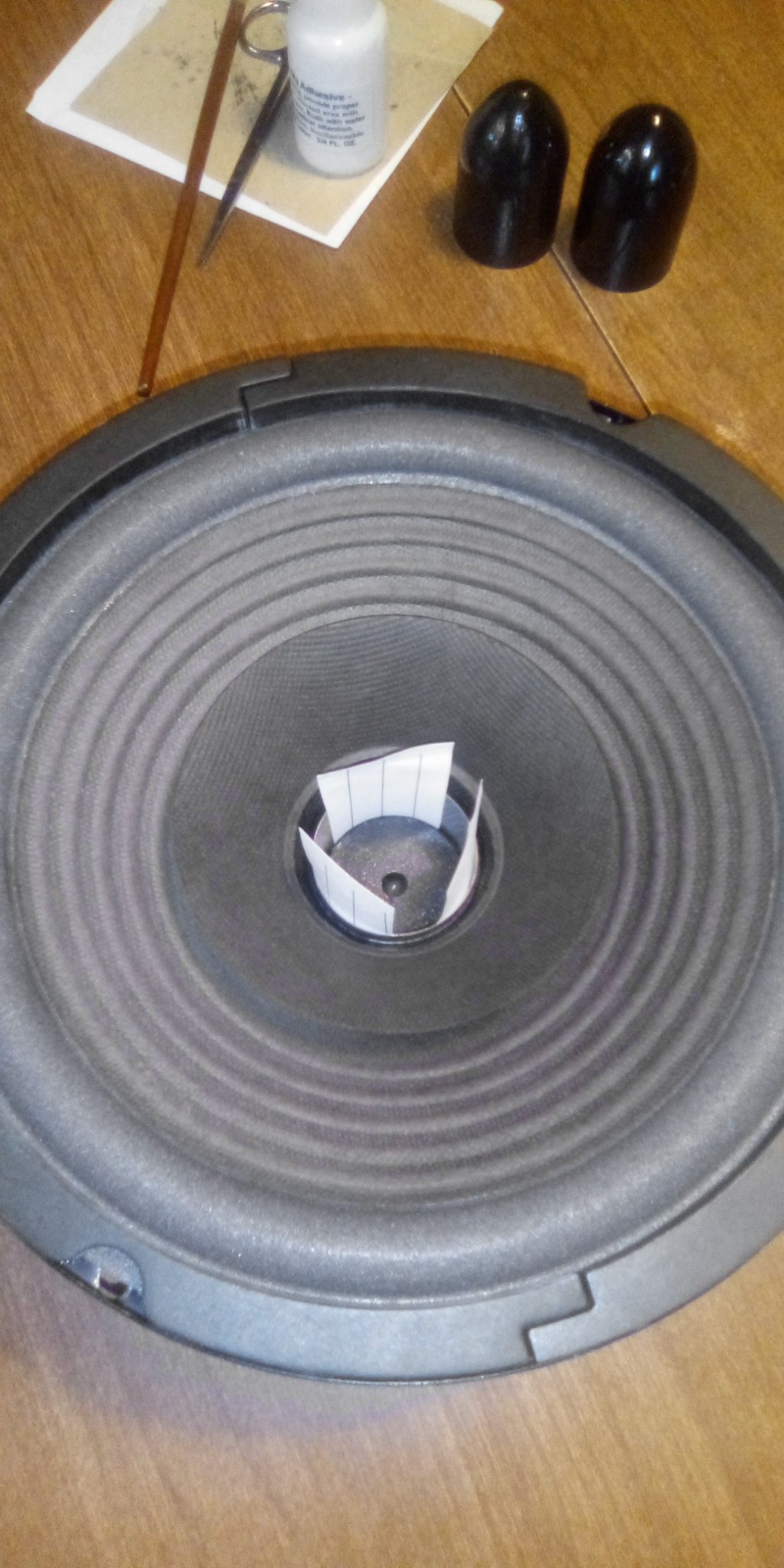

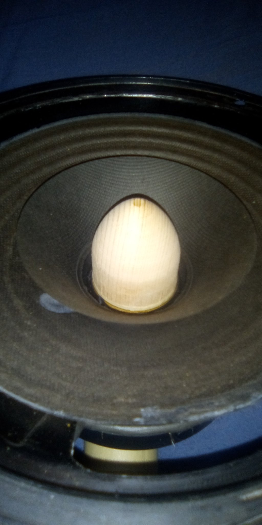

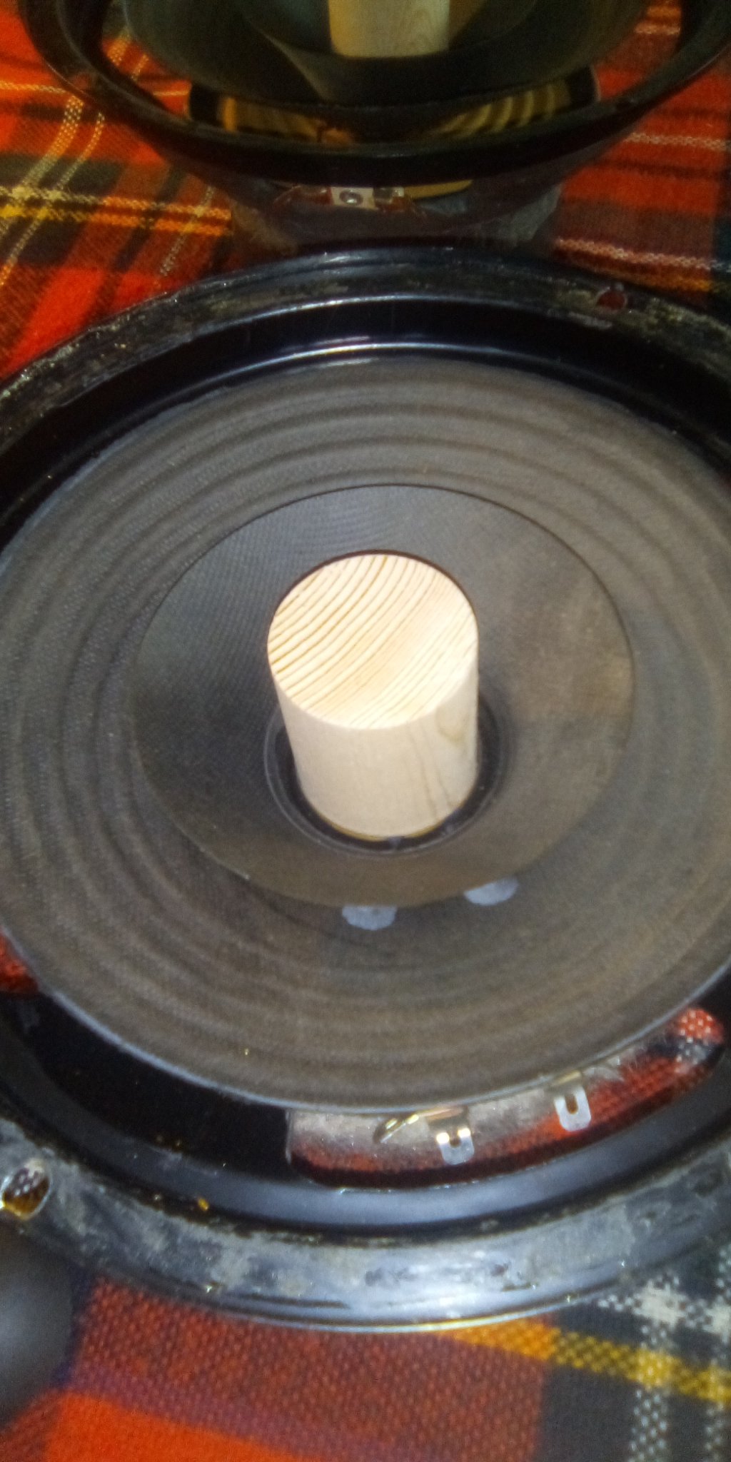

I've always wanted to try to remove the dustcap, install phase plugs. I've already done the basket mods. Ductseal on the stamped frame to reduce basket ringing and a wool hat for the magnet. Also added the Dayton Tweeter and cap.
Another goal was to try to calculate for baffle step and whip up a "crossover"? or compensation circuit.
*Now I'm using Equalizer APO and along with the dustcap-ectomy, I hope to get rid of that slight honky sound that always bug me a bit. For the type of music, I listen to (Classical), they work out fine. But on intimate vocals, it pops out a bit.
With the Pioneer's not having a correct replacement surround available I figured I'd have to shim the VC so the dust cap was going to be removed anyways, I made up some phase plugs.

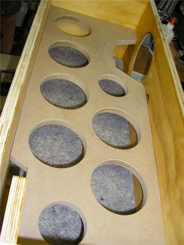

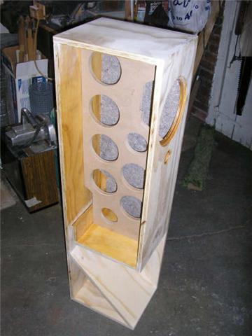

On the back wall of your speakers have you tried damping, etc- to help kill the back wave?
Yes,
I have placed some "damping" material on the sides, back and top and bottom of the cabinet.
Also have added Pollyfill like material to the upper half of the box (not blocking the port) to help with the reflections behind the woofer. I damp driver basket with putty for ductwork and added a boot over the magnet.
LOL I spent days listening, adding removing "fill" before gluing the side on. Come to find out, I like a "livelier" sound (less damping) as too much damping material can make the speakers sound dull, lifeless to Me.
JimD.

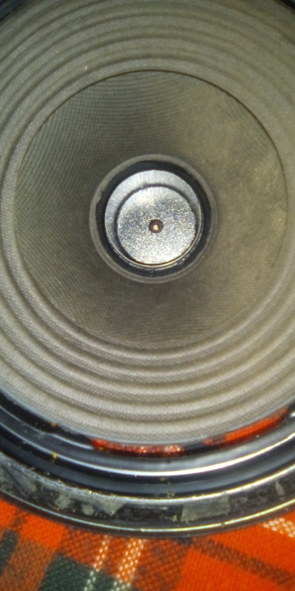

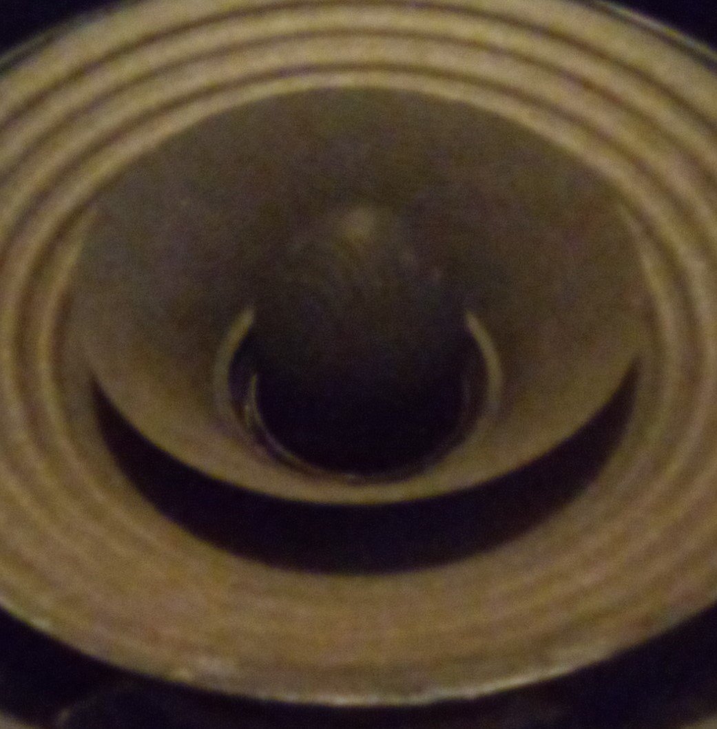

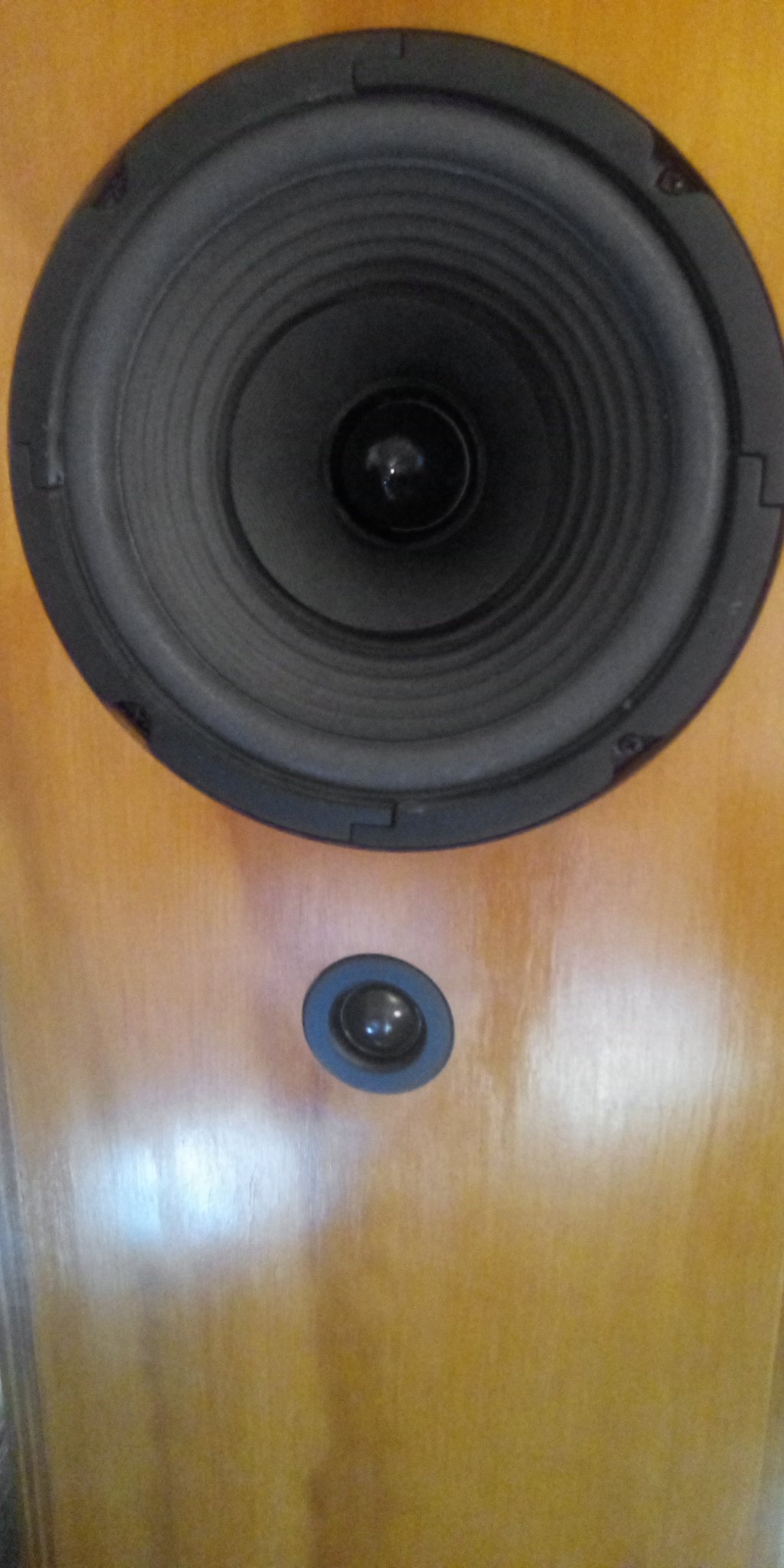

The Surrounds came in yesterday.
I was so happy, they fit fine, no rubbing VC, no issues at all. Thankyou Mr. looneytunes for helping me find a suitable replacement.
I do like the sound of these speakers better (I think) after removing the dust caps. I also installed the phase plugs I made. Whether or not these tweaks are making an audible difference to my old ears, IDK but, it finishes the look.
They were always bit bass heavy for my small room so, Equalizer APO to knock of some room gain.
I'm enjoying the Half Changs again 🙂
