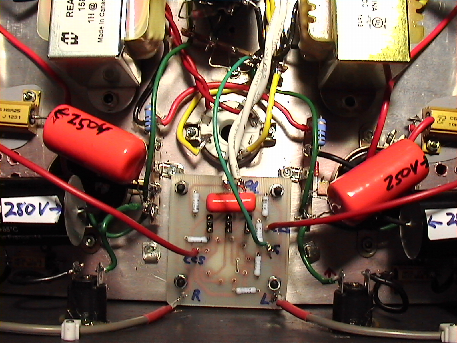

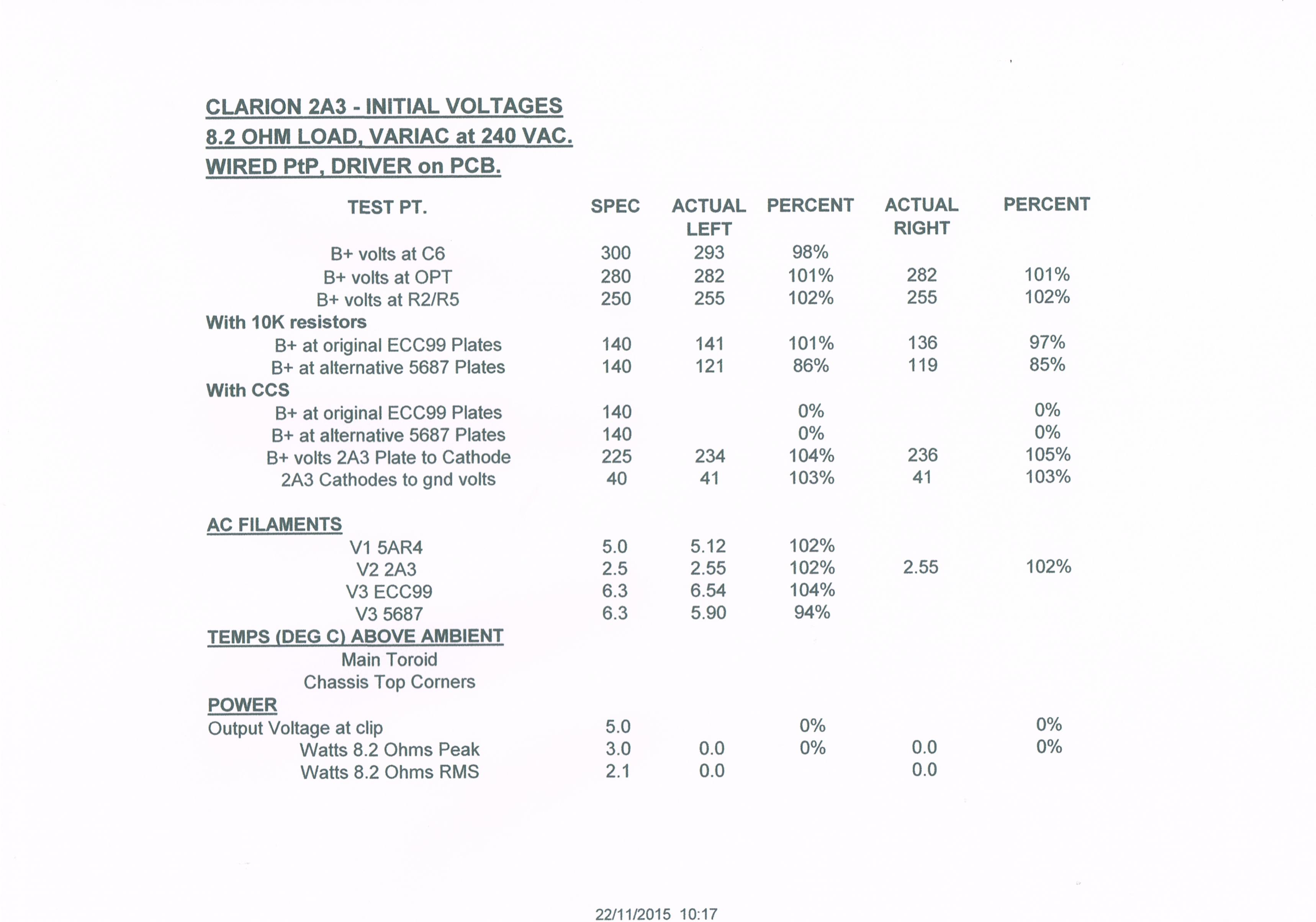

Quick update. The small driver PCB has now been made and installed first without the CCS upgrade for benchmarking. Works well with either the ECC99 or 5687 by moving 3 onboard jumpers. The small amount of noise has gone and without input is now pretty much silent with 97dB speakers. Voltages also better. See attached.
Will let it run for a day or two then instal the CCS which will allow tuning the driver plate loads etc.

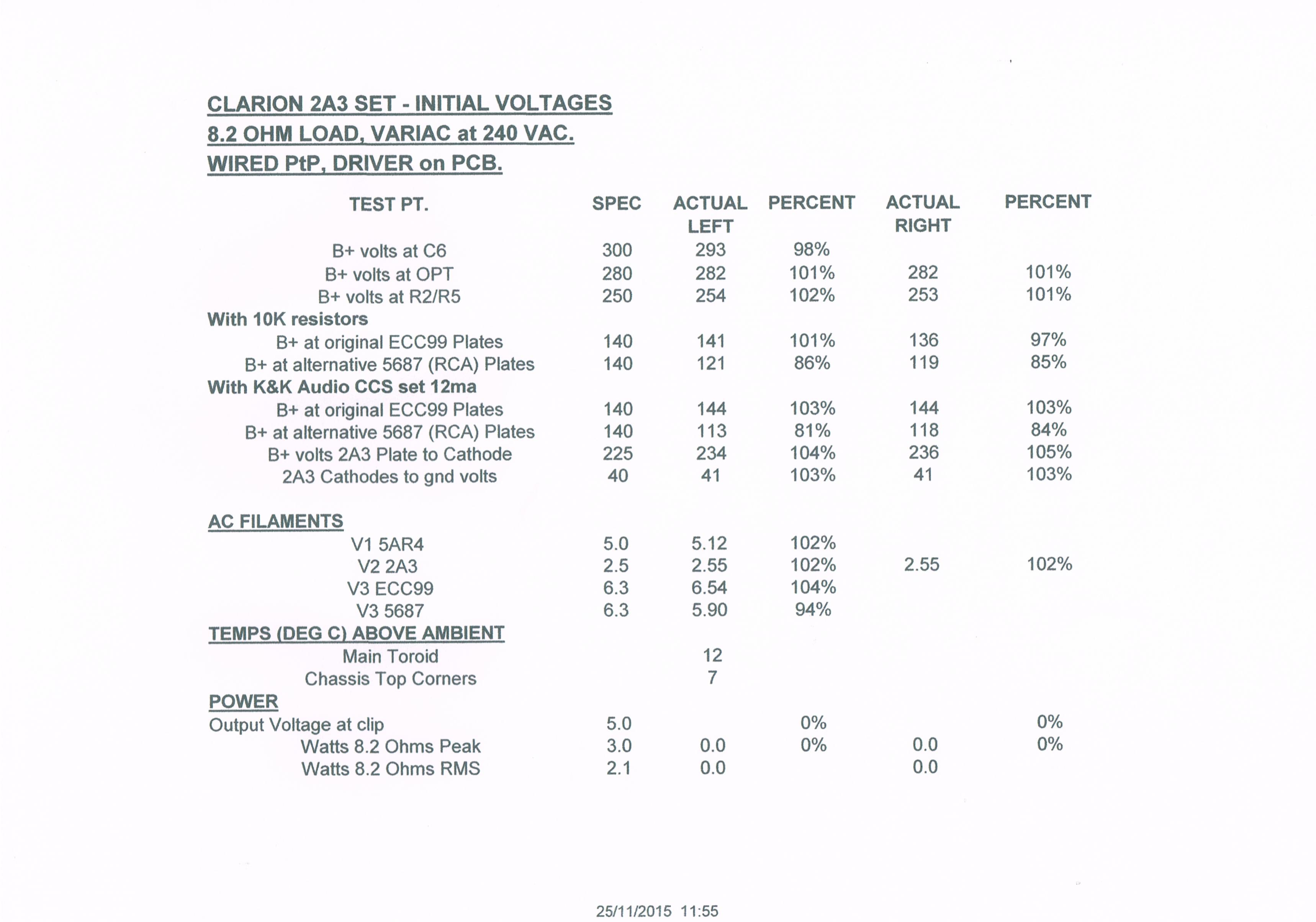

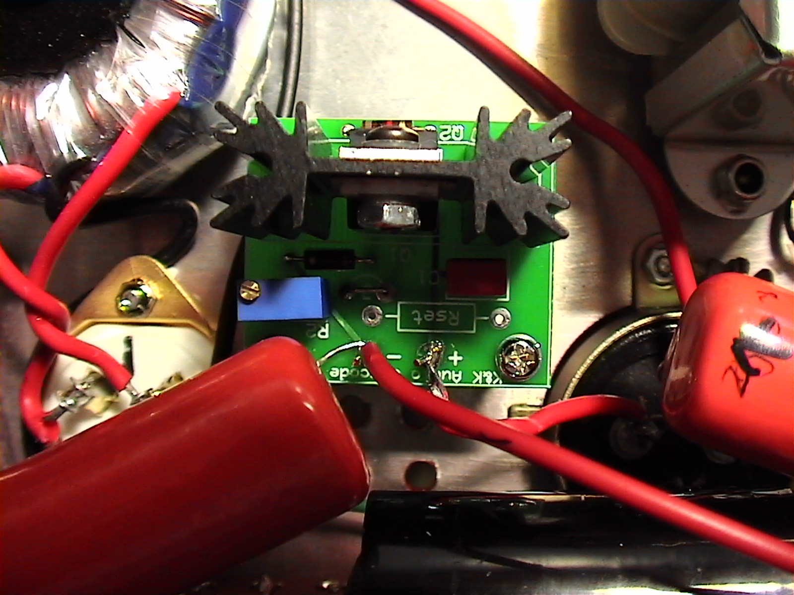

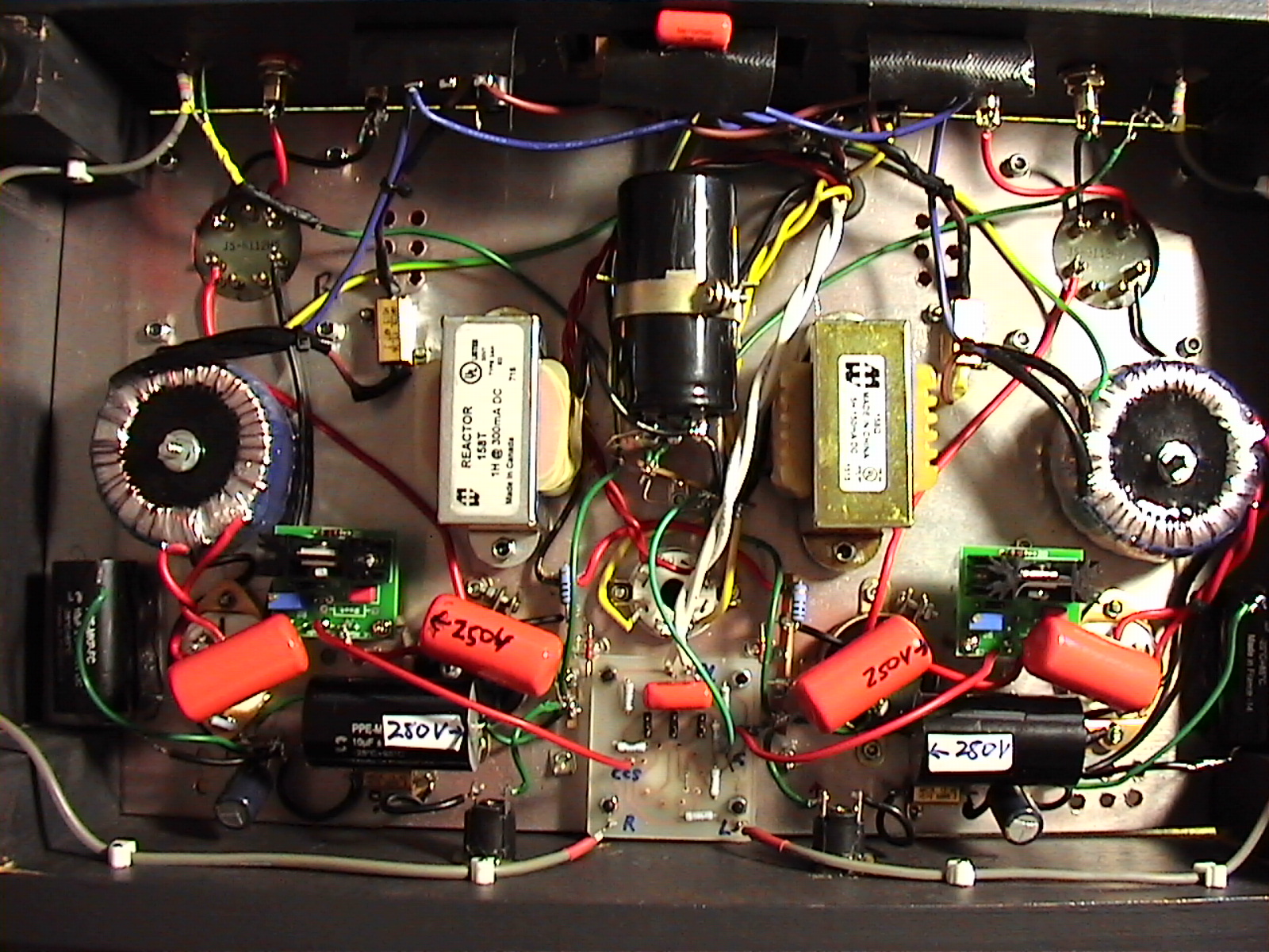

The CCS plate loads are now in and operational. There are subtle differences in the sound – all good but nothing major as you would expect at this level. Hard to explain but probably cleaner with a little more volume. The amp has virtually no noise or hum, great dynamics and bass. Compared to 6 other tube amps owned - PP, OTL and SET. Overall this amp is a keeper.
For the modest investment would say go with the CCS. If only to allow easy adjustment of plate current particularly while listening in the early stages.
As an axample see attached final voltage readings where the 5687 comes in lower than the ECC99 when set for the 99 at 12ma. With the CCS it’s easy to adjust either anywhere you like. Until happy.

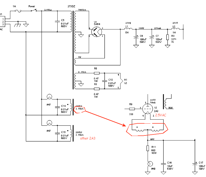

Back to the filament transformer, I see that the original design has two filament transformers at 2.5v 2.5A. Is there any reason I couldn’t use a single 5v center tapped at 2.5v? I don’t know how this would affect the design of using the lamps integrated into the circuit to reduce the voltage. Any input?

You can not use a single 5V xfmer with a center tap at the 2.5V to replace two 2.5V transformer. This will short out the signal path between the left and right channel.

R11, 680 ohms, is the individual Self Bias resistor for One (1) channel of the amplifier.
The 2A3 tubes should be individually self biased (including the other associated parts, such as the bypass caps).
That absolutely requires Two (2) individual 2.5V filament windings.
