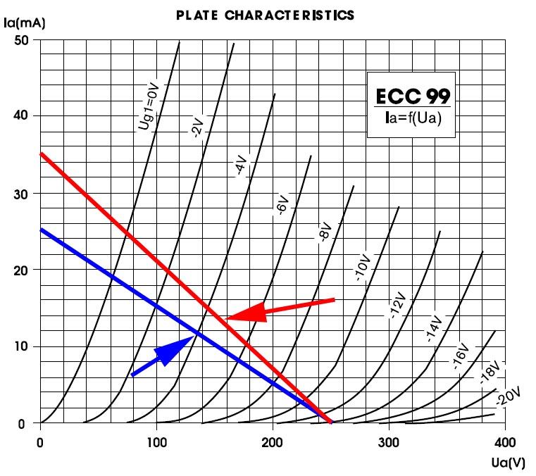

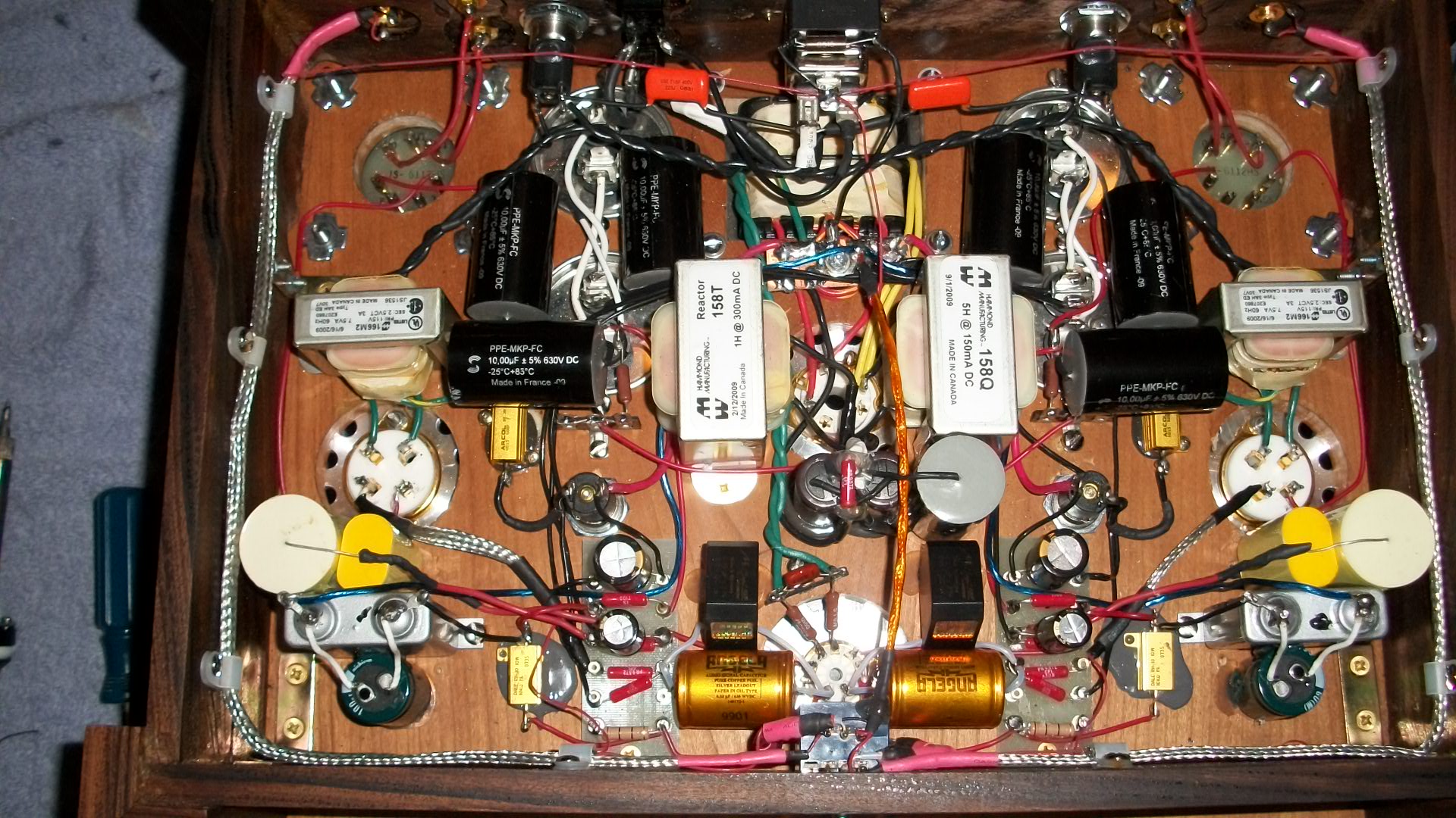

The CCS plate loads are now in and operational. There are subtle differences in the sound – all good but nothing major as you would expect at this level. Hard to explain but probably cleaner with a little more volume. The amp has virtually no noise or hum, great dynamics and bass. Compared to 6 other tube amps owned - PP, OTL and SET. Overall this amp is a keeper.
For the modest investment would say go with the CCS. If only to allow easy adjustment of plate current particularly while listening in the early stages.
As an axample see attached final voltage readings where the 5687 comes in lower than the ECC99 when set for the 99 at 12ma. With the CCS it’s easy to adjust either anywhere you like. Until happy.
