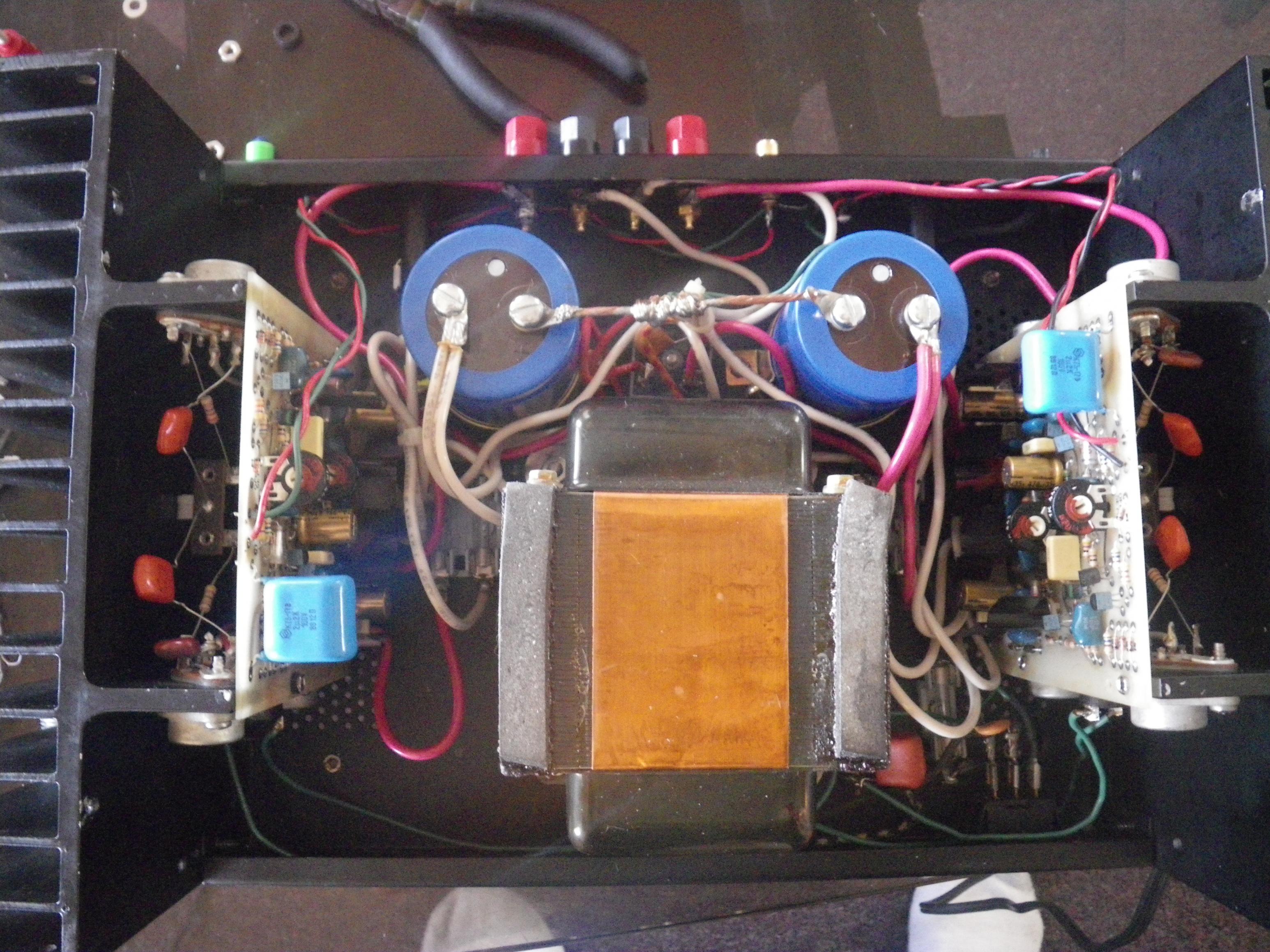

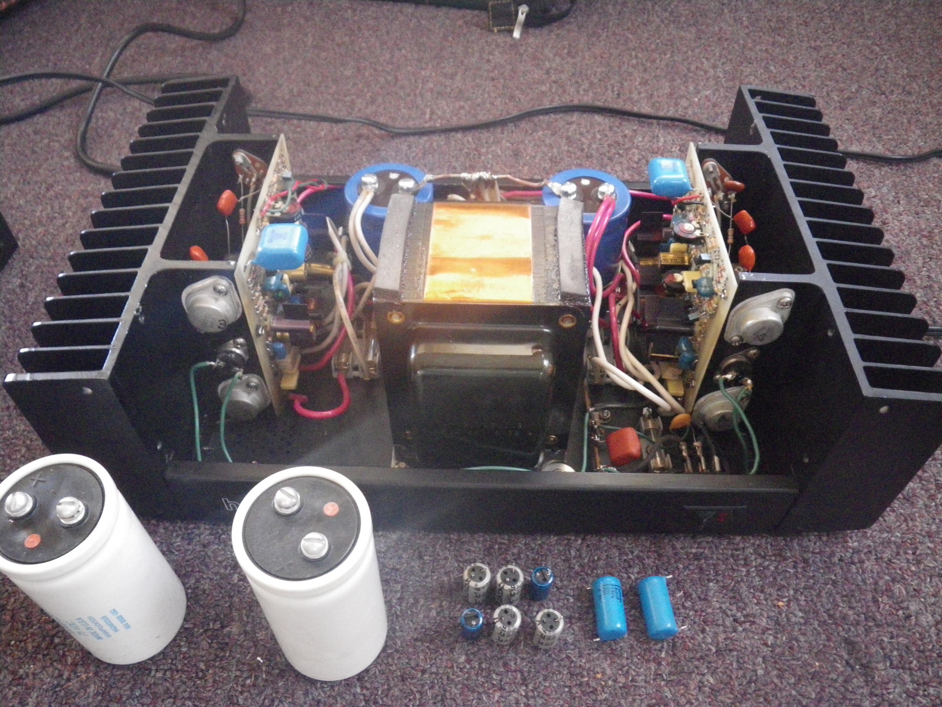

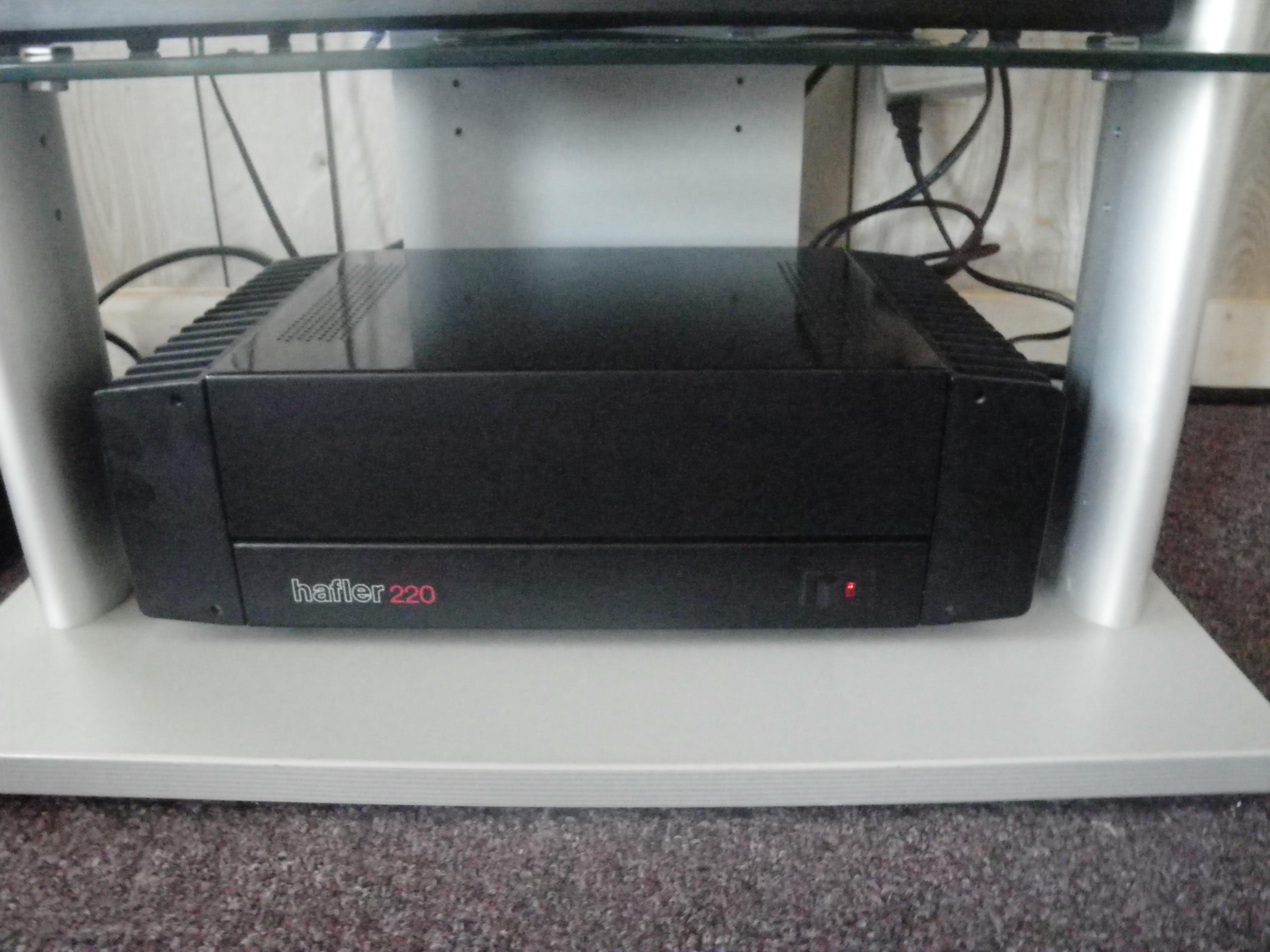

Hi! I have a DH220 that I modded! first I changed the PS caps to 1,8000uf Nippons .
Then I changed the electrolytic cap, there are 6 of them I put very high quality in place !
Next , I replaced the blue 2 blue film caps with Musical concepts ! New rca inputs , new power cord , and paint. Now wile the PS caps are so much better then stock and sound so much nicer , PS caps will loose of the high end freq. , so you can add some high quality bypass caps to them ! In return you will gain more upper end detail!
I set the bias high at around 310ma, I dont listen to my music laud ! If you do ? I would set it at around 275ma witch is stock!
My amp sound very smooth , and worm ! Im sure it will improve over time after burn inn! Total cost on mod ,98.bucks! Now the amp will have another 20 years !
