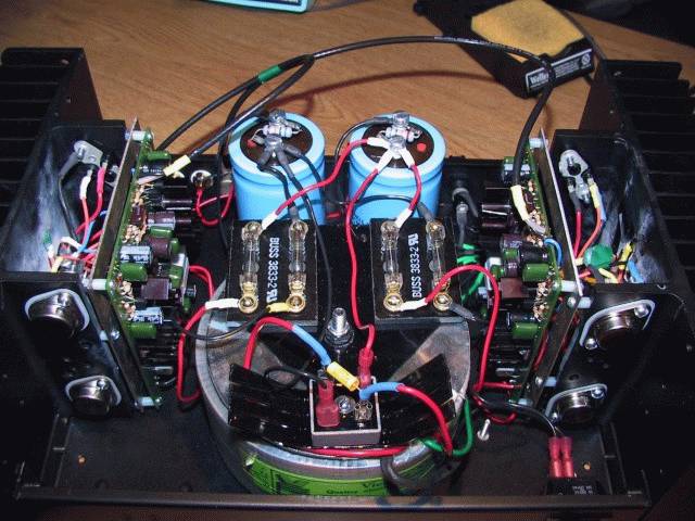

It is very easy to fit a leach amp in the DH200/220 chassis. I don't know how much better it would sound then a DH200.
My leach amp is in a new version of the dh-200 chassis. All I had to really do is make some metal brackets to adapt the 3-hole mounting to the 4 hole mounting that the leach amp boards use. The boards are only $25 for two from Dr. Leach. Of course, the sound quality probably can't even compare to the design that Mr. Pass has...
Brian
Brian

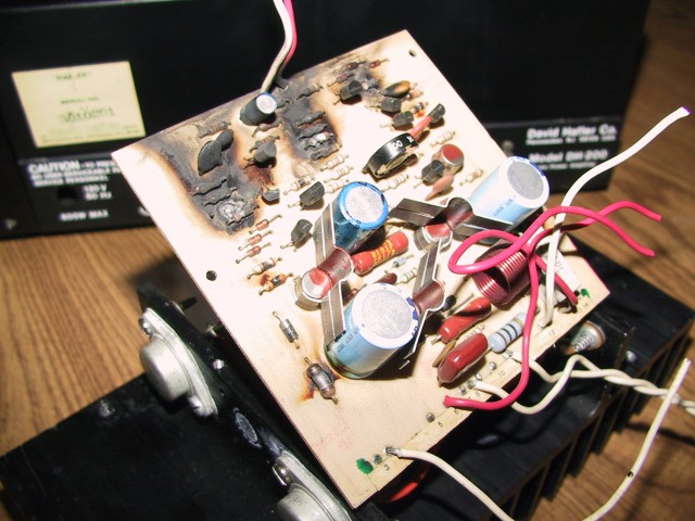

picture of the beautiful non-functional hafler channel:

BrianGT said:picture of the beautiful non-functional hafler channel:
Someone definitly let the smoke out of that one...
dave
Oooohhh Brain, that one definately lost all the magic smoke!
Looks like my very first amp many years ago that popped a tube

Looking at the bottom of the board, one of the traces is hanging off the leg of the component the failed, completely disconnected from the board...

A year ago, I rebuilt my venerable DH-220. Salient changes:
a. Musical Concepts PA-3B driver boards
b. Dual-secondary toroidal power transformer from Plitron via Musical Concepts
c. Separate IXYS FRED rectifier bridges for L and R channels
d. 48000uF power supply filtration per channel
e. "Step-start" relay+resistor to limit PS charging inrush current
f. New input jax, output binding posts, audio & PS wiring
I took pix of the mod process, especially the mounting of the FRED bridges, transformer, and big electrolytics, with the idea of eventually turning it all into some form of step-by-step guide. If there's significant interest in this from the communty, I'll write this up & post after the Holidays.
Howzit sound? Overall, improved clarity in mids and highs, equal to or just a hair ahead of my Odyssey Stratos Extremes. But a couple steps behind the Odysseys on low-end punch & impact. Even with speakers having efficiencies in the mid-90s.
I expect it to soldier on for another 20 years as the dining room system's amp.
