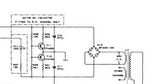

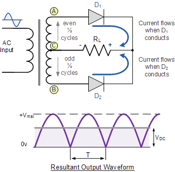

Here is another idea. Convert the power supply from a full wave BRIDGE to a simple full wave supply. This way instead of having + and - 60v you would only have about 60v. Then use the type circuite used in one of the Quad amps to make a + and - supply from one voltage. Use the first circuite to get the 60V dc then the last 1/2 of the next circuite to get the split supply voltages. Then we should be able to run the bias a whole lot higher.
Class A higher current
You mean a virtual ground for a power amp and using half de power capacity of the actual tranformer....
why not change the transformer to a smaller voltage with same power rating then...😉
Class A
Yes FAB, that's what I did. Worked out very well. I use it as a tweeter amp, running 17.5 VDC on each rail.
You mean a virtual ground for a power amp and using half de power capacity of the actual tranformer....why not change the transformer to a smaller voltage with same power rating then...😉
