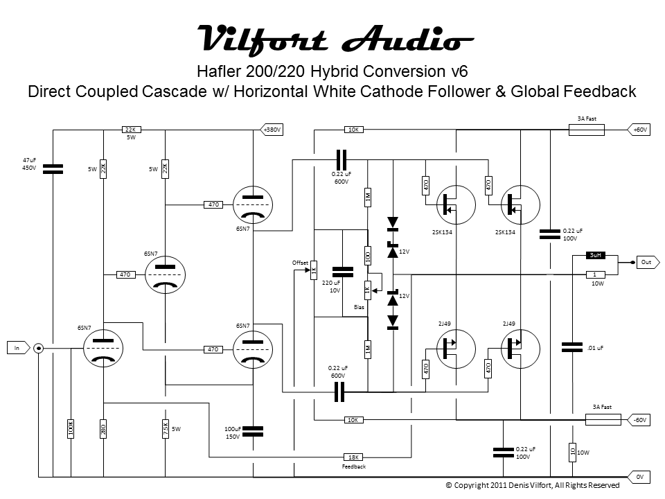

One more Hafler Tube Conversion
New Year - new schematics :D
Since last post, I have had fun restoring two MOSCODE 300s. Sounds great and has lots of bass slam. For those who know a little about these fun amps, you may remember that they are based on a cascaded 6DJ8 with a 6FQ7 as a white cathode follower driving the MOSFET outputs. The signal has to pass through 4 capacitors. So the idea struck me: why not re-design the cascade and white cathode follower to eliminate at least two capacitors that we did not need? - I still like to keep the two caps between the MOSFETs and the tube section. Sure, a direct coupled output stage could work, - I just do not trust that the tubes will not drift over time. Still, going from 4 caps to 2 seemed well worth it. This also means that one can splurge a bit on the quality of the caps (I went w/ Russian Teflon in glass).
The MOSCODE cascade VAS section yields a lot of amplification. Using to TubeCad and plugging in the 33K and 39K plate values, the compounded open loop amplification came out at ~ 200X. Wow! Also the plate resistors seemed excessively large which made the 6DJ8s operate mostly on the curved section of their gridlines. Great for max amplification - and more distortion... The MOSCODEs reflect some older design ideas popular in the 1980's - lots of amplification and lots of feedback. Great for damping factor and bass - not so good for an airy top end. So lower plate resistors was a design goal.
Speaking of airy top end; here the SE 300B amp w/ zero feedback is a better choice. No bass slam though. This hobby is always about giving something up to get something else. But could a compromise be reached? Could we get good sound-stage and bass slam with a hybrid amp? The earlier SRPP version of my Hafler conversion sounded great. And it had no feedback. Yet, the MOSCODE 300 had better bass...
Since I have a few Haflers sitting around, and I did not wanted to butcher stock MOSCODEs, it was time to build yet another conversion. This time the design goal was:
a) Bass slam - so feedback = yes
b) Clean/warm midrange - so 6SN7s w/ Allen Bradley carbon comp resistors
c) Smooth treble - so as few coupling caps as possible
After some trial and error (as usual), here is what version 6 looks like (see attached).
There is a couple of tricks here I have not come across elsewhere. As you can see from the schematic, the two first triodes look very straight forward: cascaded w/ direct coupling. Each delivering roughly 10X gain so this VAS has only 100X amplification - which in turn meant that we could get by with half the feedback of the MOSCODEs. The 22K plate resistors offer a better plate load to plate resistance ratio for less distortion. Here we have a 3X ratio whereas the MOSCODEs have 10X. Direct coupling also got rid of the first coupling cap. Then there was the coupling cap from the plate of the first triode to the grid of the second triode in the white cathode follower driver. This had to go. Inspired by Broskie and some of his posts on Aikido, it struck me that we really need the bottom triode in white cathode follower to act as an active resistor to the top triodes cathode follower. The white cathode follower normally take this signal from the plate of the top triode via a cap... but since we already had another triode to spare, why not a) lose the plate resistor on the cathode follower (ala Aikido) and b) drive the bottom triode directly with the same signal as the second stage in the cascade? Voila! Done. No more cap and efficient use of the 4 triode available. Simple is best.
I have never seen this configuration before, so I might have "invented" something new. Probably not...:eek: But if someone reading this post has seen this approach elsewhere, please post a link.
So how does it sound? Great (as all amp builders will say). Lots of bass slam and a bit more aggressive treble. Midrange - Especially lower midrange is there. It is still breaking in - so perhaps the treble will get sweeter.
If you chose to build this MOSCODE 300 inspired amp, set the BIAS for 300mA (like MOSCODE) and then set the DC offset to 10-20 mV on the output terminals. Also like MOSCODE, you can go AC on the heaters without problems. Just make sure the AC heater is tied to the -60 rail via a 100 ohm resistor so that heater to cathode voltage of the 6SN7s is not too great. This also keeps hum in check. Speaking of hum: use a star grounding scheme and terminate all ground leads between the power supply caps.
Happy 2011 :cool:
PS: I have posed a .PDF version of the schematic. That should be easier to read than the low res graphic.

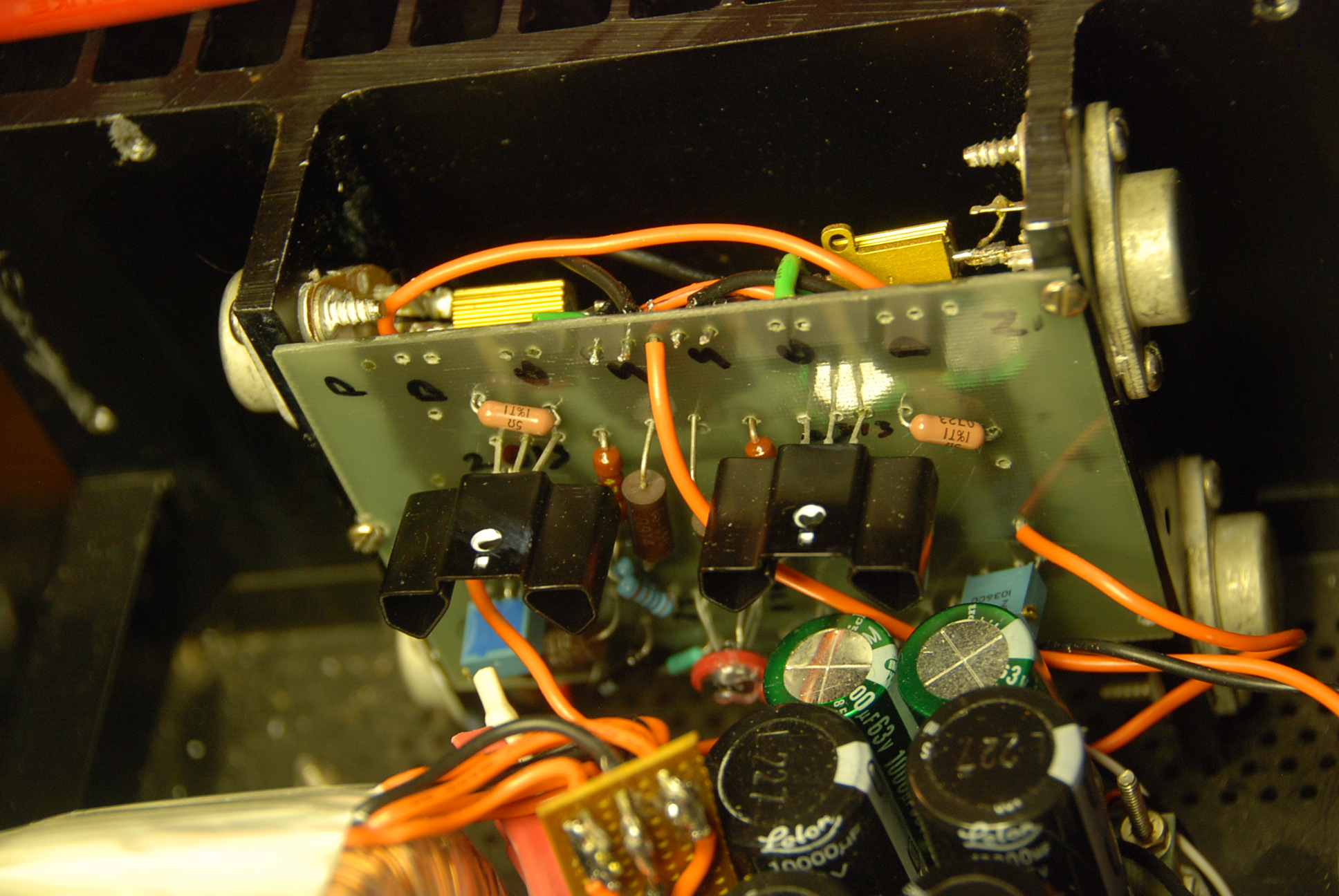

Juma's F5 meets Buzquito using a pair of k2013/j313
I started this Halfer DH200 rebuild on this thread, then found Juma’s thread:
http://www.diyaudio.com/forums/pass-labs/162042-f5-meets-buzquito-8.html , so I thought I would post my success’ here for future Hafler rebuilders.
Juma’s modification of Nelson Pass’ F5 has more gain and can drive the lateral MOSFETs of the Halfer with no problem. It also sounds great.
I made my boards the old fashion way, I drew the circuit with a marker and washed it in an acid bath.
Since the MOSFETs are off the board, I made solder connections for them. There has NOT been any smoke released thus far!
I have built this amp using all the parts in the original schematic (see first page of Juma's thread) with the exception of the output MOSFETS 2SK134/2SJ49 as comes in this unit and a +17-0--17 volt DC rail supply under load.
I was having trouble getting any current on the 2SK2013/2SJ313 and 2SK134/2SJ49. As it turned out there was not enough current with the k170/j74GR I used.
I switched to a pair of matched k170/j74BL at 7.16 idss and everything biased up just fine on the both channels.
After some testing I found an oscillation problem, so I inserted a polystyrene 470pF cap across each 150 ohm resistors, problem solved.
The bias is stable with the cover off, cover on it goes up and everything gets hot! I have the bias set at .4 amp per device with it warmed up, cover off, it sounds great! I will have to cut some larger cooling holes in the cover and bottom, although don't know if enough holes could be cut to make a difference. Juma offered that only .25 amp per device would be sufficient unless I am driving 4 ohms or lower due to the lower rail voltage I am using.
I am not using a preamp and I measured .040 vdc on the output of the right channel of my QB9 so at first I added input caps to both channels, then I noticed iTunes volume control is at minimum for background music and will blast into distortion at higher positions. I prefer to use only the top end of the digital volume for critical listening. So I found a pair of UTC A26 transformers; 30K / 500 ohms, primary and secondary have split windings. One of the transformers is open (damaged) on half the primary winding (7 & 9 pins). I measured a 1K sine wave at 3.7 volts on the good half and 1 volt on the secondary so I thought I would try it in front of this amp to reduce the gain and see what it sounded like, also wouldn’t have to use an input cap as the transformer blocks DC. I put a 4k7 ohm resistor across the secondary (500 ohm) and wired two interconnects in/out and gave it a go. The wires are about 2 feet long total.
It sounds pretty good. I can turn iTunes all the way up with no distortion and it is plenty loud enough.
I can switch back to using Audiruana (it doesn't have a volume control) or purchase Decibel ($33), it is better yet (has volume control too.)
I used a transformer with 6 secondary windings paralleled and a single bridge rectifier with 160,000 uF (with film by-pass caps). There is no hum or buzz coming from this amp or speakers (90 db/1w/1m). I did not use any smoothing resistors in the power supply, just two 3k/5w to ground per rail.
I am very happy with this mod. The sound is detailed with lots of air and plenty of bottom end.
