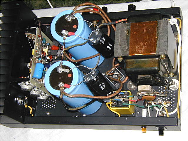

Can anyone help me source replacement filter caps for a Hafler?
They need to be the "low post" variety 2" X 4" and a max height of 4.25" with the screws in place.
Somewhere around 15K uF computer grade 75WVDC would be good.

You might try Digikey. I got two screw type computer grade 10,000 MFD for a Marantz power amp. What about the site that has the modified Hafler boards - I think you recommended it. I can't remember the name but can go back and find it if you need.

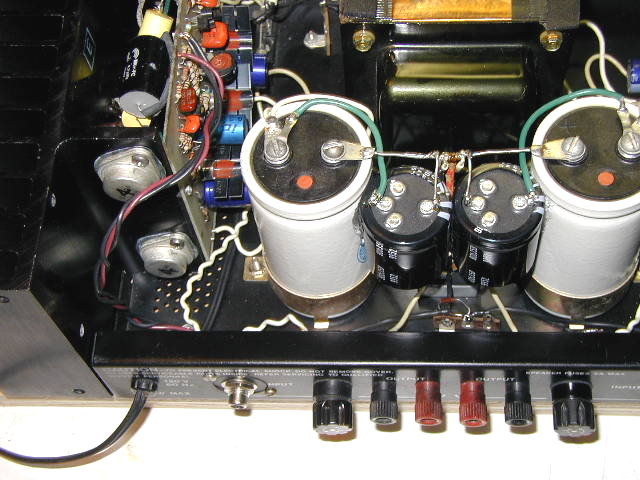

One thing that sounds almost as good is to add a 1000 uF electrolytic in parallel to the 10K caps. But, not very elegant and not for everybody:

Dick West said:I think there are caps at Mouser that are low post. I just can't seem to figure out how to search their web site. Very cumbersome and it seems keyed mostly to part number, which of course I don't have.
They don't send you their paper catalog? I find that for both Mouser and DK the search engines can lead you away from what you are looking for. With both companies the service is excellent -- the folks are really friendly as well. I almost always select US Postal Priority and the package will get here the next day.
Hi Dick,
I have a recent Mouser catalog, and found the following rough matches to what you need:
Mouser Part Number Brand uF WVDC Diameter Height Price
539-CGS123U075V4C Mallory 12000 75 2.0 4.125 $25.49
539-CGS153U075V5L Mallory 15000 75 2.0 5.625 $27.78

The only 15K uF I found is too tall.

Those Hitachi's MIGHT squeeze into a Hafler but you would have to take out the old brackets and drill holes for new brackets. Steve has the brackets for those Hitachi's. Also, if you are changing the caps in a P-230 you would have to make a new ground buss bar.

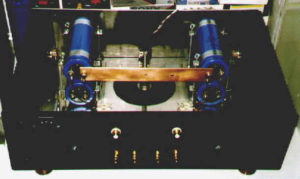

Stormrider said:you would have to make a new ground buss bar.
Home Depot has ground buss braid -- all sorts of good copper things which go on the mains.
You can mount four 2-1/2" diameter electrolytics on the top cover sticking out the back. The clamps can go on the inside making it look clean.
If you go above 30,000µF per rail I suggest an inrush current limiter.

The first things you will notice about putting each channel in its separate chassis and with its separate power supply is an increase in the size of the sound stage. It will be wider and with more depth and resolution of small detail. Without cross modulation between channels each can more accurately reproduce the signal. Dual mono power supplies is absolutely worth the effort and cost, especially if you have the hardware handy to do so.
For my mono blocks I moved each transformer over to the right side to better balance the weight and keep all AC as far away as possible from the signal bearing components. Then, as you can see, there is more room for larger caps.
In the picture attached you can see the pair of blue 40K uF caps. The yellow device is a 120VAC time delay relay that allows for a time delay start. Without it the 80k uF in the PS would fry some fuses, diode bridge, etc.
An end cap can be made easily from a piece of something like galvaneel (sp) available from a sheet metal shop and they will cut it to size. If you lay out the plans for it you can have the shop include a right angle blend in front to attach a face plate. On my end caps I mounted a nice handle to assist in moving the mono amps.
When I get some shorter caps I will mount them and then be able to put the lids on the amps. In the meantime please note I have no cats or toddlers with little fingers so the open chassis is not too dangerous.
The picture is from 4 years ago when I had a pair of DH-220 circuit cards mounted-- and the sound was really great. Currently I have a pair of DH-200 cards mounted and the sound, again, is really great!
