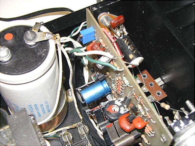

One of the most common problems with the vintage DH-200 amps is that the first 4 transistors (in the input differential amplifier section) have drifted out of spec. These transistors must be matched on hFe or you will get DC offset. You can't just replace parts, the transistors must be matched. Do you have a meter that can measure hFE? If so you might get 20 or so of each of the NPN and PNP transistors, measure them, and get some matched pairs.
The DH-220 has a small circuit that includes a variable resistor to null DC offset. The DH-200 does not.
Yeah, getting matched pairs is a daunting task. Here is a simpler solution that may work for you as it has for me a couple of times in the past:
In The Audio Amateur 1/83 p. 55-56 Erno Borbely suggested to hang a 100K pot between the card's power supply rails and take the output of its wiper, via a 1 meg resistor, to the circuit end of R3.
I did this with a 1/2 watt multi turn cermet 100K variable resistor and used a metal film 1 meg resistor to R3. So, it would seem that injecting a small amount of either the + or - voltage to the amp's input at R3 is the solution. Furthermore, a small film cap across the ±60VDC attachments to the variable resistor will help reduce noise.
If you study the DH-220 schematic you can see the similarity to the above suggestion.
Here is how I attached these extra components to a DH-200 PCB.
You can see the small blue variable resistor attached to the upper left hand corner of the PCB. I drilled tiny holes for its mounting pins and on the back side of the PCB ran a wire from one rail to one pin and jumpered the other pin the rail on that side. From the wiper I soldered the 1 meg resistor and attached it to the circuit end of R3.
Insulating shrink tubing was used as needed.
This circuit has tamed as much as 300 mV DC offset. When the circuit is turned on the DC offset does swing a lot until the circuit warms up and stabilizes. The amount of swing is probably because of the lack of matching of components but the 3 piece circuit above can bring the DC offset voltage down to almost zero as the variable resistor is adjusted.
