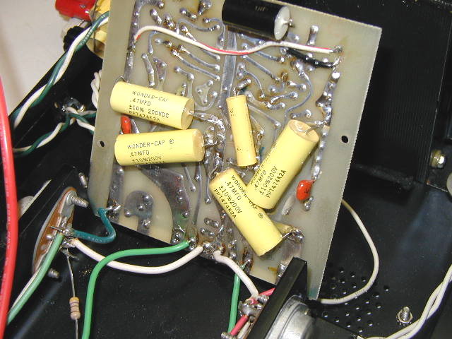

"For example, your diagnosis of C5 being the cause of no gain was wrong."
That was me, not Chris.
I mentioned C5 as most technicians miss it, and it does cause loss of gain.
C1 causes loss of input signal, not the same thing, and most technicians check it early on in the repair process.
You are correct. Sorry I mixed up comments from various messages. I used to do a lot of mods to Haflers 15-20 years ago but since acquiring an MC modded hafler with the PA-3C circuit cards I have quite messing with Haflers and with mods. I backed into sleuthing out a problem in this dumpster diving acquisition and had to refresh my memory on lots of aspects of the DH-200 circuit.
Comments from you and others helped a lot. Hopefully, I am now mostly through with messing with this amp. I really hate working on the DH-200 as it is so difficult to do anything with the back panel items because of the shape of the chassis.

Hi Dick,
I agree with djk on the C5 call as I've run into so many instances where it's bad. Also C1, but that isn't as often. I would think you would check those due to your high amount of experience with these. So I'm just a guilty as djk here, silently agreeing.
I understand your approach. Somehow you got yourself behind the eight ball on this repair. I hope your customer understands the effort you are putting in.
Hi djk,
-Chris
Hi djk,
Not possible to disagree with you!I mentioned C5 as most technicians miss it, and it does cause loss of gain.
-Chris

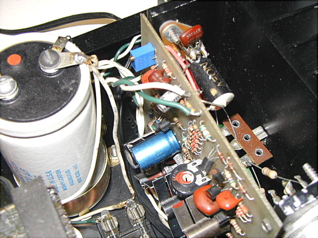

DICK WEST,HAFLER OFFSET
HI Dick, had to laugh at this offset question, wanted to say 60mv THAT LOW, I've
had some much higher than that, as you now probably surmise, one trick that is always worth a try is to swap over the SAME I/P pairs 5551 with 5551 and 5401
with 5401 I/P side to Feedback side, sometimes this reduces the offset sometimes
makes it worse the suggestion of using a trimmer from the rails to the I/P pairs
is a good idea BUT the arrangement does need to be decoupled to stop power supply
variations getting into the I/P this will BE a small amount of + feedback otherwise,
have a look at the Hafler 220 arrangement, which uses a floating feed from the CCS
via a couple of 1n4148 diodes to swing the offset a small amount, Its main advantage is that the setting is less twitchy with more movement of the 1k setting
resistor, this is because the total voltage swing is just +,- 0.6 volts whereas a pot from the rails will be +,- 62volts
regards
regards
Anatech verses diff pairs
Tut Tut my boy ,don't you think matching these I/P pairs has been tried?
I have wrestled with this anomally many times having bought many many
transisters of all the types used on the board and even when absolutely matched, you can still get an offset, sometimes unreasonably high I have even matched
the diodes in the CCS, sometimes when the matching is less good [within a beta
of 5 to 10] the offset is better, the only thing you learn from this exercise are new
swearwords, the only conclusion I came to was that because the predrivers often
had a very low gain, they PULLED the I/P diff pairs unevenly, and that these 3440,
and 5415 needed to be gain tested at say 10M/A in any event, as has already been suggested a simple balancing circuit will do the job, I have no doubt that HAFLER
underwent similar frustration with this problem hence the adjustment circuit used in the later 220 model {ANY suggestions from SLOWHANDS?}
The acceptable limit for offset is set at 50mv for the HI FI spec, fully symmetrical
designs always need more care generally to get lower offsets,It did not seem to compromise the performance of the Hafler even when the offset exceeded this 50mv
value so no point in worrying, just be happy that you have a UNIQUE amplifier,

Check out my post #441. You can see the picture I posted of the arrangement. In the upper left hand corner of the PCB you can see the blue small multi-turn 100K pot, the wiper of which feeds R3 through a 2 meg resistor, and across the pot is a small film cap (on the back side of the PCB to help reduce any "noise" that might be riding on the supply rails.
This arrangement is not overly sensitive and a few turns can be used without making a huge difference in the offset. I don't have a signal generator or scope so can't tell about any noise it might introduce but it makes no difference in the sound, as far as I can tell.
It is a lot simpler and cheaper and faster than matching and installing several small transistors. I have done this in the past only to find the DC offset persisted. I am not motivated to throw a lot of parts into these old amps so my "fix" is suitable on a cost-benefit ratio.
Hafler included DC offset adjustment on the DH-220, partly because it was needed and partly because it helped reduce parts cost and time to match components in a production setting, plus it was a good sales feature.
For several years I used a dual mono DH-200 with polyprop caps tacked on all over the PCB. It made a good sounding amp. But, the Musical Concepts PA-3B beat the pants of anything I had around and it was a lot simpler to use.
Here is the extreme amateur mods can go to:
Here is an amp with extra smaller electrolytics bypassing main caps and with polyprop bypasses on each channel placed behind the PCB. The pair of 100 uF on each PCB were replaced with some Panasonic 220 uF caps.
These things make the amp sound a little different and, of course, I think a little better.
